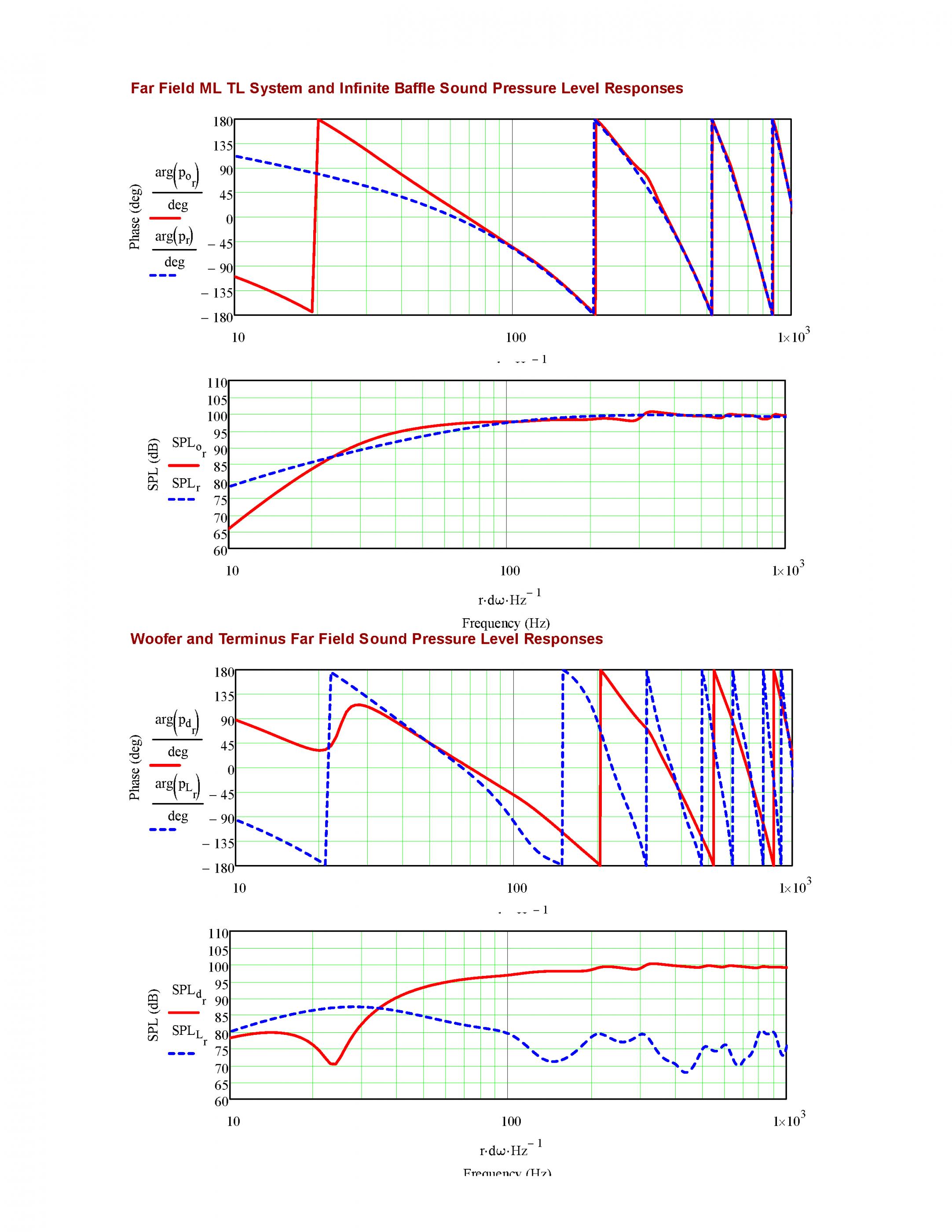

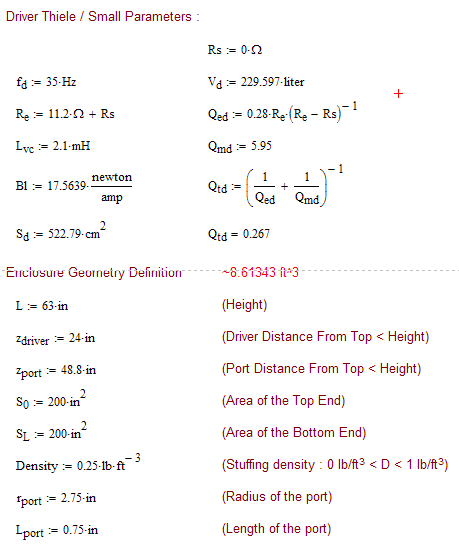

OK, so driver and vent location is off by a minor amount due to increased height, smaller CSA/net Vb, ergo tuning with the specified vent tunes it a little higher as shown in a sim.
Note that the driver’s Sd/eff. dia. per Altec is 507.529 cm^2/254.2 cm, so simmed SPL is a little high.
To get BL, I calculated it and found a minor discrepancy between Mms, Cms, Vas, so changed Vas to match: 229.597 L.
Le is an average of several measured ones.

Yes, I considered room modes, but with driver Fs at ~35 Hz and tuning around Fs, there would normally still be an obvious null in the driver's response and a peak in the vent's when measured separately, yet it's the opposite, so for now I'm sticking with an air leak.

We are on same page as far as inputs into MJK's worksheet is concerned. I see that the favourite culprit is leakage.

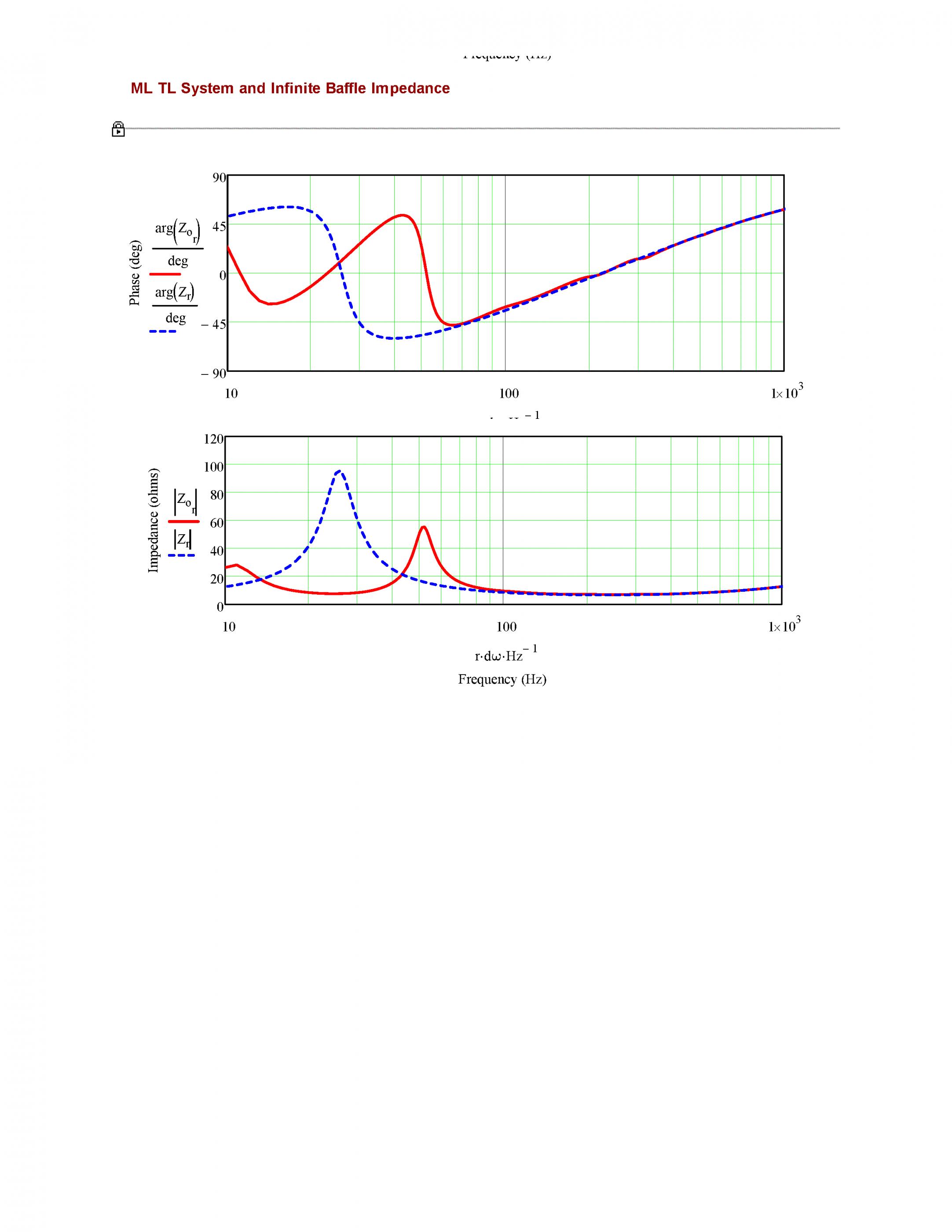

Checked around the cabinet no leakage paths as far as i can see - caulked the lid down to make sure - no change in the FR traces.
Carried out a electrical measurement of the driver in the cabinet. Sorry for the crude approach only had a signal generator and a multimeter to hand. It does not give the trace i was expecting - no twin peaks either side of Fs - so not working as a BR as far as i can see.
Not sure where or what to do next ?
I am unclear if its the driver not being as measured or something else. I have some Supravox 285gmf's i could try in the cabinet to see if the sim for their parameters.

Checked around the port - pushed the stuffing away from the opening, no real affect. Attached 2 more traces, the first with the free driver impedance overlayed. In the second one i started the measurement from 10hz, this highlights the second peak maybe around 20hz?
Just in case you are confused the second trace is phase.

In playing with the MJK sheets, I could often get a response like this using a really large high aspect ratio vent. I have not seen the official drawing of your schematic. What are the complete details of the enclosure? Ts parameters of your driver. Also seems to happen when the taper of the enclosure is tapering heavily towards output/port.
OK, now I'm seeing what I expect to see except that it's damped enough to shift tuning down more than expected with a below Fs tuning, so you may want to experiment with less internal damping, which will make it not quite so 'dry' sounding.
For sure, no air leaks unless the damping material is covering them up real well.

IT looks very similar to impedance plot of box for aLtec 416 based on similar box sixe folded over. If I lengthen vent, it pushes first hump lower in frequency and raises second. As you reverse this activity, the humps begin to equalize out. As GM stated, stuffing is another way to dampen the first impednace hump.
Measurements made using soundcard.
The cabinet is made as you described with a central baffle to make the fold. 63" long straight line 11" deep ~18.3" wide with the driver and post as instructed. The only thing which has crossed my mind is that to allow me to fine tune the port i router a slot ~ 8" wide x 12" long with curved ends onto which i attached a plate with the port in it, on the outside of the cabinet - could it be acting like a 2 stage chamber. Will attach plate on the inside of cabinet tommorrow evening and remeasure if its felt that this could be the culprit.
