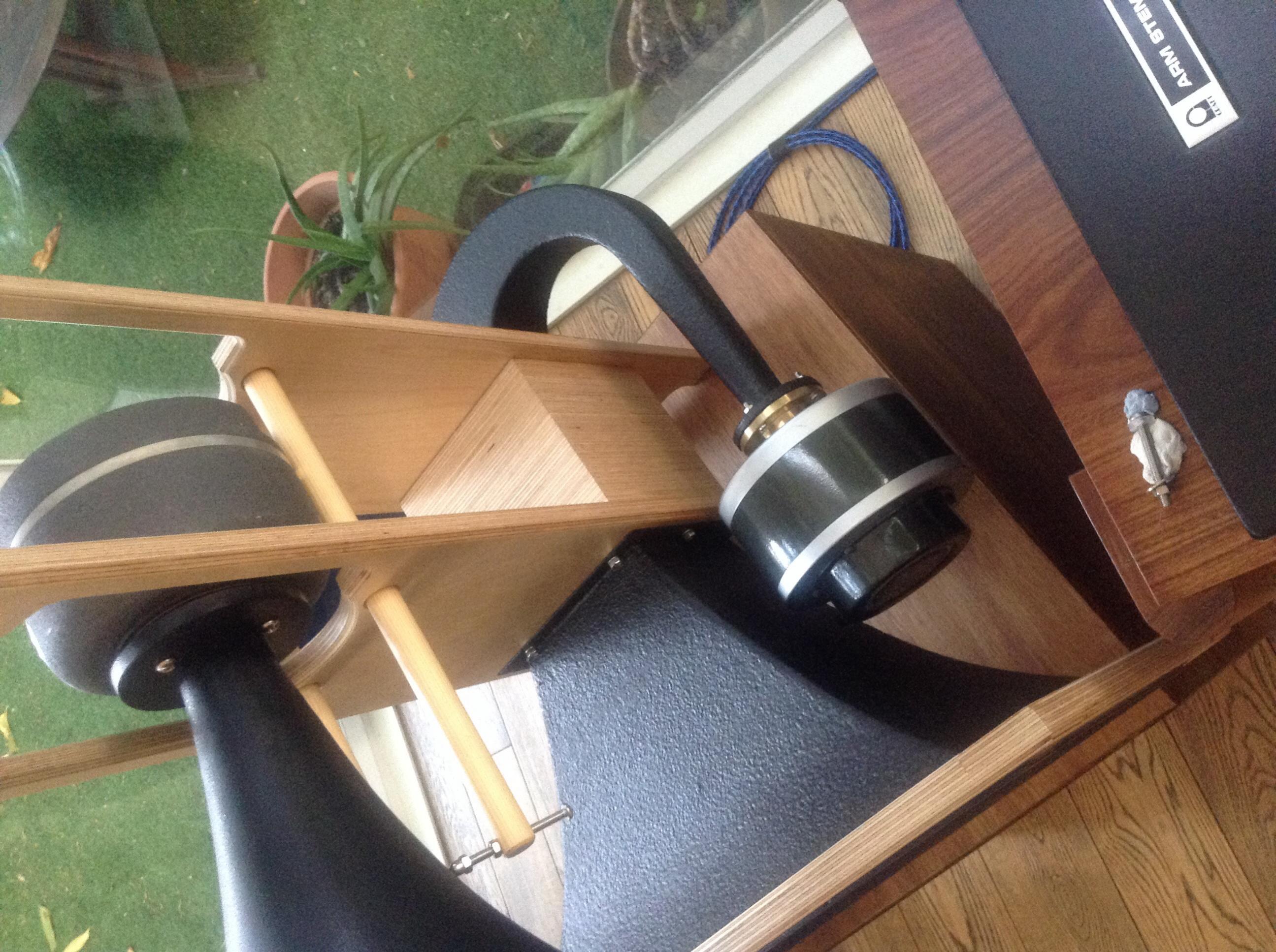

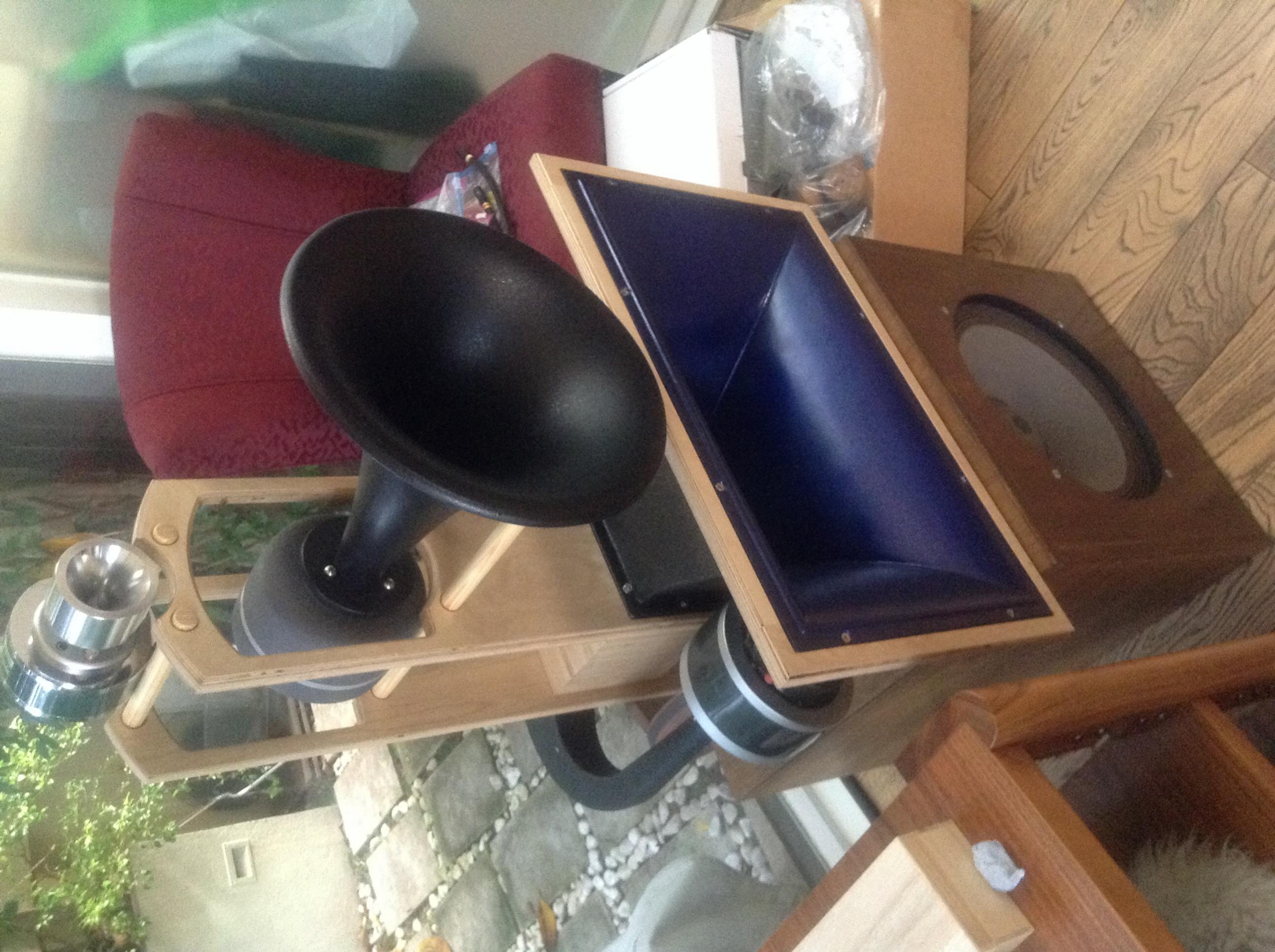

NB: on the subject of boxes, for the 414a/z I've had mine in sealed boxes (c.55 litres net) for about 4 years now. This was in part due to the fact that I couldn't persuade my wife that bigger boxes would be better, and in part because after a lot of thinking/modelling (including front loaded horns), this was a reasonable compromise. I have to admit though, that due to the reconing, my measured T/S parameters are a bit different from what I've found on the internet. (Or maybe I wasn't measuring properly!) I run horns above (JBL 2420 into Stereolab 400hz spherical horns, with little Goto tweeters kicking in above 10khz - an impulse buy, and not convinced they're necessary), but I've now got some old YL mid drivers into YL MB-150 horns and will add these in probably c.350hz to 1-1.25khz (once I've got my crossover sorted). So, the 414a will be running c.60-350hz (which I know is a bit of a waste of their mid abilities, but ...

Would love to see your setup. I have seen those YL acoustic drivers, I am interested to hear your impression on them.

3GGG - here you go. There's still some work to do though. The horns were in fairly bad shape, and so I stripped them back and restarted them, with underbody on the outside to try to damp them down. I also replaced the 90 deg bend with my own straight section (hand cut in sheets of ply).
