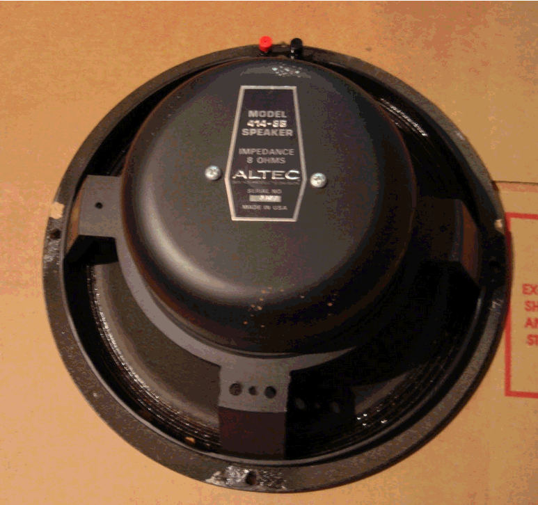

Recently I had an opportunity to measure 414z vs 414-16b in the same enclosure- the freq. response and sensitivity were pretty much the same. Also, the magnet structure was same on the both drivers, just the baskets were different.
The magnets look the same to me - as stated only basket is different.Yeah, the B's should only be a little more efficient due to having iron pots over the magnets.
Looks like i will be going back to only one driver per cabinet - one of the 414b's is defective - it is rubbing and it feels really stiff. The guy hwo sold me the drivers has been very appologetic, looks like may be able to claim on postal insurance. He has offered a couple of recone kits at a very good price - i am just clarifying whether these are GPA ones or generics. My current opinion is that a recone is never going to come close to my existing 414z's and would have to recone all 4 if i was going to get anywhere near matched.
??? 414B with, without magnet pot, though the frame is the same, so wondering what ya'll have.
GM
Mine was from the picture on the right which was the same magnet assembly as 414z that I have.
