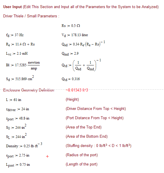

Long time doing other things, starting to look at the cabinets again. Managed to get the fs down to 35hz by cleaning the surrounds with some MEK (well really redistributing it). Started looking at the MLTL cabinet again for these drivers. Managed to find my account details for MJK's site and software so was going to try replicating GM's simulation in Mathcad, unfortunately my student version of mathcad doesn't seem to load anymore, and don't feel like paying out again for it.
Reason i wanted to simulate it isn't i wanted to second guess GM but was looking at making the cabinet a little taller @ 36" ( better for the TPL) and was going to attempt to work out what i needed to change. I was going to keep Vb the same and adjust the CSA down accordingy for the extra 4" of height.

OK, to recap to make sure we’re on the same ‘page’ before making any changes:
Posted ~32 Hz Fb sim’s details. Driver specs is an average of many measured + factory published specs, so may, may not be ‘ideal’ for every driver/app as simmed, i.e. strictly a starting point, but the cab should be acoustically large enough to match it to any factory [re]cone driver even when driven with a high output impedance except possibly those with AlNiCo motors that either needs to be drained/remagnetized or was done and for whatever reason didn’t take a full charge.

Got mathcad working - using model TL_ML_Corner_8_14. I get very similar simulations of the SPL trace to what GM posted for the 5.5" port. Can see that Qtd dominates the response putting in the values for the driver i measured does not seem to change the response much - which suggests a robust point in the design curve. What other things other than the SPL trace should i look at whilst i am having a play, looking at port sizes locations etc.
