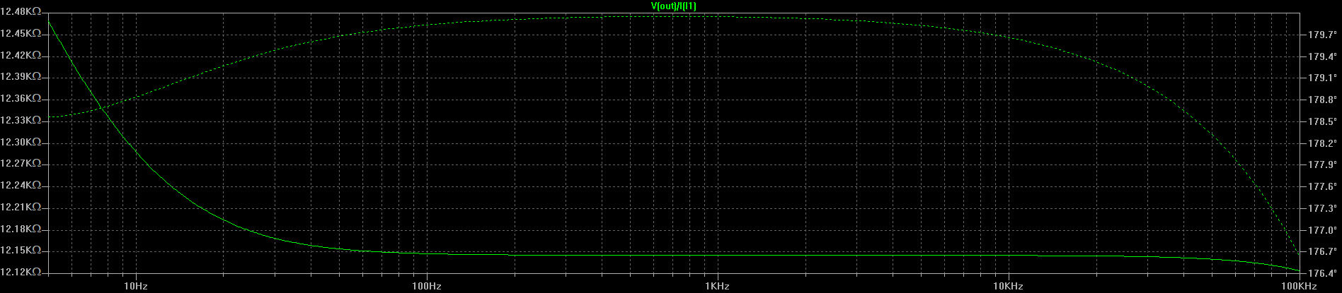

Just re. the pentode driver stage (output impedance, etc.) from the article as food for thought:
"In many ways this Amplifier could be called the "ultimate" WECO 91. While investigating the old WECO design I noticed many things, but one thing that stood out was simply how much lower the distortion from a correctly designed penthode driverstage is. The drawback is that in the old WECO design the very high output impedance of the Driverstage causes HF rolloff and poor delivery. In the Legacy the WE310 driver valve is replaced with a much meatier EL84 (or indeed as I did later with a Siemens C3m). This allows a output impedance of the driverstage that is by the factor ten lower than in the original WECO design and that can deliver more than eight times the current.
The driverstage with around 16mA operating current provides enough current to avoid slewing into the 300B grid for over 500kHz Bandwidth and is in conjunction with the output impedance and the 300B input capacitance naturally limited to 190kHz, so the driverstage will under NO conditions run into slewing. The not inconsiderable grid current of the 300B on peaks can also be accommodated, allowing better power delivery. Essentially, the Driverstage on this Amplifier is not the limiting factor both with regards to bandwidth and linearity.

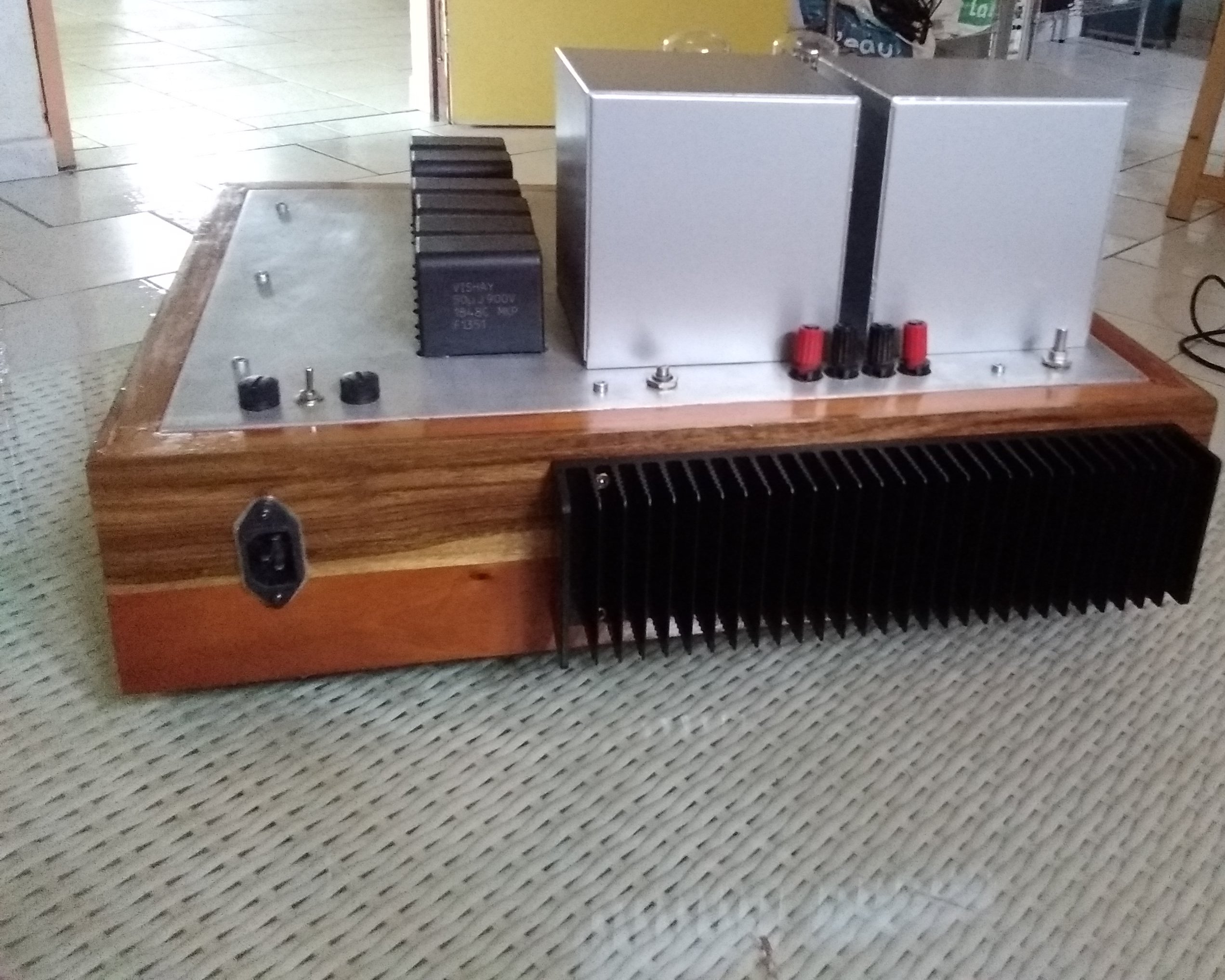

I made a 300b amplifier with triode C3g last year. For good swing and low distortion 24 k plate load is good.
For PSU regulate SIC MOS is better than 6AS7, very low out impedance and no hum.
