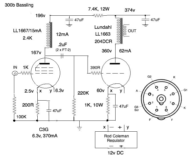

So after taking all the advice on this thread, and the very generous help of Andy Evans I now have this as Amp and PSU. I have moved away from a C3m and am now using a C3g. It is a much simpler layout than EBAs, and I wanted to ask for comments on this simpler triode driver approach before I built it.
Thank you so much for all your help and support so far.

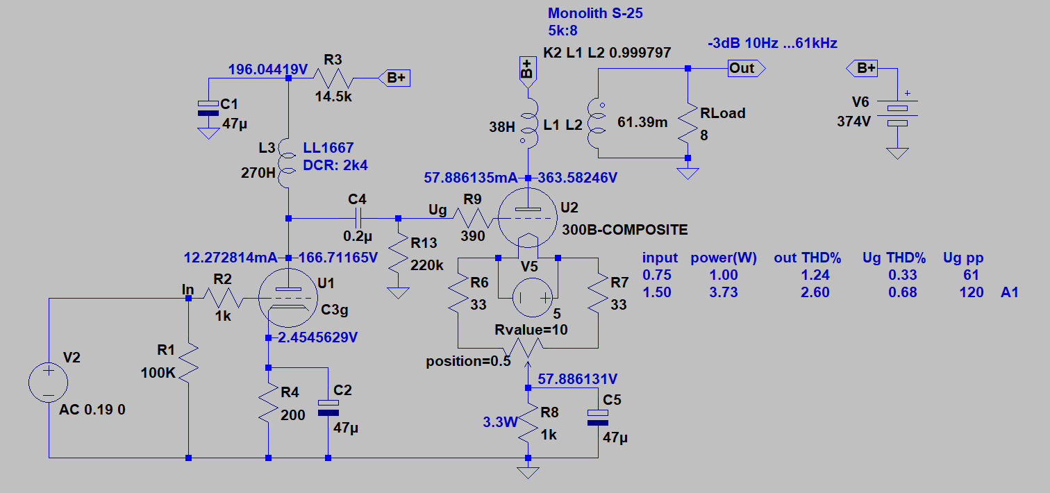

Euro21...you are correct in your simulation. But 3.7 watt can be enough for someone who has sensitive speakers and low volume listening habit. No?
For my 2xmono 300b se B+ is 378 volt, cathode sits at 64 volt against 1270r resistor and that is plenty loud for my taste.
Regards
Bassling....since you already got your PT please go ahead and build it with GZ34. Afterwards, if you find you need more power you may change the PT not a big problem other than $$. By the way what speakers will be driven by this amp? Please note to increase power by three db you need to double wattage.
Regards
Euro21...thank you. Yes this is a valid question why use 300b for 2A3 power level. For me the above biasing gives me right mellow tone which greatly satisfies my listening taste. I tried 2A3 se but I prefer 300b for this duty.
