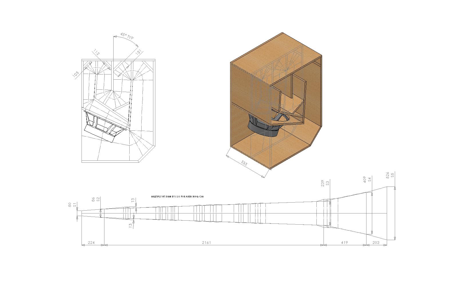

I agree with all of that. Bye the way the driver is on a flat board, and rear access, and lots of bracing makes a lot of sense here. This is just an elaborate doodle to give epa another idea of how he could build a symmetrical TH. I still cannot get over the power handling capability of modern drivers, just incredible.

in my sym @ 1000 watts excursion is 14mm @1800 watt is 20 mm@ 3600 watt is 28 mm(sine waves)

Hi Erik,
It is definitely the best 18” PA driver on the market in my opinion. Just wondering why they can’t deliver before august. Probably one of the big companies bought the first line.
About the Xmax, you forgot to involve the pwr comp figures. Also single sine waves are easier to generate for a driver than (complex) music signals. If the 9600c is put in a basreflex cab with Fb above the Fs of the driver, at Xmax it is suffering from at least 2.2dB (2.2dB = 1.66 x pwr).
1.8kW x 1.66 = 2.988 kW
That means more then 1kW is generated into heat besides the normal heat that is generated by the driver. Maybe that gives an idea about temps.
If you want to drive that loudspeaker to the max (Xvar = 50%BL), which is about 18mm, it suffers from about 4.4dB power compression (= 2.77 x pwr)
3.6kW x 2.77 = 10kW
That’s why the 9600c is a good balanced driver. You see that the AES power ratings and peak power are corresponding with the excursion. Even the 10kW peaks fall within the safe excursion limits.
Now back to your design. Your stated 1000W results in 14mm excursion (which is Xmax) in your design. This means your compression room forces the driver to reach the Xmax with less power (56% of 1.8kW) so that means more or less the driver suffers from 2.2dB x 0.56 = 1.23dB pwr comp.
1kW x 1.33 = 1330Watt
But there is more to the story. The thermal power compression may be lower but the driver still faces the same dynamic compression figures (which are coupled to the mechanics of the system). That means the 1.33dB pwr comp figure from earlier is on the low side. Probably it will be more in the direction of 1.8dB. In that case I expect you will need about 1500 watts to reach Xmax in your design.
So, that is 500Watts that is directly transformed into heat + the normal heat of the of the driver. Under normal circumstances this driver can easily cope with such temperatures but since the driver is covered by the compression room there is almost no airflow possible. If you are going to feed it +/- 3kW to reach Xvar you might end in the danger zone of frying the driver.
The 9600c is an NEO magnet driver and NEO magnets don’t like very hot temperatures. In the first 9000 series the fan was an option. Trough better heat dissipation technologies (better airflow within the motor) 18Sound says it is not longer needed . But you can imagine if you put that driver in an almost closed and small volume environment this danger zone will be reached much earlier. Therefore I strongly advice you to mount the driver reversed and deal with the changes you need to make.

Hi Martin,
The blue corner bracing can help with the first 180degree corner to optimise the pressure. More important, they will have a positive effect on the top panel to prevent panel-flex, so I would use them.
The 'hollow' part in the middle should have at least one bracing in the middle, preferable 2 positioned at 1/3 of the sidewalls (and of course fill those empty spaces up). The bracing in red can be bigger (if you cut out holes) but these are the places I would suggest as minimum.
Hi
I have sketched out the extra corner pieces to optimise the sizes for anyone who is interested in adding them. The rest of the dimensions are as posted in post 253 . This effecively shortens the path by a small amount, but makes the expansion a bit smoother. The biggest descrepancy is now adjacent to the driver, tapering from s2 to the first corner - Hi-lited as 2 X 13mm dims.
This could be packed, but I dont think it is worth messing with🙂
Regards
Martin
