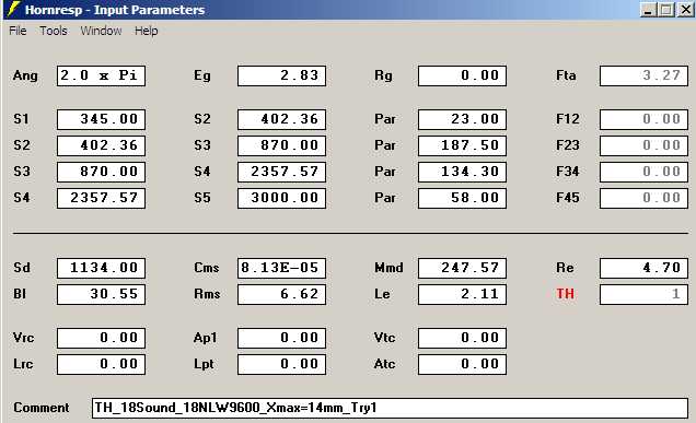

a freind is going to purchase some 18 sound drivers as replacement in some eaw SB850.
we haven't decided , if we buy the cheaper 18lw 2400 or the 18nlw9600(c)
when he puchased them,i'm gone bild a test box like that to see if this works(and for fun)
the design needs some fine tuning
its modeled the "cubo" way
why do you think it doesnt work(wel)?

Whe have made the dission to go for the 18 Sound 18NLW9600. The carbon version is not available before the end of august. I just dont think the 18LW2400 is good enough for the job. ( Whe want inprove, not just replace ) Im still not shure if whe will do them one by one or a compleet set at once. I'll keep u posted on the status.

And this is based on what, information from RSL in Breda?I just dont think the 18LW2400 is good enough for the job. ( Whe want inprove, not just replace )
Saturation is maybe not the best word but if the pressure in your first compartment becomes to high the mass of the air drops which results in less efficiency.im not sure what you mean by"saturation effect" does the heat dissapation would'nt be the same as in a br box? already worked on the same model with the speaker reversed . the tc volume wil be less,and you gain a bit in s4
As far as heat, during the eighties a lot of research has been done (and published) by David Carlson and David Gunnes from Electro Voice. In manifolds the cooling was about 20% to 30% better when the drivers were flipped around. The heat dissipation in your design is definitely not the same as in a basreflex. Sound pressure is not the same as airflow.

Hi epa,
You are increasing the thermal resistance in the cooling path for the driver quite strongly by mounting the driver inside a relatively small box. On the positive side, this should be very easy to measure in a box like yours where you can install the driver both ways.

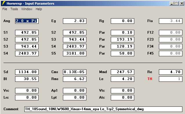

Symmetrical layout
Hi epa,
Here is a second try work product of a symmetrical layout with the 18NLW9600. First I made the drawing from a Hornresp simulation, then I took the attached Hornresp input from the drawing, both can be improved.
Just food for thought, as always, the devil would be in the details.

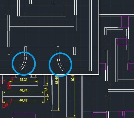

depending on how many pieces you make them,it doesnt make much difference,just be careful to not restrict the hornpath .And how might it sound (or model in hornresp) if the pieces (I've circled) are straight angles instead of curved?
fi. if you make the bend 2 straight pieces it wil work fine.
Oliver, I have some suggestion for your drawing. Because of the deep position of the driver it is maybe more comfortable to make the driver mountable from the back. Also an extra sheet on the back is no luxury in case 18NLW9600c is used.
For easy outlining the first section of the horn I would choose parallel/symmetric panelling. It doesn't change the response but it is more easy to line out and the driver will fit better on a straight sheet
The circles on the left side of the driver are an example of 'broom sticks" style bracing for the mouth which it definitely needs for the power of this driver. The 18NLW9600C needs more then 3,5kW to get near Xmax so that gives an idea what kind of pressure and heat this driver can produce.

Hi Djim
I agree with all of that. Bye the way the driver is on a flat board, and rear access, and lots of bracing makes a lot of sense here. This is just an elaborate doodle to give epa another idea of how he could build a symmetrical TH. I still cannot get over the power handling capability of modern drivers, just incredible.
