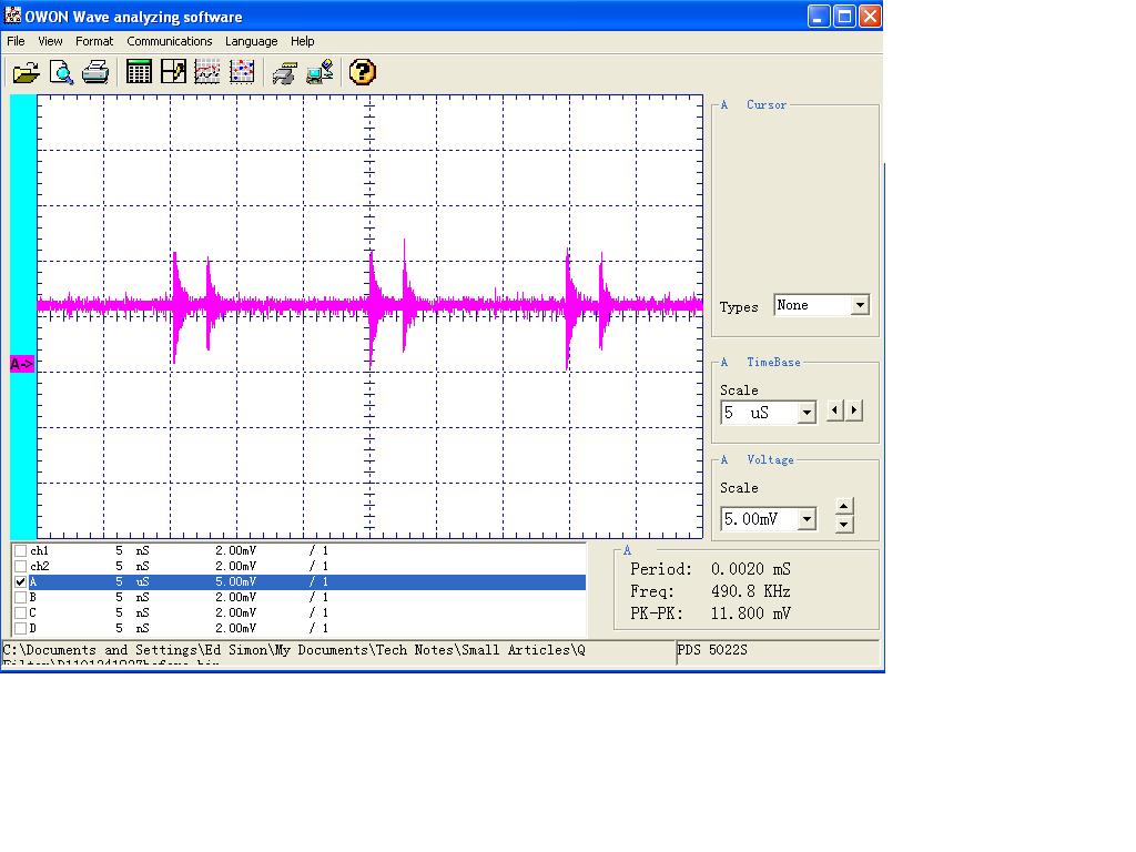

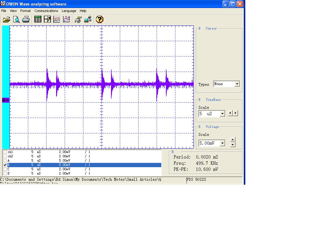

Sy,
I decided to build my own "Quantum Purifier". It has about 25 nanohenries of inductance, 25 picofards of capacitance to ground the way I hooked it up. The resistance is about .003 ohms.
I used a #82 light bulb fed from a 9 volt battery through a 10 ohm resistor and a small ferrite core inductor to form a noise source. The DC is blocked by a .001uf film capacitor. I used my standard oscilloscope probe to look at the input to the "Purifier" and the output. Loading was only by my x1 scope probe.
The input is on the left and the output on the right. Not a big change but a measurable one! About a 10% reduction in noise!
Yes, the device and data are real! The gizmo can be described by circuit theory to a small extent. Took less than an hour to build and measure. No hard to get components. Also I believe the attenuation is scalable so larger devices should be more effective.
