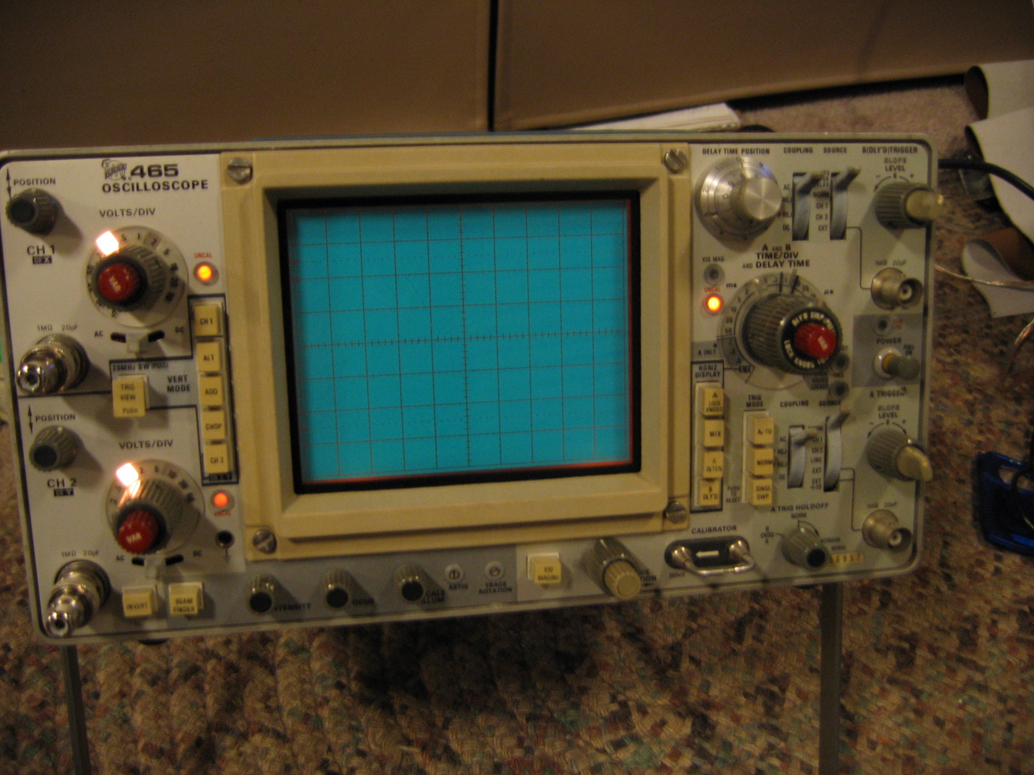

I have a Tech 465,but I dont have many scope skills,can you tell how to hook it up and what buttons to push?All the tubes have two glowing dots on the top side.Thanks for the responces...... Robert

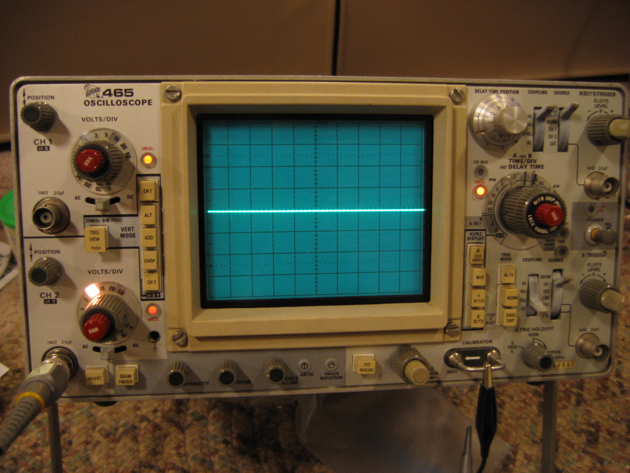

Push the Ch2 button in. All others in that column should be out.
The trig. view should be out.
Center the trace.
Set the ch2 vertical amp to 5v/div (one click clockwise).
Set the probe to 10x.
Clip the probe connected to the ch2 input to the calibration bar on the front of the scope.
Set the red knob in the middle of the ch2 vertical amp control to the fully clockwise position.
Adjust the trigger level until you get a locked waveform displayed.
Post a photo of this setup.

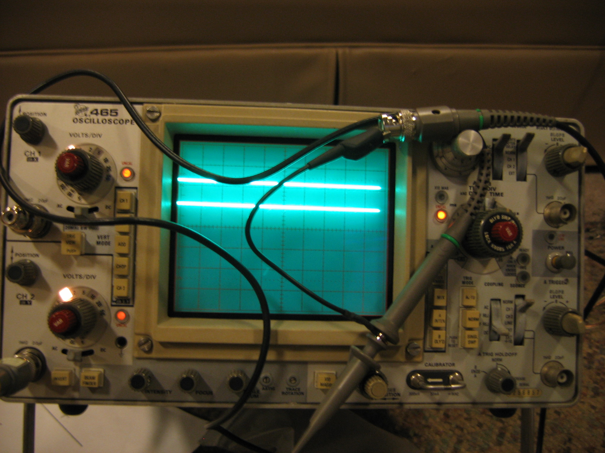

If that alligator clip is connected to the probe, it's shorting the cal signal to ground. Only connect the tip of the probe.
That's 50v/div. You don't have probes with the pin that tells the scope that you have 10x probes. You'll use the other scale.
If you're going to use the lighted scale, set it to 0.5v/div.
