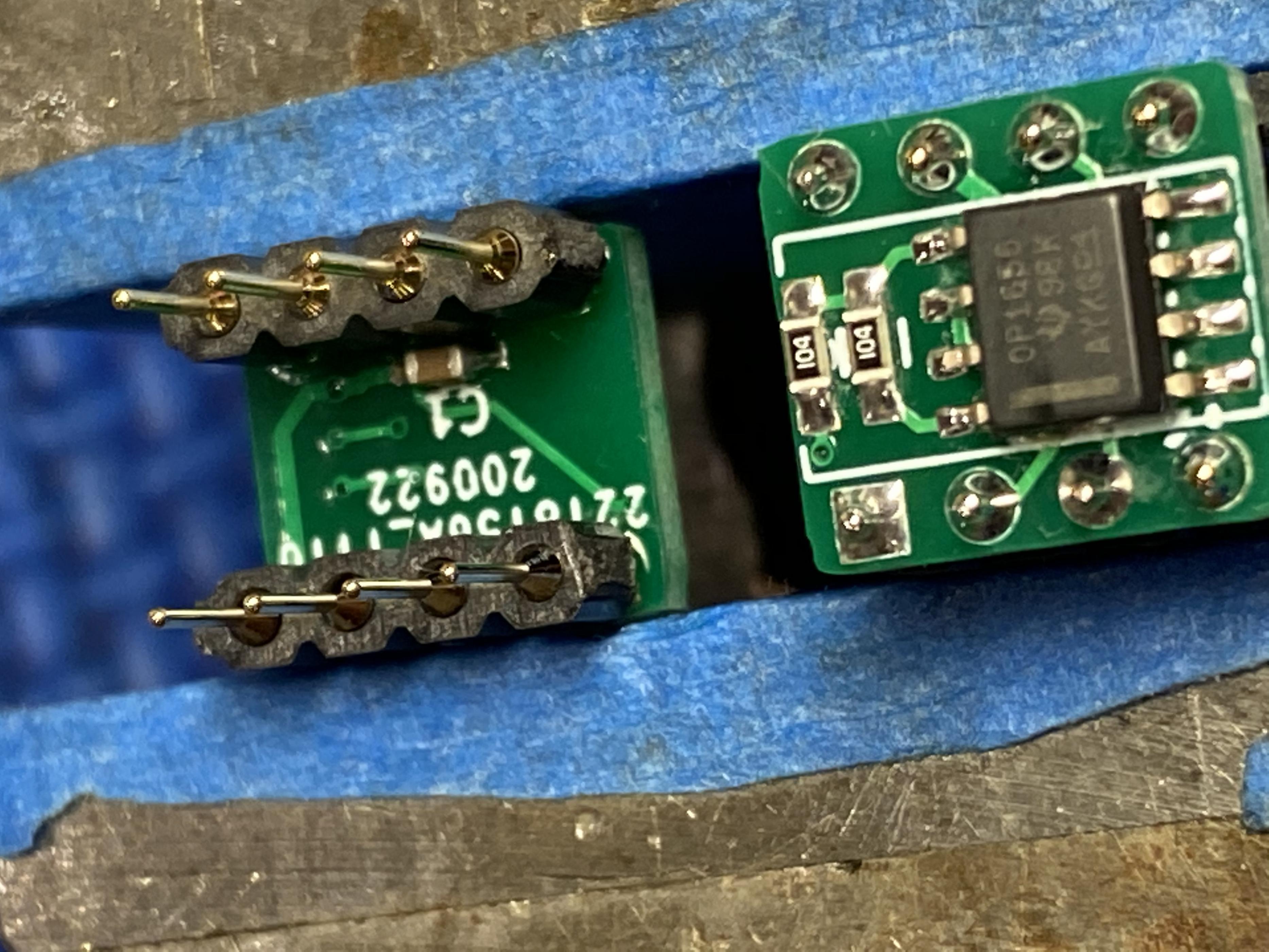

The C0G ceramics I used under the V6 are Digikey part# 445-4801-ND.
Another good choice would be .1uF WIMA FKP3 100V film and foil types.
I usually use a +/- bypass cap with any opamp, as well as decoupling caps from each of the + and - rails to ground, which is standard practice for opamp circuits.
The caps I've listed should work well for any opamp.

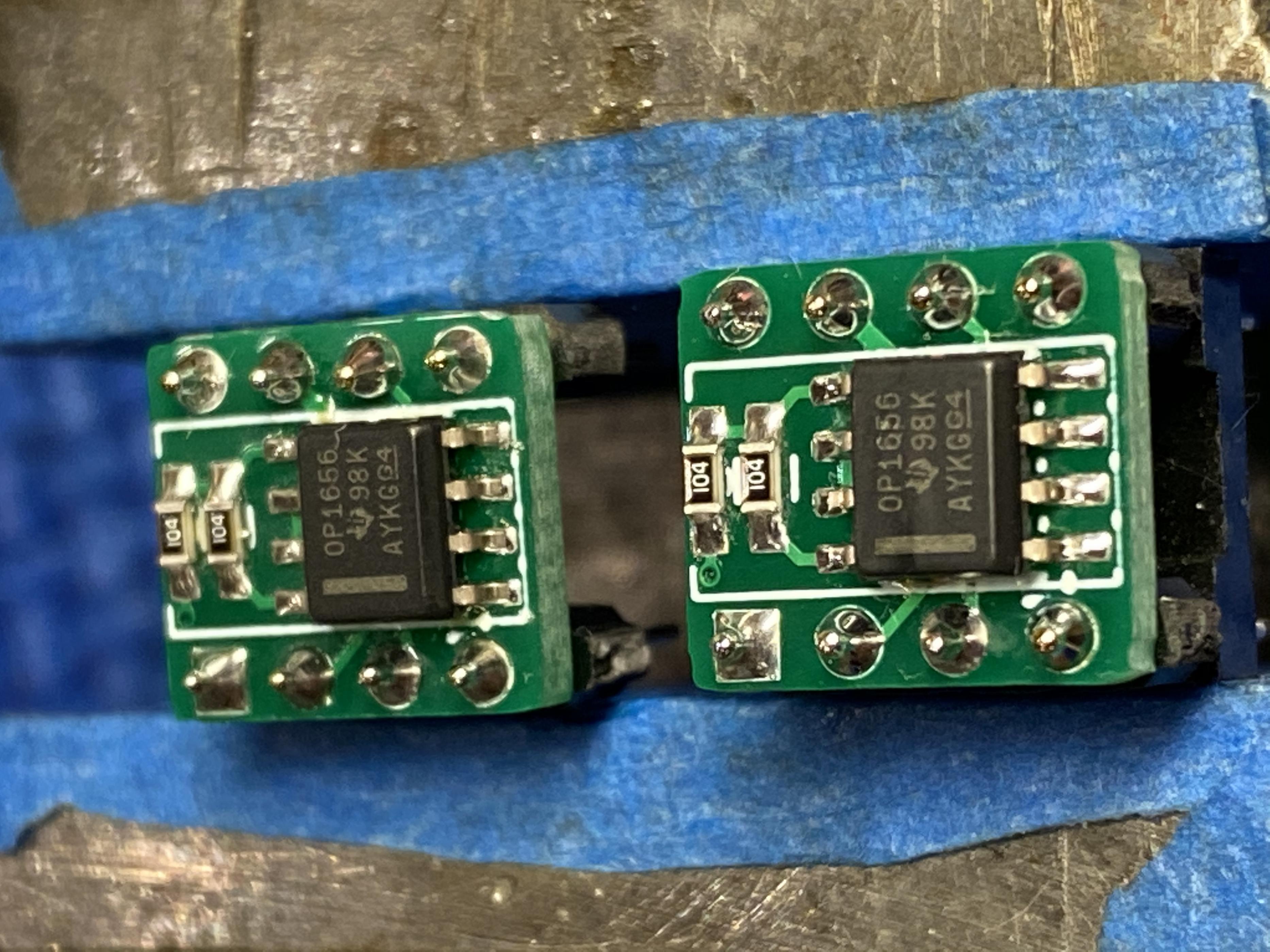

Having said that, I am curious what the Burson sounds like. Most of my gear has SOIC-8 SMT pads - not meant for swapping opamps but I want to install a DIP8 socket on the SMT pad.
Is there a DIP to SOIC (on the PCB) adapter? I have looked and can’t find one.
I usually use a +/- …The caps I've listed should work well for any opamp.
The topology can make a different decoupling scheme work better, it isn’t always the way you’ve described, just most of the time. Some op amps actually work better with only a +/- cap.

I would like to know if it's possible to replace a single opamp with a dual opamp on the AE9
Let's say i would like to test the OPA1656 on all the inputs, is it possible or there may be some problems with it?

Thank you for the pictures, so it's actually possible with some work.
Is it possible to buy those boards?
is XRKAudio the Johfland's company?
XRKAudio | Etsy
Jhofland is one the best electrical circuit designers on DIYA and I make and sell many of his designs in my shop. We collaborate together on a lot of projects. Many of them commercial products.
