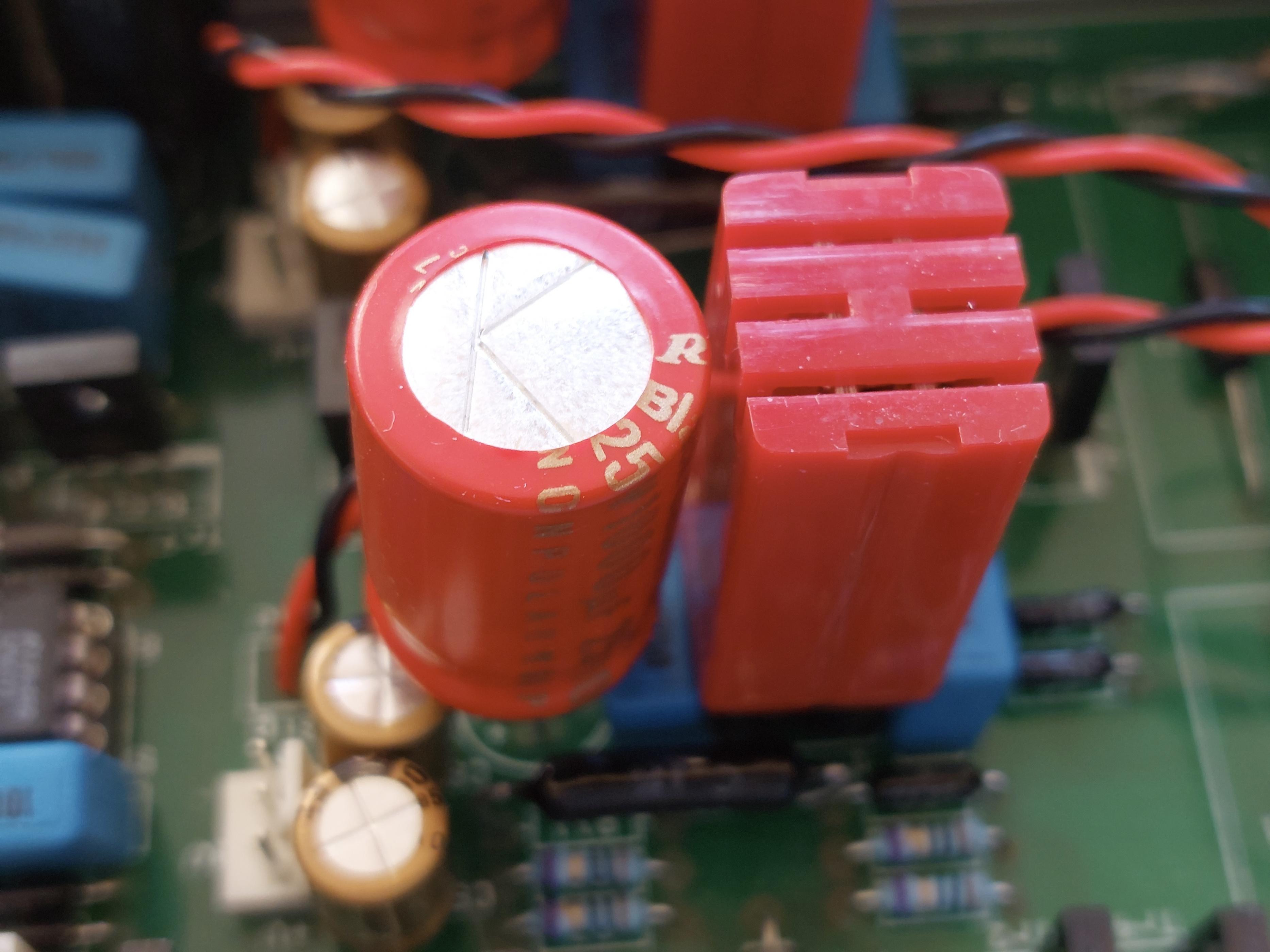

One question for the experts here,
I would like to know if it's possible to replace a single opamp with a dual opamp on the AE9
Let's say i would like to test the OPA1656 on all the inputs, is it possible or there may be some problems with it?

Thank you for the pictures, so it's actually possible with some work.
