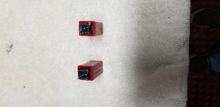

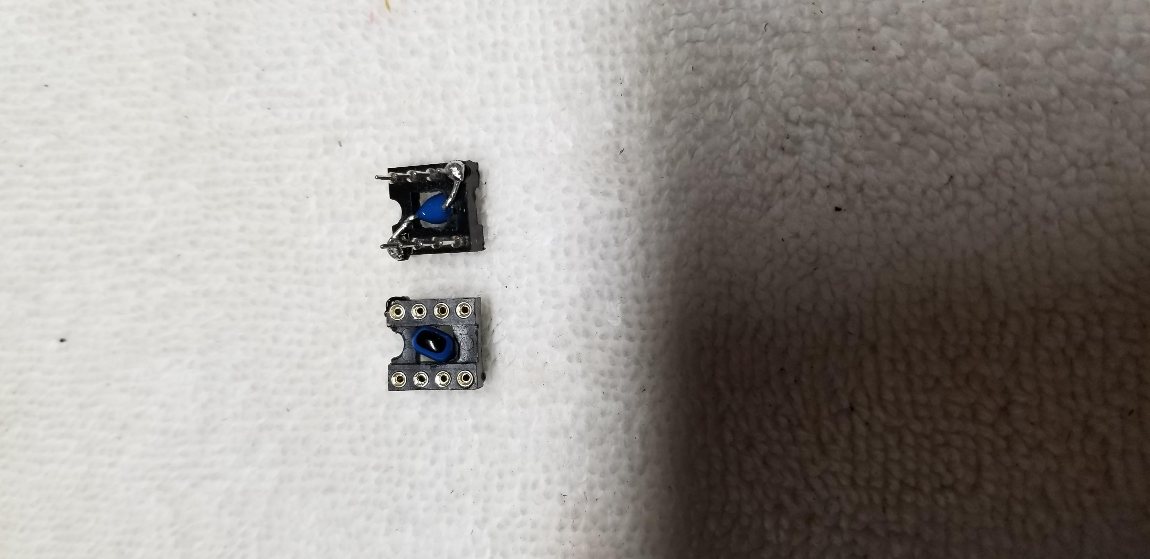

My Infinity RSIIb speakers come with a "necessary evil" low frequency EQ box with two single and two dual opamps. I run the speakers with DHT SET amps and a DHT 01A preamp and DAC, and have tried many different opamps in the EQ box to mlnimize its negative effect on the sound. For years, nothing beat OPA827, until I tried the V6 Vivid. The Vivid is hands down the best sounding in that application, in my system. YMMV.
PS: I managed to nestle a 0.1uF C0G cap in the included dip-8 adapter to bypass the +/- power pins by Dremeling a small indentation in the bottom of the V6 case. See pics.

thank you very much for the pictures and the little tip Magz! could you please link the cap ur using on mouser or digikey?
Another question, if could i use a bigger one (i have the necessary space) would you suggest a film cap? can you please provide some mouser links to it?
I'm relatively new to this world but i'm really trying to understand as much as possible in a short time, some tips are always appreciated to pick the right road and improve things.
I'm currently in Europe but when I get home at the end of the week I can post the Digikey part#.
There really wasn't space in my application to add a larger cap so I went with the .1uF C0G; you can use whatever will fit in your system. Film caps work well, too. Any polypropylene film and foil should work. I can also post a part # for that when I get back, but Burson had been recommending and selling 0.1uF Wima MKP caps for their previous opamps.

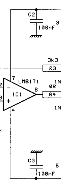

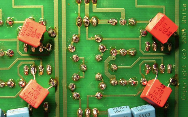

My rail-bypass caps near DIP socket
Evox Rifa PHE 450 0,1 uF
and bypassed the Evox Rifa PHE 450 100nF (C2, C3) with WIMA FKP2 10nF/63V
In front Evox Rifa PHE 450 0,1 uF are hidden from the Borson amps
