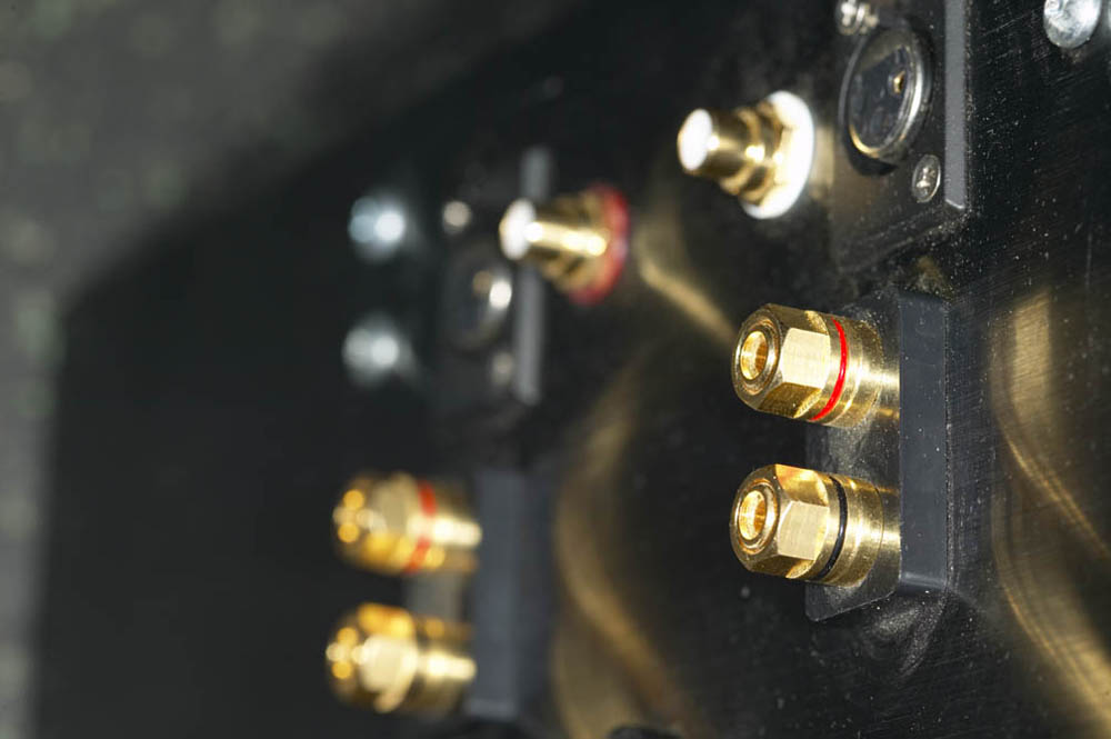

I understand Eric's desire to have multiple channels per chassis so he can park one by each speaker. I have this setup now and somehow it is just so cool to have one amp at each speaker connected by multiple one meter long speaker cables.
So, even though it will take more work, and manipulation, I think that in the end he will be more satisfied.

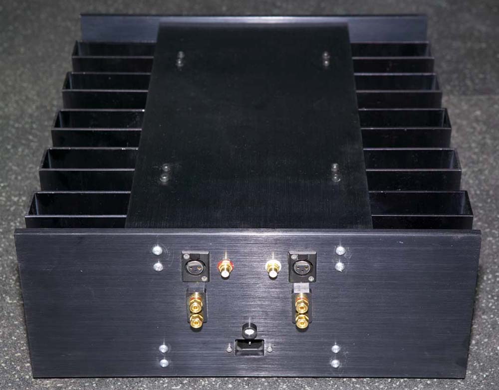

So the next question is whether the three channels per amp solves his needs. So, one for the tweeters, one for the mid, one for both bass drivers?
Talk about clipping! I think that the bass drivers are more likely to clip with just 60 watts.. Doesn't Linkwitz use 60 watts per driver?
I don't know much- I'm no master 😉 but I have read that the Aleph
isn't necessarily the best amp for bass use. An Aleph X might be better,but maybe that's a small point that you can work out later.
My inclination would be three channels per chassis as you propose but an Aleph for the tweeter, and Aleph X for the mids and some complementary Pass design for the bass to get the power up without cooking anything. I have no idea how these amps all sound together but there are people here that do know!
OR
Two channels per chassis- tweeter, and a bit larger for the mid,
and use two channels of your current amp per side for bass. Then you could use it on warmer days too..
OR
Put the two Pass channels in each box and a Hypex module for the bass :hot: :smash: Should have bought that pair at the auction!
My plan is similar to your second-last suggestion: use the A5 amps on midrange and tweeters, and continue to use my current amps (ie, my present voltage amps, not "current" amps) on the bass. Having (I think) finally heard and understood the importance of low harmonic distortion for good low bass reproduction, I want the cleanest amp down there. The current amp has 1%THD at 200w, and 0.1% at 180w. The system seldom uses anything near that, so HD should be even less in practice.
The issue is our ear's rapid change in sensitivity to level in the bass: 1% 2nd harmonic is perceived as something like 5% or more an octave above, say, a 30Hz fundamental. After three years with one set of amps, I switched last year to another, and this affect on the delineation of bass instruments and bass lines and separating them from stuff in the lower midrange was really obvious.
- Eric
" ... My plan is similar to your second-last suggestion: use the A5 amps on midrange and tweeters, and continue to use my current amps on the bass. ..."
Mine will be a single stereo amp of ~ 1 horsepower driving large planar speakers and a single ~1/5 horsepower driving a single sub woofer ... them planars are real hungry. :smash:
(Here in the office we have a very old stereo, 60 watt Sony "current dump" MOSFET driving small planars and an el cheapo Chinese "all in one" sub.)
The Orion (Orion+ actually) has two woofers, one midrange, and two tweeters. The three channel amp will drive the midrange and two tweeters for one speaker. To quote myself, I described why I *want* separate amps for each tweeter earlier:
"Some are skeptical that each Orion tweeter needs it's own 60 watt channel, but I have small amounts of some kinds of music that, when played at rock concert levels, have clipped other 60 watt amps. SL uses them [the tweeters] down to 1.5hHz BTW. The power is not a need, but a desire!"
