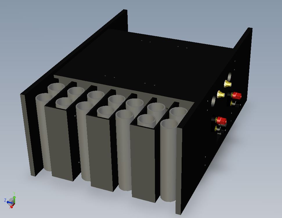

I played around with adding some surface area to the existing heat sinks in anticipation of getting more than 30W from my smaller chassis No. 34 (4 transistor pairs/ side) and came up with this straightforward addition.
My Big Question: What's the most single-ended performance I can reasonably squeeze from my bag of IRF250 and my smaller chassis and pcb?
Tosh,
I don't see how a lot of heat is going to be able to be transferred to the tubular heatsinks The contact points betweem them and the existing tubes is going to be very small. I think it would be a lot better to use square tubing in a similar waybolted to the existing sinks, with sink grease .
Variac: If I went the tubular route I would expect to mill a ~1/4 inch flat on each tube to increase the mounting area. (The tubes are shown as 1.25 inch diameter.) I first thought about rectangular tubes (especially as they would be much easier to work with), but figured they 'cover up' or rob a lot of existing area where they mount. I am definitely open to ideas!

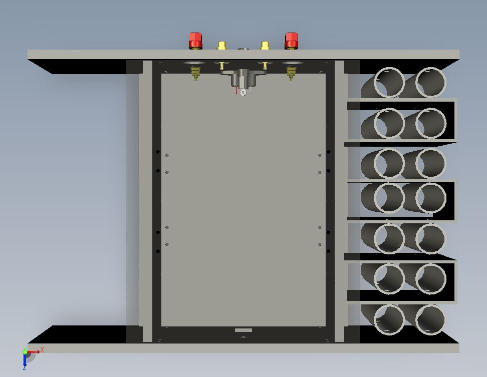

Here's a look from above with the cover transparent.

It was a little bit of softening the lines as well as preparing for max heat dissipation, as I'd like to get at least 30W out of it. But mostly playing with adding visual interest with minimum effort.

Single ended class A is unbelievably hot running if Tosh is planning to go in that directuon. More heatsinks allow more bias - a very good thing. But I think I would build the thing first, then see if more is needed..
Tosh,
As far as robbing existing area, I think that you will really want that common area to transfer the heat- after all they aren't one piece-bolted together isn't as efficient as if they were.. then again, what do I know other than the above..
Tosh,
