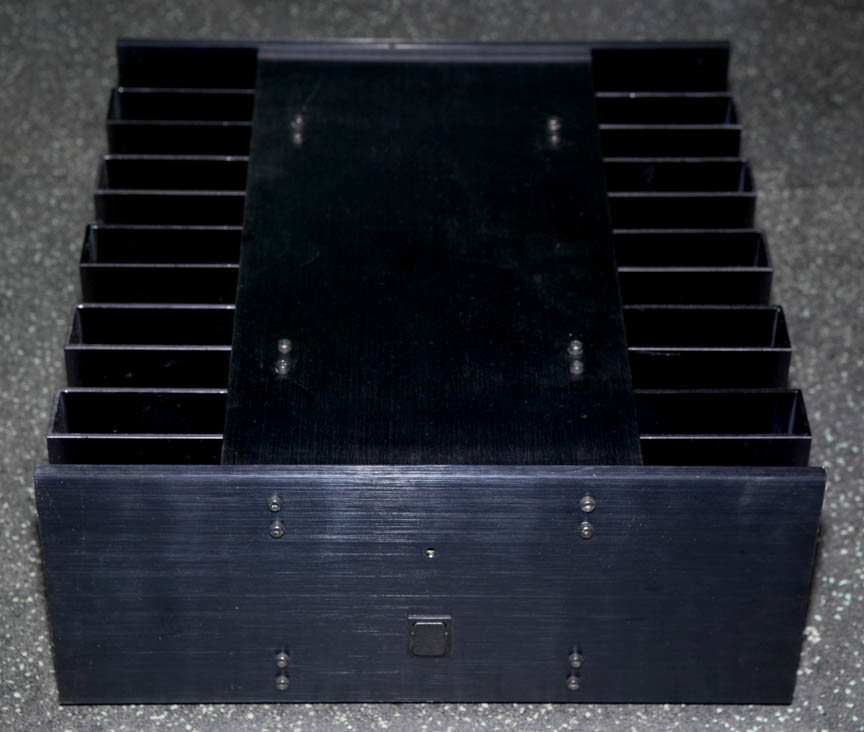

This is how I see it - There are just 10 -15 cases out there in the world that we were fortunate to get. The master worked on them, there are even hand written notes on fets with matching numbers. At least my intention is to keep it as much as possible as is. Nelson used these cases for his tests and experiments and in my mind it has a special value. My case is without power supply, and it has TO3 Mosfets installed. I would prefer to keep it as is, and the ideal case would be that someone has N channel only but would like to construct F4. That way we keep the cases intact we trade sides and we are all happy. I have no use for matched P channel mosfets, and someone will need just that. Instead of holding on it I sent it where it could have direct use, and preserve the original shape,
It is very easy for me to get TO247 package Mosfets and start drilling and tapping holes, but that is the last thing I would like to do on this case. You haven't seen the cases inside, majority of cases are with TO3 MOSFETS in the place with insulators and boards that are even with resistors in place. That is really worth preserving if possible and keeping as is. Out of that respect I offered in the first place to drill and tap a few needed holes for boards for everyone in this group, just to preserve these beauties as is.
Also on temperature specs I see this as a unique group effort, where everyone shares the same chasis, so from that perspective it applies to everyone and everyone has a interest of finding it out. What better place to start than asking the master itself who played with it, and knows how far it will go.
For everyone else on the list, my dear friend Choky is helping me with this project and he likes making fun of me. Sometimes well deserved on my side!

Some shots that have the amp chassis' in them. To give a preview.

Great Eric, that would work quite nicely for me. I am assuming that you have enclosure with 6 Mosfets pairs on one side (12 per side, 24 total). If you do than we could do complete side swap the size will match.
Regarding your plans, do you want to have two Aleph 2 channels in one enclosure or one? I am very positive that there is not enough cooling for two channels within one enclosure for that. And higher voltage with less mosfets on Aleph 2 will burn your mosfets.
What you should go for is Aleph 30 or Aleph 5. Aleph 5 uses 3 N channel pairs and your transformer voltage of 25v after rectification will give you around 34V what is exactly what Aleph 5 calls for. For that you need all N channel Mosfets. For any of them you can use 240 in the place of 244 and vice versa with no problems.
So if you decide to go different rout - F4 than I will be happy to exchange. In that case you will need complimentary pairs.

Given the hardware, I personally would build a stereo bass amp using the chassis with the complementary pairs, use the chassis with the
single-ended output stage for the midrange, and build a similar
smaller one for the top end.
Acctually this was the best advice, and explains everything. That way you do not have to change anything with your cases.
No disrespect to Nelson or AV2, but I don't need any more amps, let alone get these two gift amps running and then build a third amp from scratch.
A path is appearing in the fog: build two stereo A5 amps with 60 watts per channel and 1% THD.
