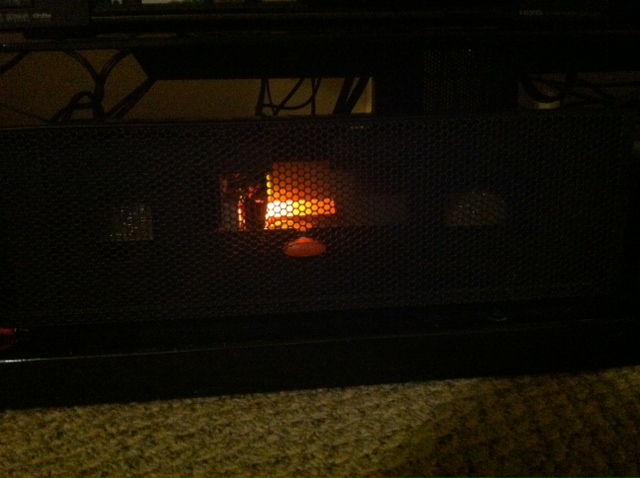

Hello to all my fellow Burning Ampers (or should that be Burning Amperes?).
I have had many hours of enjoyment listening to my BA-2 amplifier over the past year. My thanks again go out to the man who made this possible.
One thing I neglected in my haste to get the amp working was a power on indicator. This oversight has added to my electric bill, since, more often than not, I forget to turn the amp off when I am finished listening.
Recently I decided to move the amp back to my workbench and install something to let me know when the amp is powered on.
My first inclination was to stick a simple LED on or behind the front panel, which I made from a 19 inch dual height rack mount perforated metal security cover. I thought using the security cover for the front panel would give me some degree of shielding from electrical interference while still letting me see the internal circuitry of the amplifier. I have a bad habit of opening equipment up from time to time to look inside if I can't see inside without taking covers off!
I went digging through my parts boxes and ran across a tri-color (RGB) Cree LED illuminator PCB that I had bought for another project and never used, and my mind started thinking of somehow using it as a combination amp interior illuminator and power on indicator. I thought it would be cool to be able to dial up any color I want to light up the inside of my amp.
As I thought a while about various ways I might make best use of the device, I thought back to my younger days when I used to stare inside the back my dad's tube radio while he listened to the baseball games he dearly loved. The warm orange glow from the tube heater filaments was bright and cheery looking, and I fell in love with that look. It struck me that I would love to recapture that same look inside my Burning Amp, which has the physical warmth of a tube circuit due to the high bias of its impeccable Nelson Pass design, but not "that tube glow" that I love.
So I sketched out a simple triple adjustable constant source to drive the LED board. I built and wired the circuit across the second set of power supply filter caps so that the LED's light up as the amp is powered up.
There is enough delay in the RC supply circuit and inrush thermistor that the LED's come up gradually, looking very much like the filament light in a tube amp upon turn on. I mounted a white translucent plastic rod over the LED emitter so that the illumination would be diffused and spread throughout the interior of the amp with a good portion of it being visible through the perforated front panel.
With the circuit completed and in place, I turned the room lights down and started playing with the three color mix pots in search of that perfect filament glow.
I found that I didn't need the blue LED at all, and it was reasonably easy to mix the red and green LED's to achieve the look I wanted.
I hooked the amp back up to my living room system and turned the room lights off. When I hit the power switch and watched the amp power on, I couldn't help smiling at its fine new look.
And there was a bonus that I hadn't anticipated--when the amp is powered down, the discharging power supply caps allow the illuminator to gradually dim, adding very much to the tube illumination illusion.
So now my Burning Amp is finally finished, and my support of the local electrical company should be a little less.
If anyone is interested in the circuit, let me know and I will gladly share it with the group.
Thanks to everybody here. I really love learning from you all.
