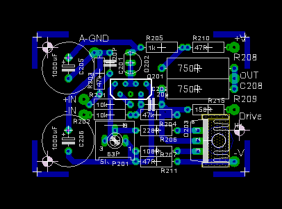

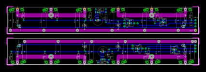

PCB layouts
My take of Mr.Pass suggestions...

Fugly
Hi Zen,
What means fugly? FeryUgly or something like that? Ha ha...😀

A question for the component specialists...
What is a good choice for drain resistor of the VAS (750R/3w)?
I ordered some wire wound precision resistors but I'm a little affraid of the induction. In fact I'm looking for something with a low temp coefficent/low noise but couldn't find anything.
Suggestions?😕

everyone around are commenting ( when someone posted something good ) how's nice , awesome blahblah
from several reasons I'm always posting Fugly! as fookin' ugly ...... take it as " that's really ugly , I don't wanna to have something like this , I can make something like that with one hand behind my back etc. "
shortly - that's just expression of my envy :rofl:
:cheers:
(for critical places you can use MOX resistors - there 3 pcs 2K2/1W in parallel )
mox resistors

My 0.47R resistors are Mox series too but it's difficult to get the higher values. Above 47R is a problem here in the Netherlands.
I checked Farnell,RS, Digikey etc. but couldn't find what I want.
Any suggestions again?

Back in the previous century MOX meant a resistor by Visaton for loudspeaker filters, either the MOX-4 or the MOX-10 series.
Nowadays MOX just means a Metal-OXide resistor, and can be from Mundorf, Visaton, all the way up to let's get really plebish KOA Speer MOX1/2-MOX1-MOX2-MOX3.
Thx Jacco,
I'll have a look again.
I have seen very beautiful "mini mox" from Ohmite (medical/space quality) but couldn't find a supplier.
