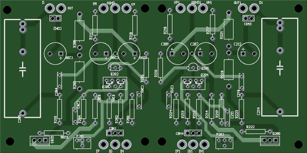

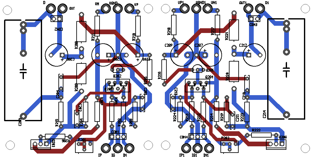

I just did a quick layout of the frontend for you guys to comment on. The silk screen is still a bit messy and a few components will be aligned more nicely later. But I would like to get some feedback.
I have attached a blue/red version, where blue is bottom and red is component layer.
The green version gives a better impression of how the boards will look like when produced.

Any chance the large connection pads could be a little bit further apart?
I will use Keystone turret terminals instead of soldering to the board thru hole directly, since they're going to get taken apart and put back together a lot. The larger ones like #1503 have a collar on the top of that is 0.187" (4.8mm) so they get VERY close on the F5 power supply boards I have now.
Tom
Tom
Hmm.. I have to think about that. The reason for the distance (~5mm) I have chosen is that it fits with many standard terminals. If you can point me to some reasonably priced easy to get terminals of a different spacing than 5mm, I might change it.
BTW: The board is 2.7x5.4 in inches.
