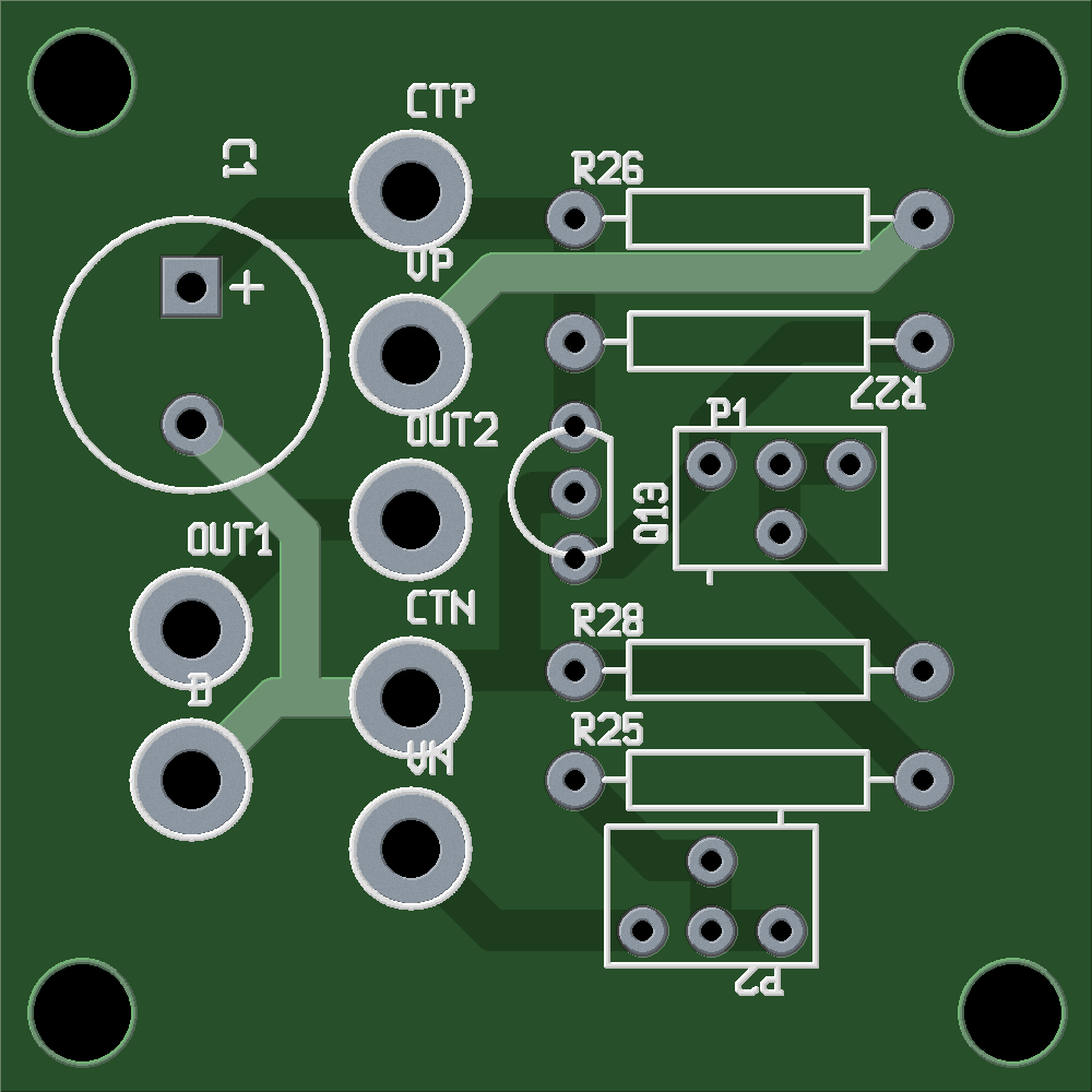

The bias boards are not all that exciting... I think I'll make them like the attached, but I want to make it easy to place on top of the output boards, so it might change a bit.
This board is currently 4x4 cm.
... Not sure how you would attach them to the plate but I suppose super glue on the sides of the TO-92 would do it.

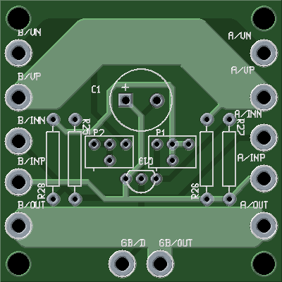

Finally some progress on the output and bias boards.

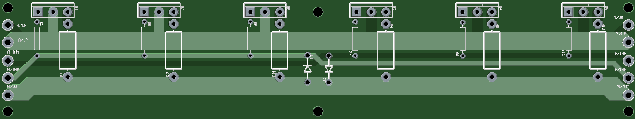

The bias board is 4.5x4.5 cm and output board is 24x4.5 cm.
The idea is that the bias board can be attached in either end of the output board and the mounting holes and connections are lined up so that the boards can overlap.
I would appreciate any comments or suggestions. Before fab I'll clean it up a bit and write some text on the boards to make the assembly easier.

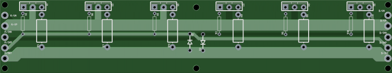

The output boards are 3 complementary pairs, so if you wanted to do a Full Monty 6 pairs per channel BA-2 you would use 2 output boards per channel. Of course the actual BA-2 chassis' already have output boards, these are for people that don't have a chassis- or just need output boards for other projects....

Hi Cviller
The boards look good.
Is the output board for one channel or half of one channel.
It would be nice to have the option to do mono blocks as well.
If you could do 2 output boards per channel as an option for people that might want to do mono blocks that would be good.
ie n-channel on one heatsink (on one side of case) and p-channel on another heatsink (on the other side of the amp case)
You know what I mean all N-channel on one board and all p-channel on the other board (as an option).

Hi Than1973,
The output boards are with three pairs on each board, so that you can use two boards pr. channel if you want to do exactly as the article suggests - but papa also mentions that it is perfectly fine to use fewer devices, which I would expect many would want to do...
If you want all N's or all P's on one board you can short V+ to V- as well as the control signals - I'm not sure it is the best solution to have all N's on one board and all P's on the other, but it can be done easily. 😉

I am not interested in 12 output devices, 6 is enough, 8 would be the absolute maximum.
I know Nelson does this sought of thing with the Alephs ie all current sources on one heatsink and the output device on the other heatsink, it could be a completely differet story for a push pull out put stage though, as you say.
I suppose I could use two output boards and only put four devices on each board (ie on each heatsink)
