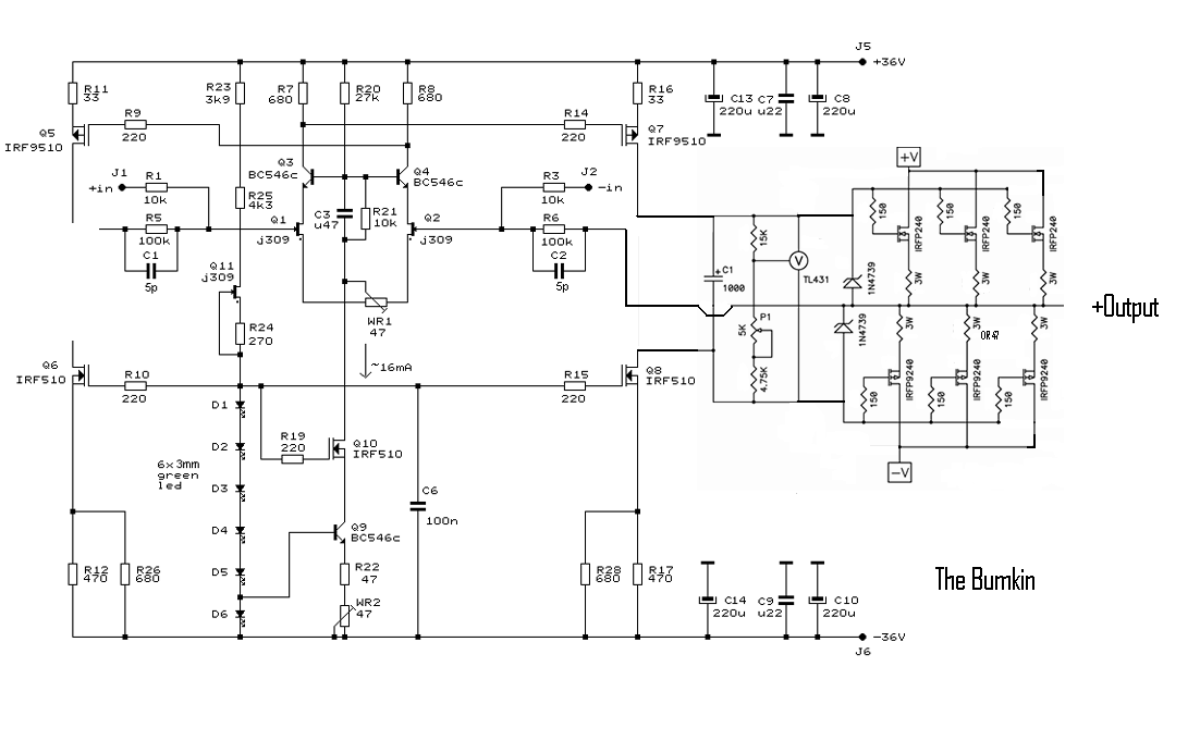

Pumpkin + BA2 output = Bumpkin, my next project, the drawing is incomplete but you get the idea :smash:
