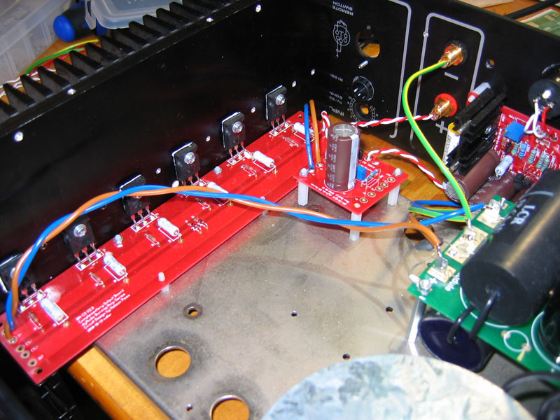

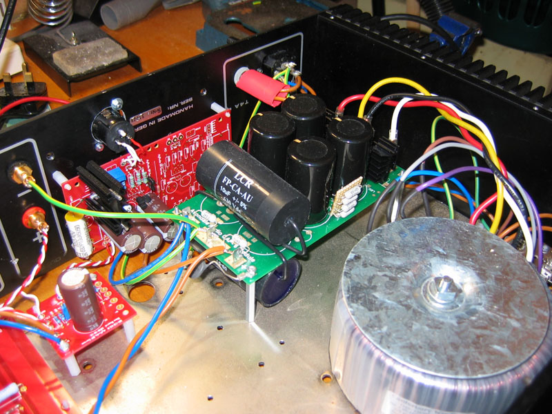

If I understood Nelsons instructions right, you want to measure the voltage between the drain-pin and GND actually. However, this adjustage isn't very critical, as any dc will be blocked by the cap anyway.
EDIT: We want some pictures, instantly 😀
Best Regards, Florian

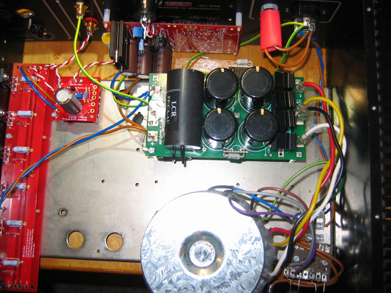

Here are some photos. If my chum doesn't come through with the other chassis then I'll have to transfer the whole thing. At the moment I have 250mV across the source resistors and the heatsinks are barely warm after 15 minutes.
Chris

Strange question to ask but how loud should the amp be? I've turned the pre-amp volume control to 3/4 of the way round and I'm just getting a reasonable output. The exposure amp on the other channel is too loud to listen to. Heatsinks are warm to hot at 410mV across the output resistors. Nice sound when I can hear it though! Running it in single-ended mode.
Any thoughts?
