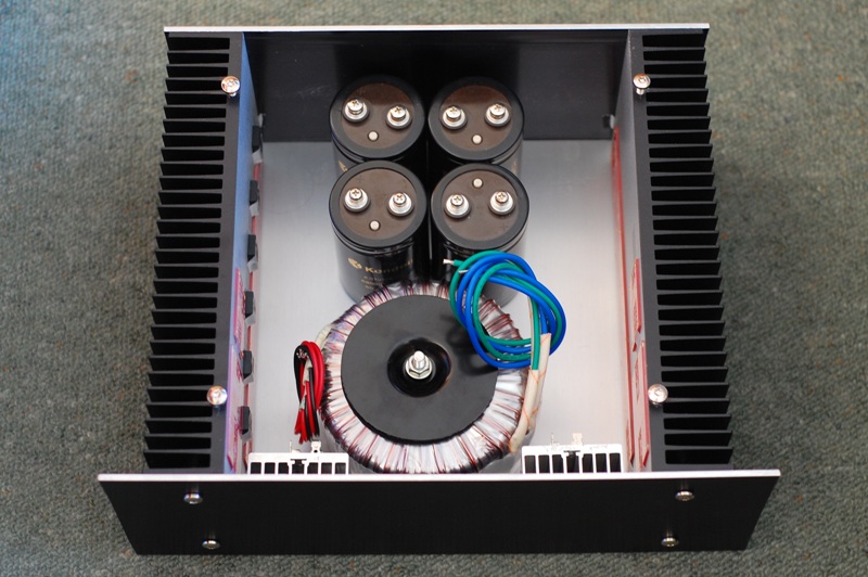

Do you think you need that much heatsink for the diode bridges?
Chris
cant say for sure, but I dont think theres such big need for heatsink on bridge
I have never experienced a bridge even getting just a little hot
mounting on bottom plate have always been good enough
You will notice Nelson doing it that way too
double bridge ought to help too
I agree with you🙂, this is generally true for people who have adequate chassis size, mounting the bridge diodes on bottom plate is effectively making the whole chassis the heatsink for the bridges. Those bridges do get hot hence the metal backplate. In my case, I ended up with a compact chassis; 30cm conrad. From other people experiences a much bigger conrad than mine do get hot from an F5 with much less amps than BA2. As much as possible I would like to take heat away from the metal chassis, will also elevate the trafo a bit, 🙂
I have dual bridges in my Krell Klone monoblock.
I was surprised, without heatsinks they became too hot to touch when biased to 2.6A.
A single 7C/W for the dual bridges makes them run cool.

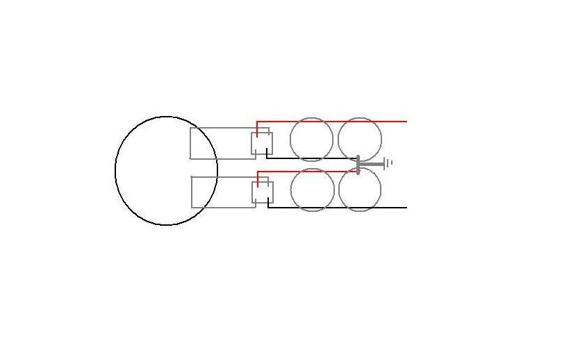

Take a look at the F5 PSU recommended by Nelson, it uses a dual bridge.Andrew,
How do you wire up the bridges in a dual configuration?
some will like the ground to "join" at the last cap pair, and some will "join" the ground at first cap pair
do not put the "ground" on either cap pair.
These links carry very high pulse currents back and forth to the transformer via the rectifiers.
Take a short, or longer, lead from the last pair and place the Audio Ground on this lead. This isolates the Audio Ground from the voltage variations that accompany the pulsing currents.
The reason for not tapping into the first cap pair is that what initially looks like a C//C filter is actually an rC(l+r)C filter.
The first r is the resistance of the transformer windings +wiring +rectifiers.
The l+r is the resistance and inductance of the lines between the capacitors. These impedances can be very small but they are not zero.
If one compares that rClrC to a more conventional two stage smoothing using RCLC then it is obvious that one never taps off smoothed DC from the first capacitor.
Always tap off the last C and keep the wiring from transformer to rectifiers and from rectifiers to smoothing short and twisted.

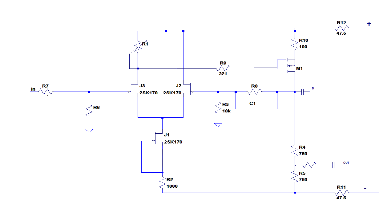

Are there any downsides on 'inverting' the frontend?
I mean flipping over the FE horizontally and using 2sk's in stead of 2sj's, leaving the CCS up to a 2sk and using an Nmos? The noise figures look the same for the sj and sk's. Or is this just a silly and bad idea 😕?
The reason why is that I won't be needing the hard-to-get 2sj74's-2sj109's.
I have intensively searched on this forum but i could not find any thoughts on this... I have attached a rough sketch.
