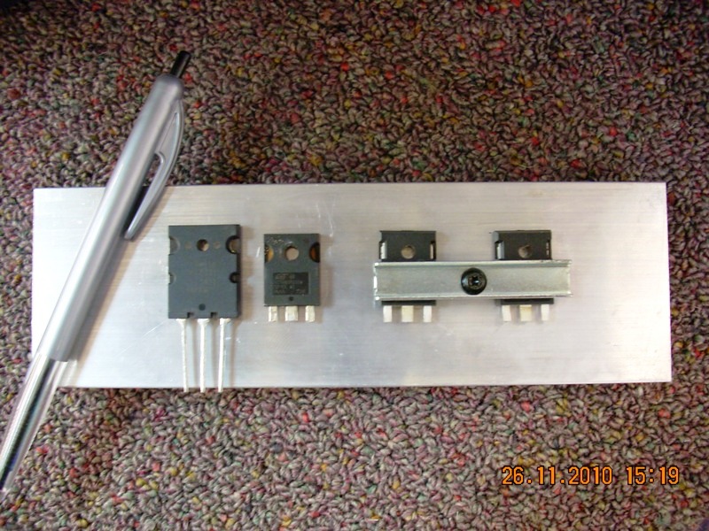

In the BA2 article, Mr. Pass mentioned, one way of correcting the IR P-Channel Mosfet distortion is to use a different mosfet. I am half way in the build and seriously considering using the 2SK1530 and 2SJ201 for output devices instead of the IRF's, for it's very good trace as shown by EUVL in another thread and for its robust apperance. The only problem is, I don't know how to implement this. Can somebody show how it's done, please ...What part to change / adjustments to get the optimum performance out of the Toshiba's? Any input is greatly appreciated, thanks in advance. Rey

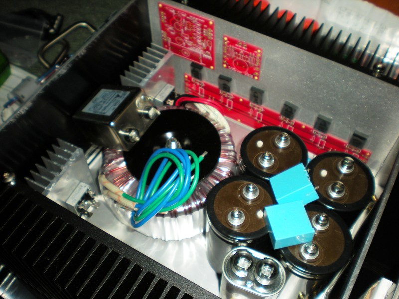

Hi Reyntz,
Do you think you need that much heatsink for the diode bridges? You're making me feel inadequate.

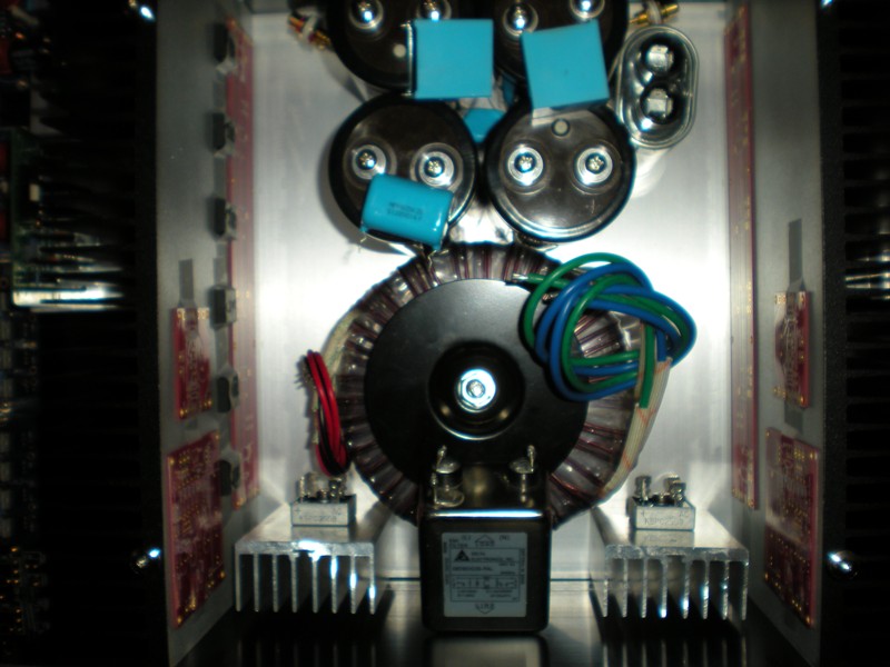

Hi Chris ,
All the current the amp will be consuming will pass through these bridge diodes, one bridge supplying half of each channel. I would like to run mine about 3 amps per channel or 1 amp per output devices x2 channel, that would mean 6amps continuous current draw through each bridges, approximately. I have them in a separate heatsink and not stick them to the main h/sink because I want the the output devices to have a uniform thermal characteristics, I actually feel the bridges heatsink is inadequate, still need to thermally couple it to the chassis floor.

I’m wondering if these bridge diodes the really needs to be rated as high as 35 A. I have a couple that are rated 25 A 400 V. Will these be sufficient or must i get bigger ones?Hi Chris ,
/Forsman
/Forsman
I'm using 25A 800V garden variety, I think its more than enough with allowance for transient current.
