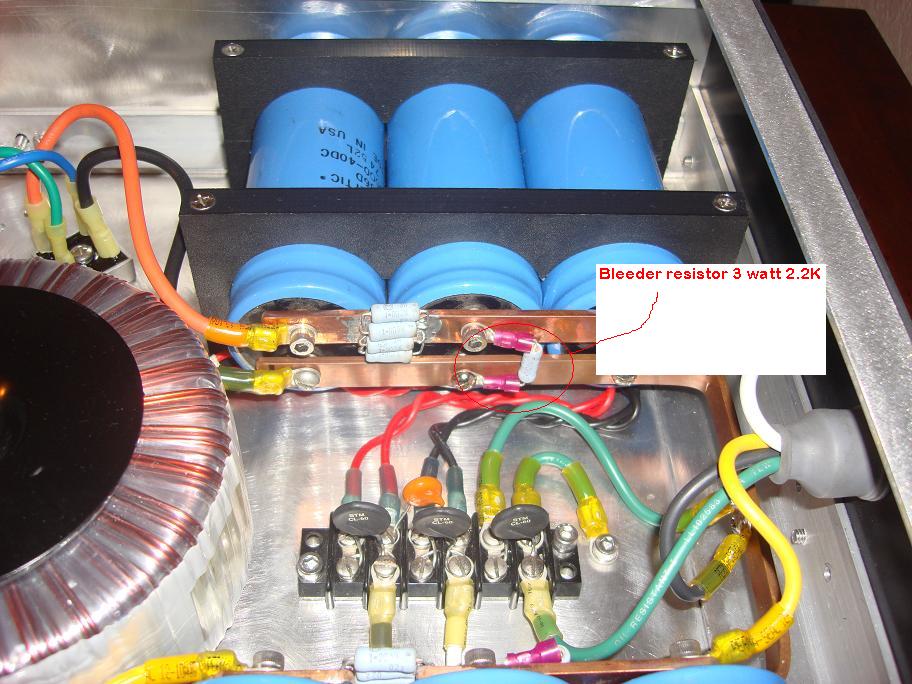

Can you tell me a little more about these 'bleeders'.
Chris
I beleive he means using a 3-10W 2-2.2K resistor across positive to ground and from negative to ground across a set of caps in the power supply. When powered off, they will bleed down the voltage and discharge.

Chris,
Attached is a picture of the placement of the bleeder resistor.
As for power and earth grounding here is what I choose to due. Please if someone sees something wrong with this please voice your concerns. I want to be safe as I have kids in the house.
The power supply chassis is directly grounded to earth. From the chassis it goes to the power rail grounds buss bar thru a CL-60. Running from the power supply to the Amp chassis are 4 wires carrying the V+, V-, Power ground and a direct earth ground. In the amp chassis the earth is hooked to the chassis and nothing else. My star ground for the pcb grounds is on a buss bar connected to the power ground. My thinking was very close to Zen Mods but I wanted the power supply to have a chassis ground at all times incase it somehow got turned on without an amp plugged in. The amp is dead silent with no ground loops. I believe this fully protects both units but please let me know if you think different.
Doesn't Nelson already have a 2.2K, 3W resistor across the terminals as you describe, just after the rectifier? Would these not bleed down the voltage?
Chris
Yes that is the bleed down resistor in Nelsons Power supply schematic. It can go any where in the DC voltage rails just needs to connect the DC voltage rails to the audio/ power ground. A capacitor will hold its charge for long time without them if no load is present, making for a bad day if you stick a hand in thinking everything is off. When I was in Air Force we would slightly charge a small capacitor then throw it to someone when they walked in shop door, your natural reaction was to catch it which was always good for a laugh. Another fun one was take the protection resistor out of a ground wrist/ankle strap, then when the person was wearing it we'ed take a Megger and connect it to the building ground system and send them a nice wake up shock. It would always take them a while to figure out why they where getting shocked.
