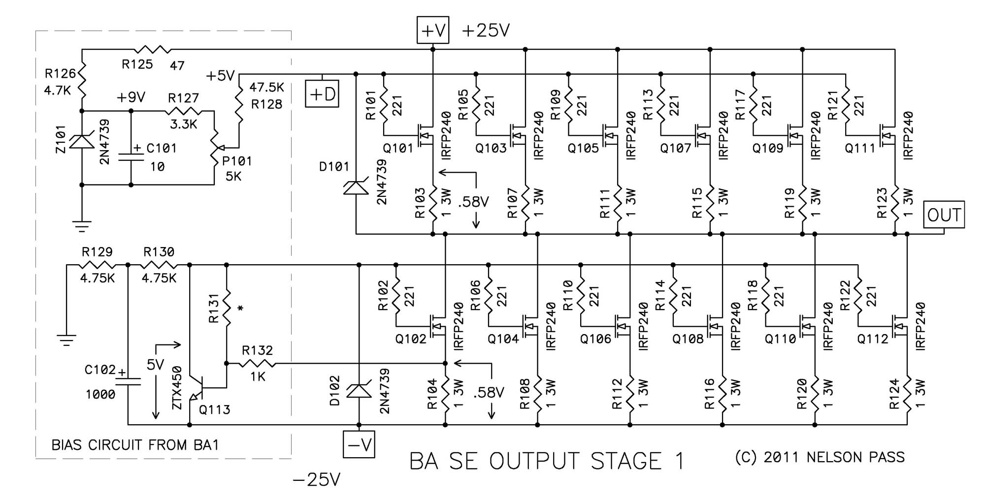

Here's what the output stage looks like with the front end removed. It
contains the components to bias it.

the 250VA 25+25Vac transformer has a maximum continuous current rating of 5Aac.
When using a capacitor input filter after the rectifier. the maximum continuous DC current rating is ~2.5Adc.
The amplifier continuous DC current draw must not exceed 2.5Adc and for cool running I recommend that the continuous operational current be limited to ~50% of maximum rating, i.e. <=~1.3Adc continuous.
What is the current draw of your amplifier?
How many channels do you want/need to supply from this transformer?
