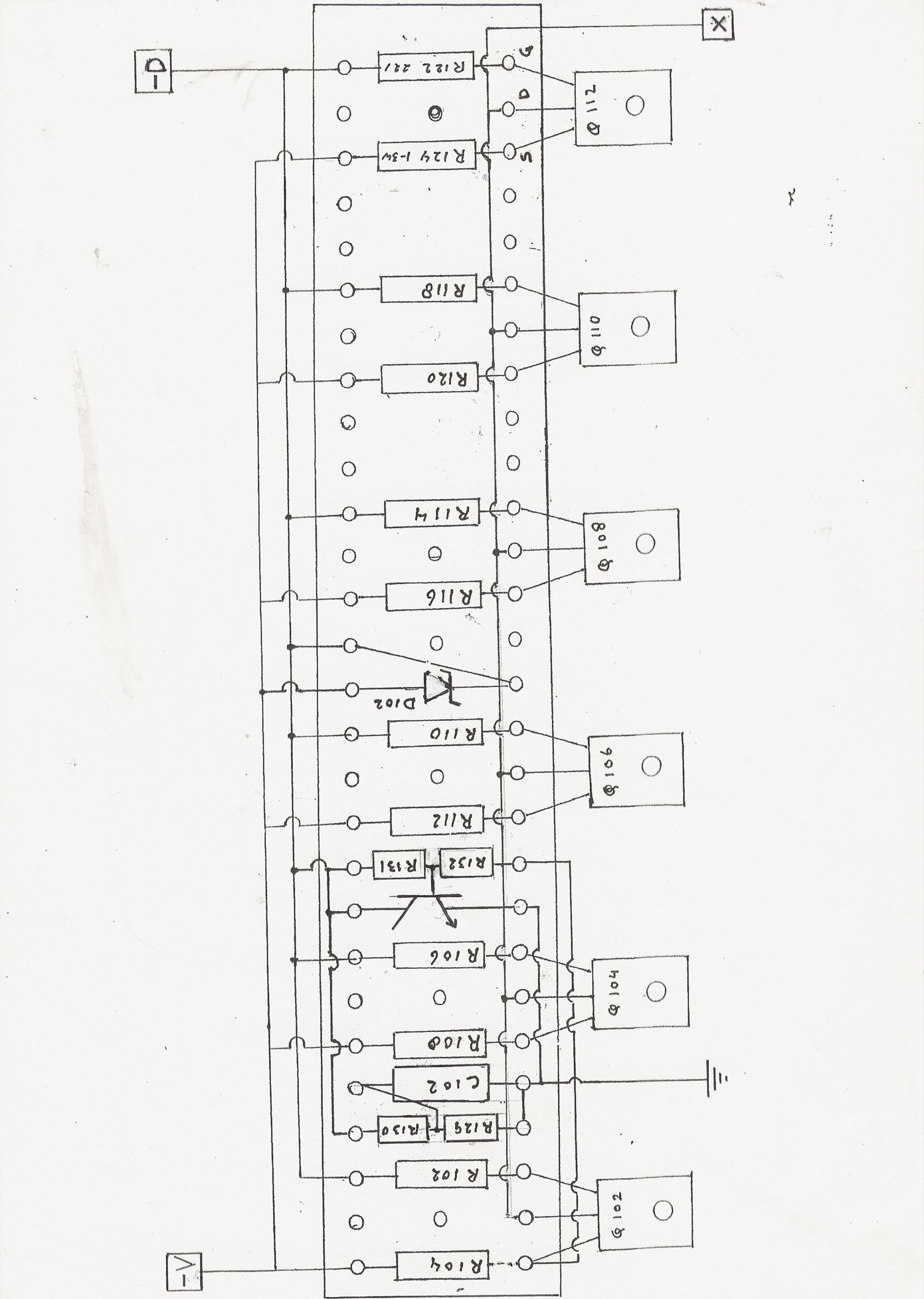

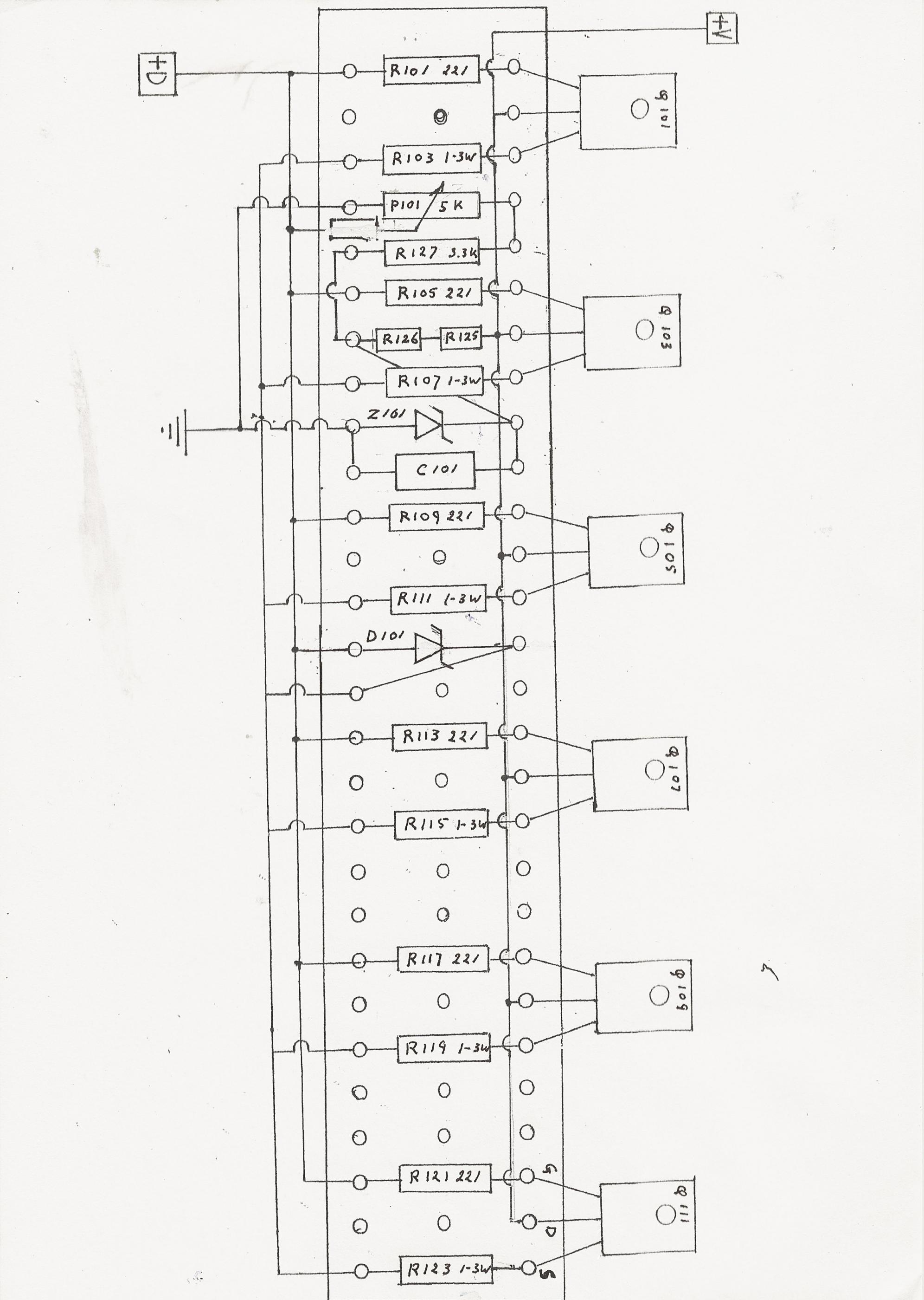

hardwire lay out for ba 1
hey, that is😎 thanks Nelson
me like to hardwire that one 🙄
:up::up::up: man you are fast 😱
Here are two draft drawings for a hard wired BA 1
The upper and lower mosfets banks are on separated boards
It's a first draft and it is not doubble checked for errors or possible improvements in the lay-out
Comments or notification of errors are most welcom
Regards

Looks good dude !
Nice 12" strip of 'Turret Board' eh?

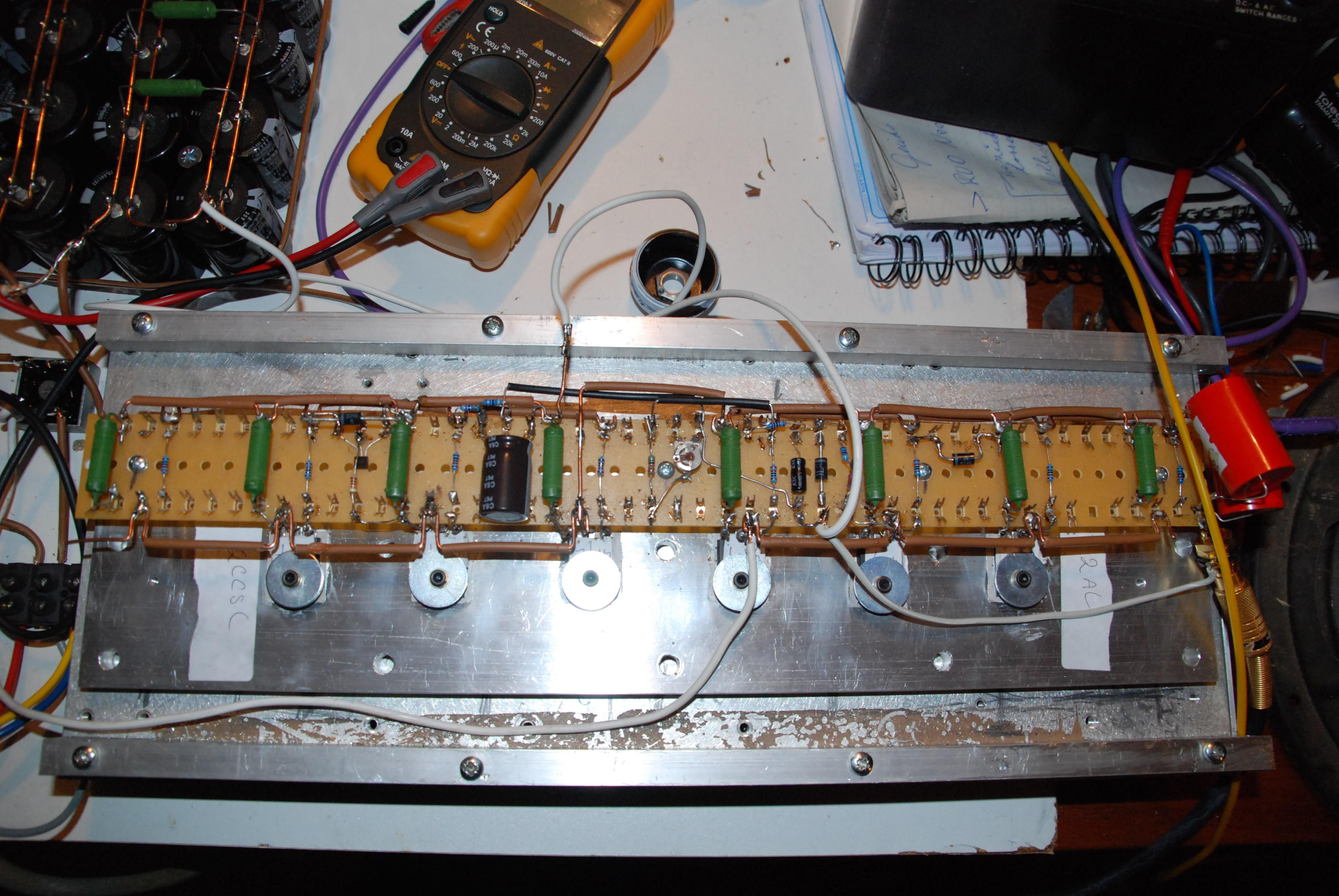

pics of an experimental setup of one hardwired working BA 1 outputstage/buffer channe
Here are pics of an experimental setup of one hardwired working BA 1 outputstage/buffer channel. I had to try one first to see if there were no wiring errors .
Yet another 3 of these to go. ( these will have a little improved tidier wiring and some decent input caps)
No DC and no hum on the outputterminals.
I had hoped that my wadia 830 would deliver a sufficient amount of voltage but it doesn´t.
So I guess I will have to put ba3b in front of this.
Regards René

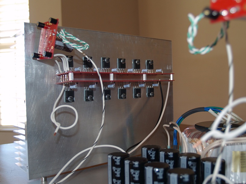

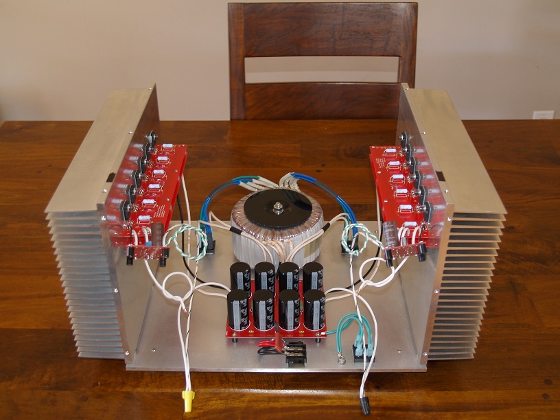

SE Burning Amp almost done
Hey everyone, I wanted to share some pics of a single ended BA that I am working on. I just fired it up last night, and had to change two fets that I mismarked when I matched them. Other than the heat, it is all good.
I know, the sinks are horizontal. It was a compromise, and I may compromise more because of it. Either by taking out pairs of fets or using R219(131).
The amp has +/_ 23.5 volt rails, using an antek 8420, 12 matched irfp040 per channel, all 1 ohm source resistors have .6v or so across them. Adjusting the offset was easy. After two hours idling, the sinks settle at 65C. I am going to play with R219 or R131 to see what happens.
Cheers
