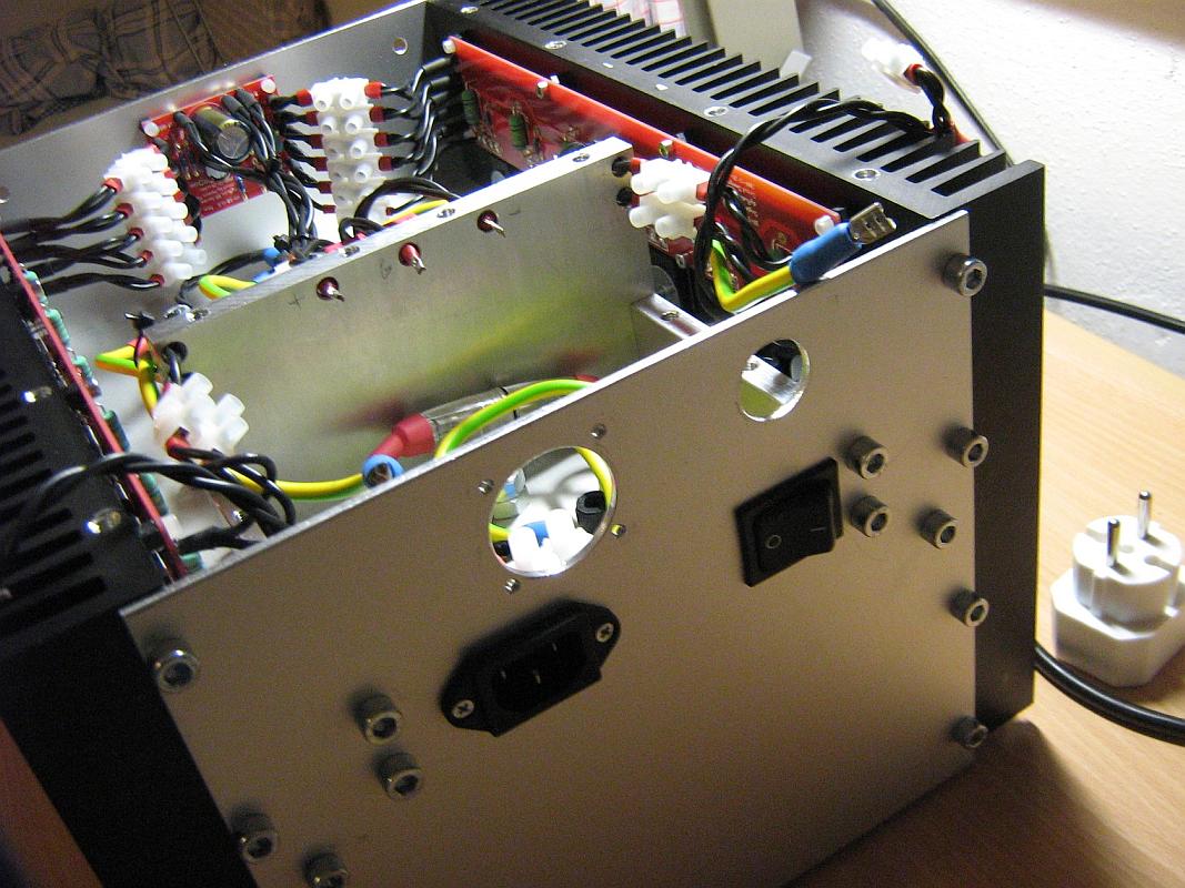

It's alive!
There's some hum in the psu and the fuse blows sometimes because it's to small, but it works and plays! It was really like plug(&measure)&play!
Only one quick question: Voltage drop over the resistor, where the sense of the negative bias-board is applied, is a bit lower than that over the others, right? V at the sense-resistor was arround 0,62V and all others 0,68V (all measured before fine-tuning the output stage).
Pics tomorrow...

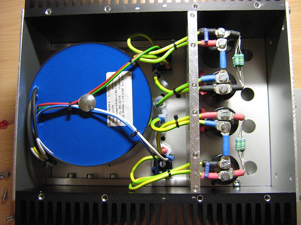

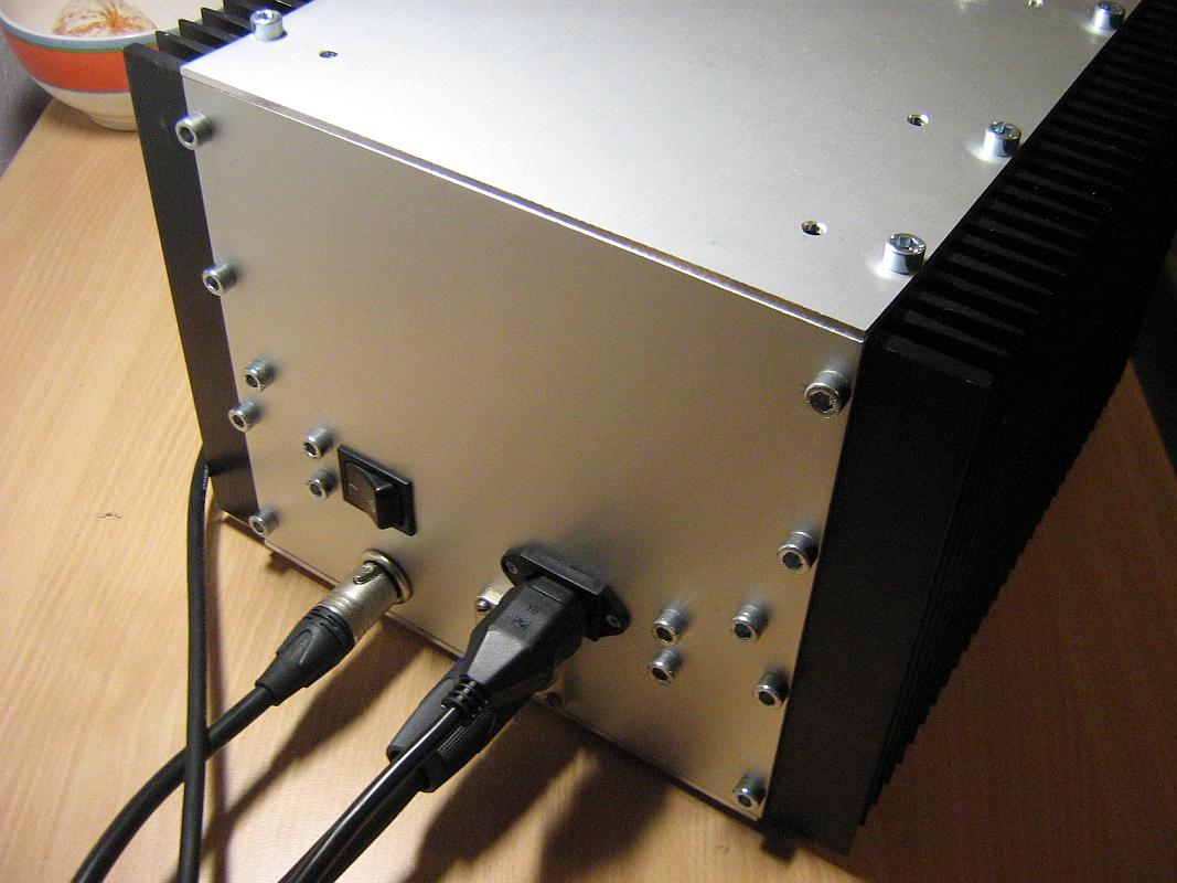

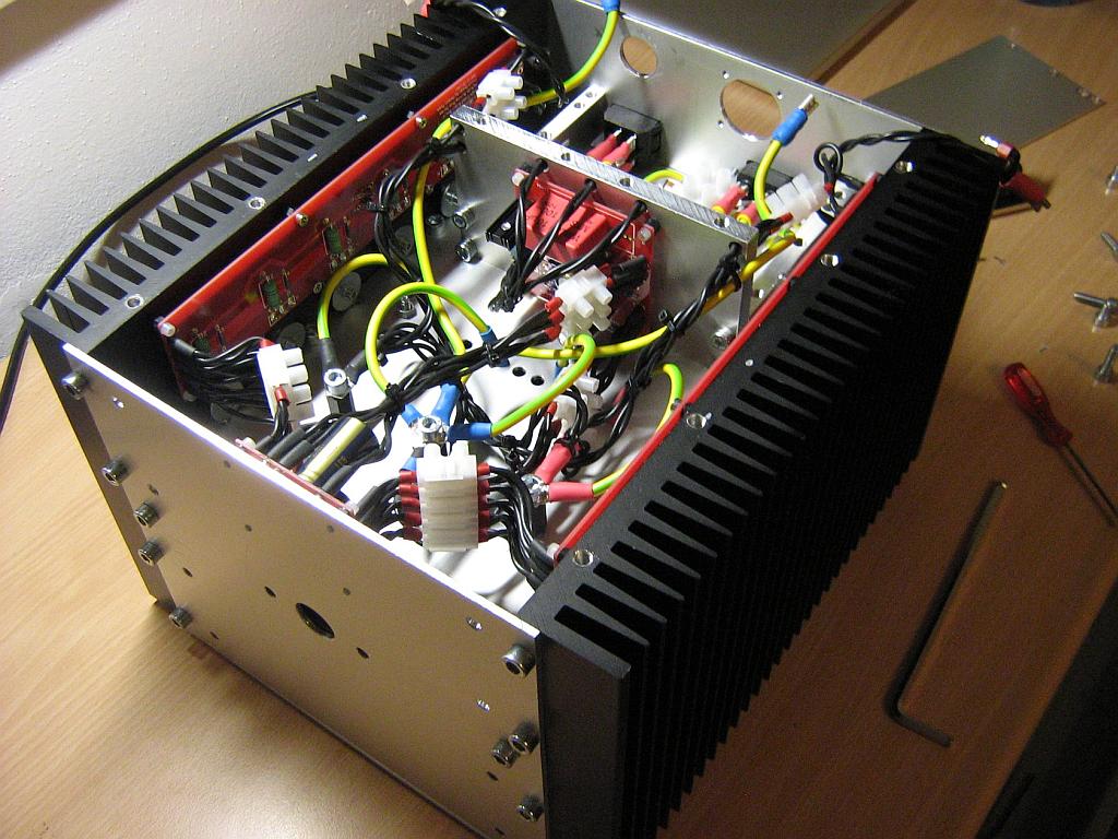

So, here are some quick shots.
Amp is working with a 10A fuse I found here at the moment, but I will get some smaller ones, 2.2A or so, don't worry. 😀
The (complete) box is getting relatively hot, don't know the exact temperature, but its above 49°C (I've got to get some cheap meter for measuring, or maybe i can borrow one from chemics teacher).
If it's really to hot, although I don't think so, I will add some holes in the bottom and top and front and maybe add some small fans.
Best Regards, nightrush

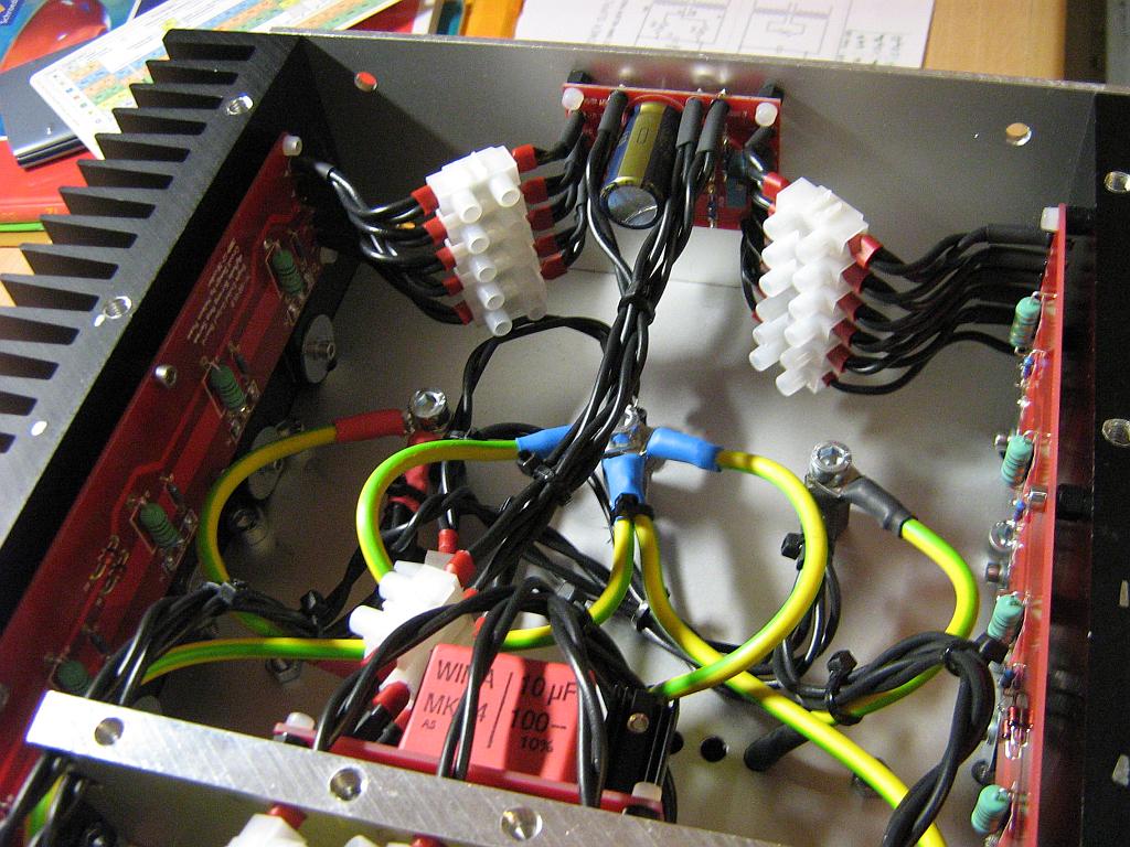

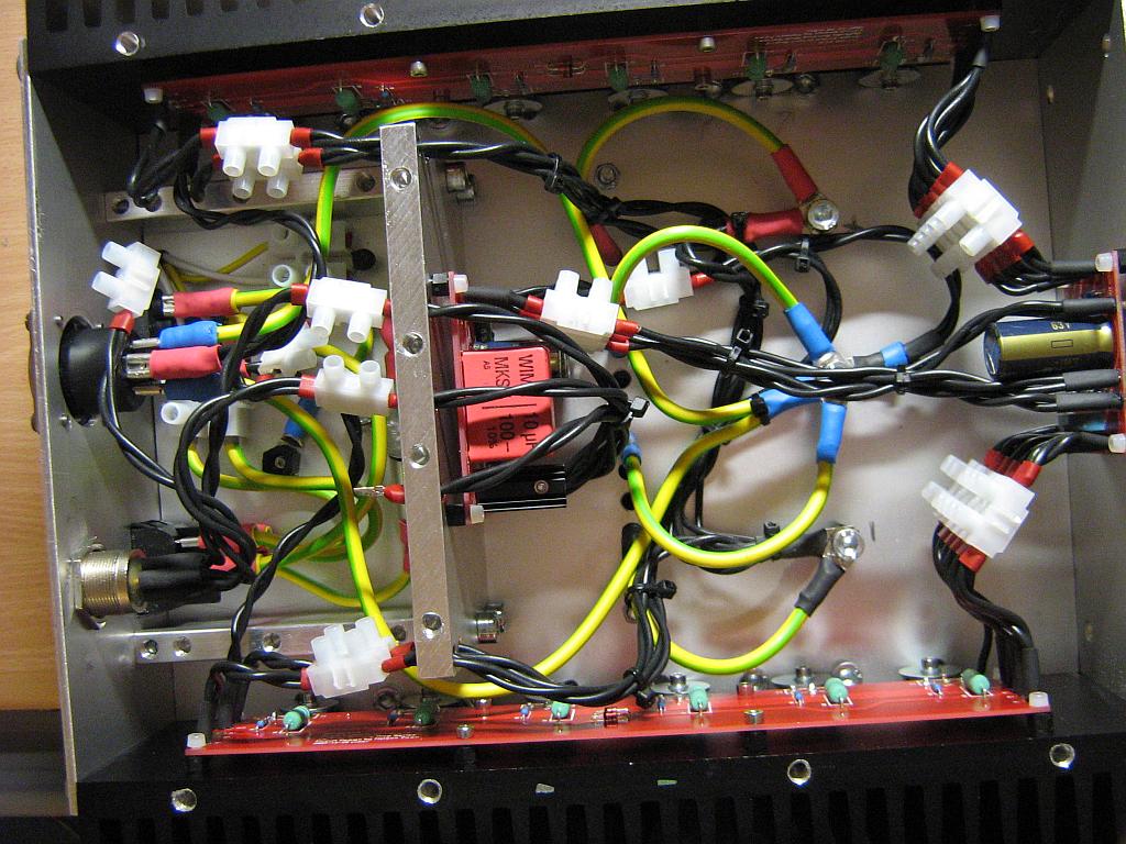

post205 pic6 shows pairs of wires passing through holes in the aluminium plate.
Take care to ensure all the Flow and all the Return current pass through the same hole !
Thanks Panomaniac.
Thanks Panomaniac.
Thanks Panomaniac.
Uhm, which exactly do you mean? Those black cables passing through the massive panel?
and yeah, thanks for resizing the pictures, I forgot to do this to all of them.
