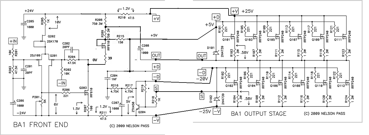

Nevertheless is there anybody outside there who can help me with my problem what to do with the two biasing branches of BA.-1 when I omit the coupling cap ( see posting 158 ).
Should I keep the negative branch and the positive branch is done by the front stage?😕

Oh thanks Zen Mod,
The best is I give you the BA-1 link. Nelson mentions on page 5 : Strictly speaking you do not have to use this capacitor, but it does make adjustment and long term DC stability very easy to achieve.
I want to omit the coupling cap do you understand his words right I have to keep the negative branch and the positive part is taken over by the front stage?

OK - I'm digging it , but just half :rofl:
you want BA1 output stage , connected to BA1 input stage , but DC coupled ?
or what ?
just let me know , and I'll do the pictures

I digg it 100% :rofl:
pics later

there is certainly more than one way for skinnin' the Cat , and there must be certainly more elegant ones ........
this one is rofl solution , only one which I'm capable to rethink in this moment
anyway - concept is here , and I think that price for avoiding one cap is pretty high ....... going DC all the way is pretty much complicated if you are keen to use universal input stage ... and you see exactly that
DC offset on output will be issue , and you must find how much
maybe is best to use 47(50)R pot in place of 39R

I thank you very very much ..... You are the only one reacting incredibly fast et tres amicalement. If there were a Nobelprice for persons in the Internet I would give it to you...
O.k. I calm down ......" head 16" of Zen Mod well done, you can sleep the rest of the day!
in your boots - I'll keep that cap in place ...... and forget about DC coupling
it's better to flip in polarity entire input stage , making it with DC coupling in mind from the start

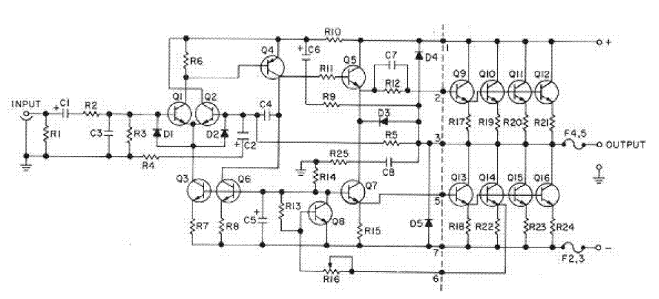

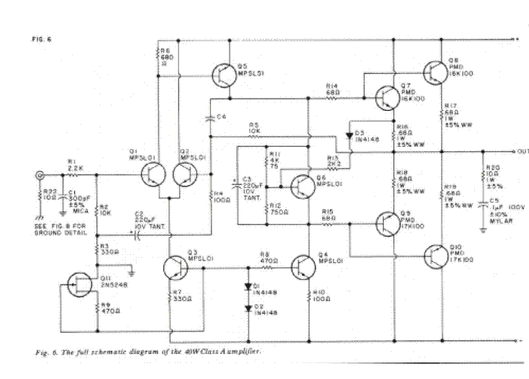

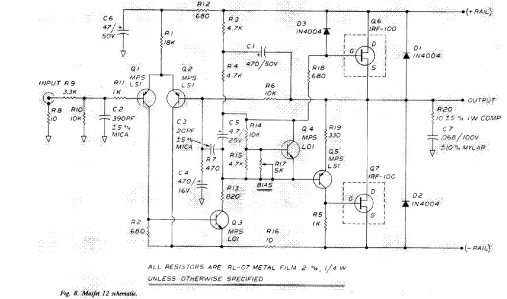

A40 ring a bell ?
editedit
A40 , Aclass , Citation by Papa
just few examples as food for thought - just look at biasing technicues
