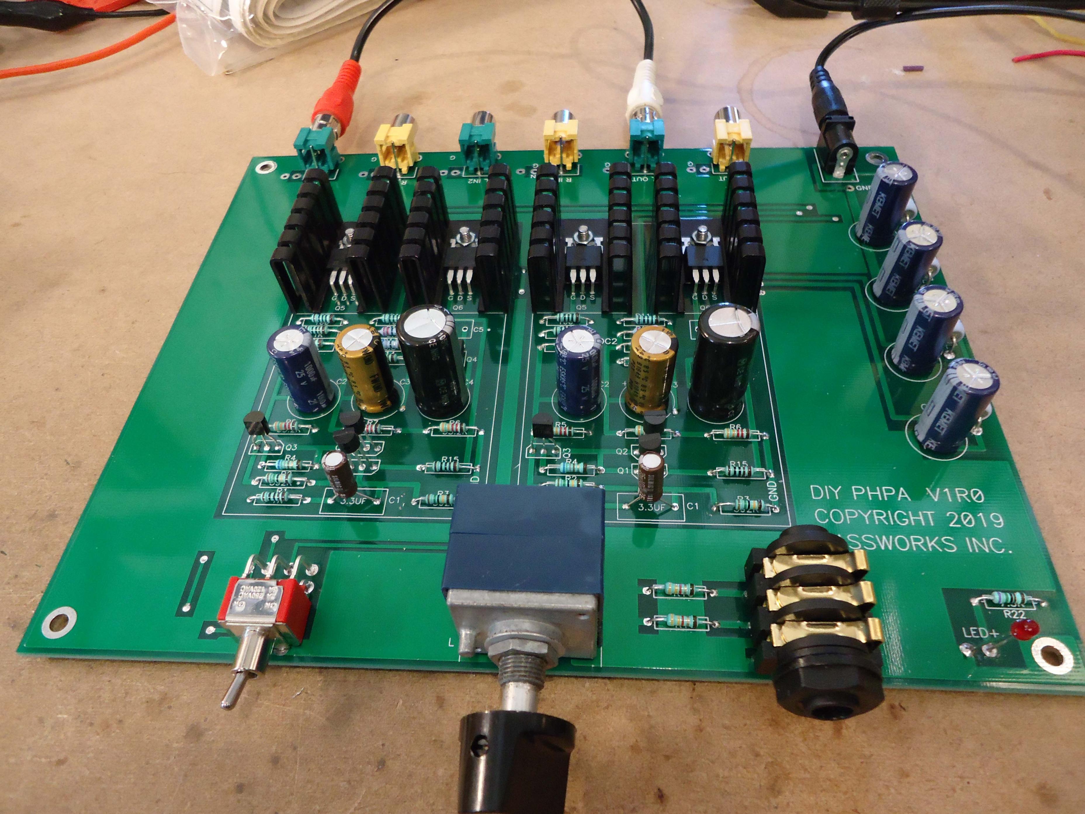

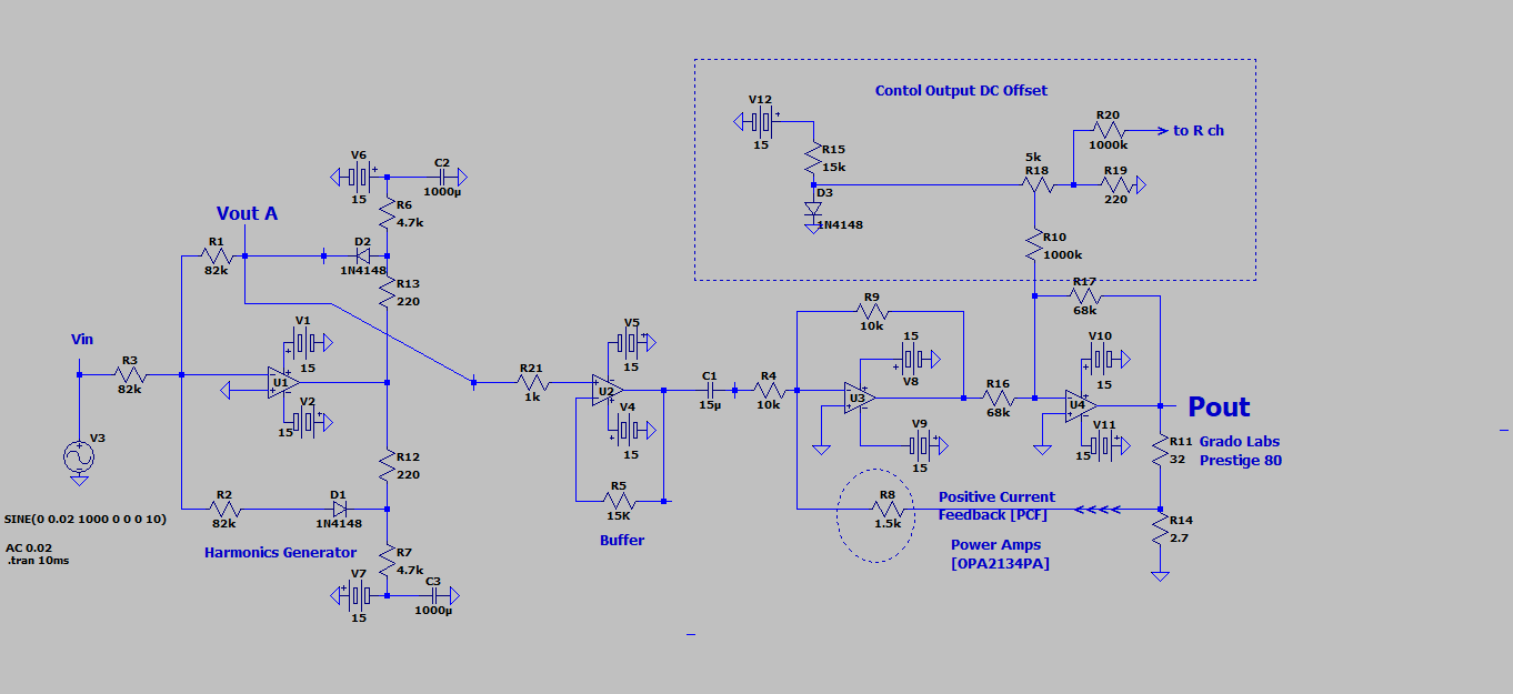

I wish to make the following contribution to the BAF 2019 Workshop.
I have attached a picture of a prototype headphone amp [PHA], and its schematic. It is one-of-a kind. The circuit of PHA embodies H2 negative phase [H2np] and classical Positive Current Feedback [PCF]. Thus; in operation:
1. Music fundamental frequencies are first passed through an OpAmp-based Harmonic Generator [HG]. HG imbibes the fundamental frequencies with their second harmonics of negative phase [H2np].
2. The resultant and favorably-modified music signal is then passed to an OpAmp-based low power output amplifier. This amplifier uses its headphone load in a classical [PCF] circuit.
This headphone amp sounds sweet and is highly detailed. I perceived its music outside the confines of my head; which is probably due to [H2np]. The extent of PCF used affected the 'spectral balance" of the parent headphone output; favorable.
I'll have more details in the Class aP amplification thread.

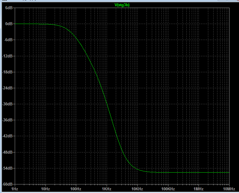

Look more closely, the supply splits into two separate rails after the 2nd RC filter. One rail for the left channel, another rail for the right channel. Then there is a third RC filter on each of these individual rails.
Making a couple wild guesses: Suppose R=0.33 ohms and suppose C is a Kemet "EST" electrolytic, 1000 microfarads, with an ESR of about 50 milliohms, ...
then the "Elmore time constant" (for you VLSI lovers) at the far end of the RC tree, where the active circuits connect to the rail, is 8 * 0.33 * 1000uF = 2.6 milliseconds, very roughly corresponding to a -3dB corner frequency of about 60 Hz. If the SMPS noise to be removed is at 50 kHz, (1000X higher!), the filter will do a great job.
At high frequencies where ESR dominates, each stage will very roughly attenuate by a factor of (0.05 / 0.33) = -16 dB. Since there are three stages in series, the final attenuation will be, very roughly, -48dB.
LTSPICE simulation more or less agrees with these pencil and paper estimates; -3dB at 60 Hz, final attenuation -56dB:
