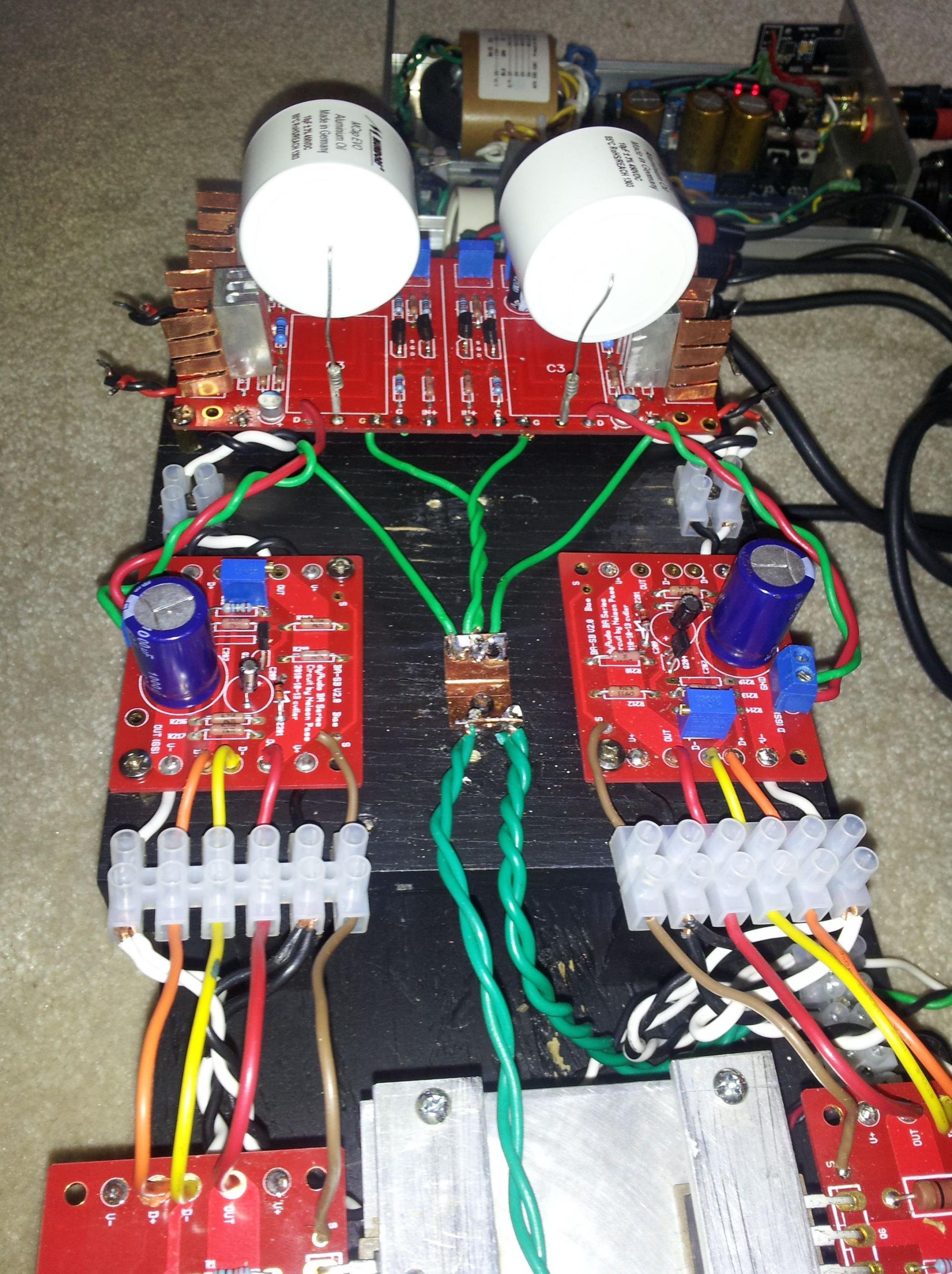

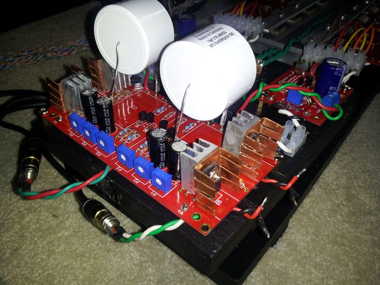

Back to the sound - I just installed the Mundorf EVO-Oil caps. Sometimes it seems like all the circuitry in an amp is there just to support the input cap. The BA-3 really came alive with this implant. The already clean output got even cleaner with more space between instruments and voices. Bass so defined I can almost hear the cycles in pads and electric bass notes. Maybe the most impressive is hearing the extended airy tail on a cymbal hit.
The only thing missing is a little depth of stage, but that may occur after extended use. I'm running the Isotek accelerated burn-in now and expect even better performance later in the day. A very nice cap for a super clean amp.
Note the unusual shape - short end to end - with a larger diameter.
BTW: I used a temporary mount, as on the MyRef FE tuning process, the rotation of the cap(s) produced real differences in the character of the sound. Don't know if that will apply here.

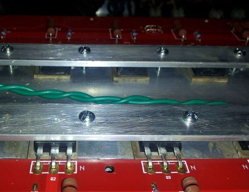

Single ended. I chose it because it was reported to run hotter and I took it as a challenge for liquid cooling. Might have made a different choice had I known how good these sound.
I'll push the bias when I get the outputs on the permanent heatsink.

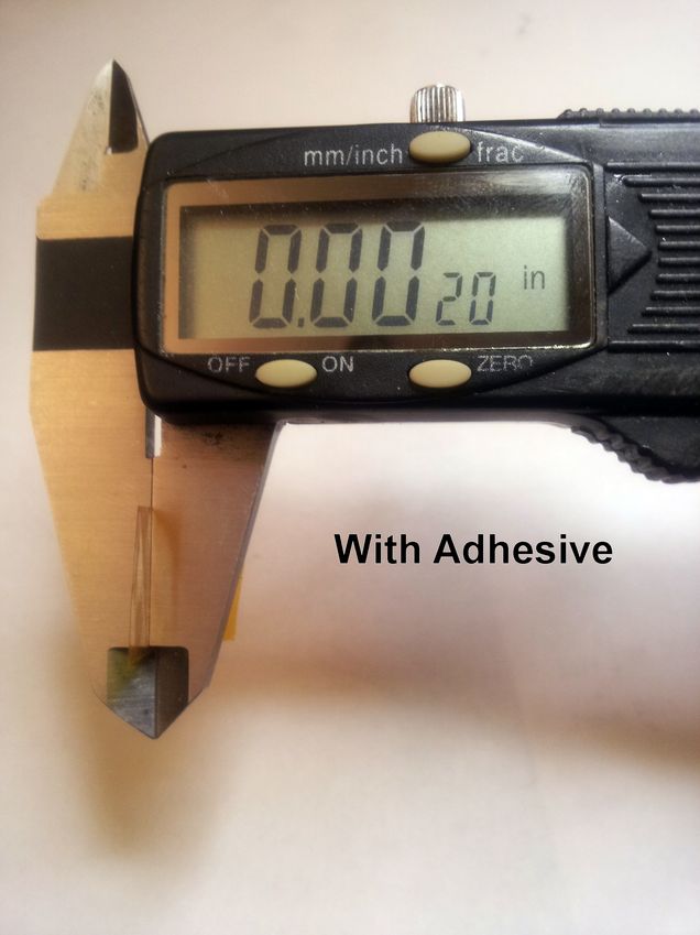

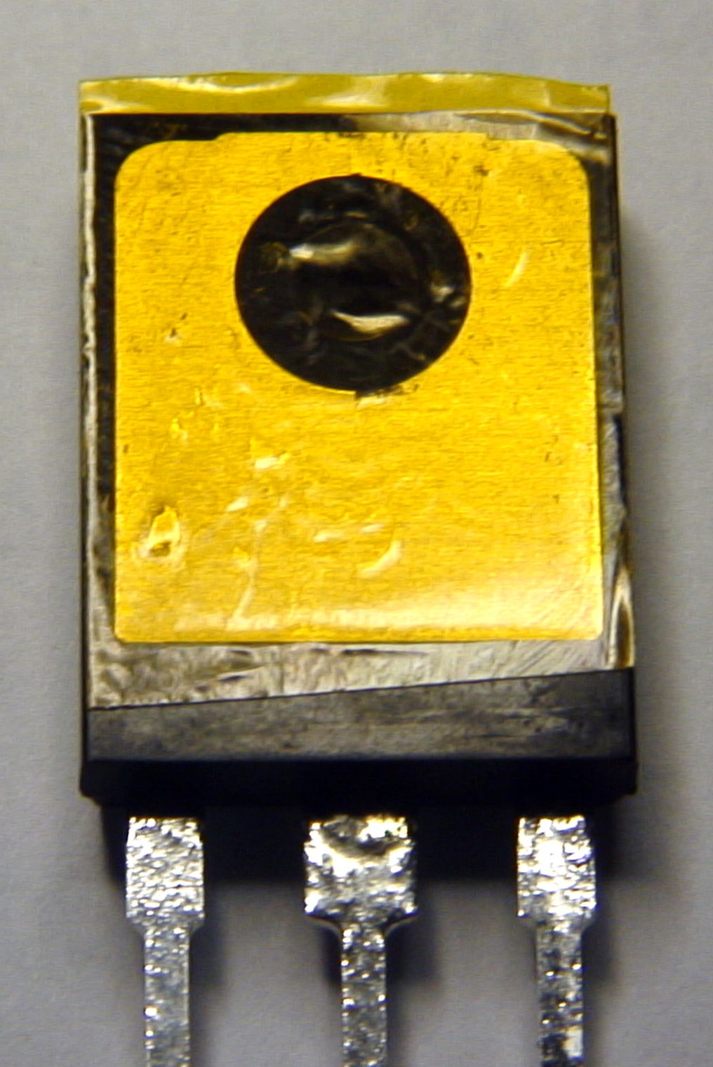

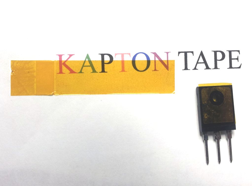

The Kapton is some interesting stuff. It feels thinner that office and package sealing tape. If used with the adhesive, I guarantee there will be no pad shifting/movement. On a piece of printer paper 0.08 mm. it compresses to 0.12 mm with the adhesive on. I'll try some bare when I find the correct solvent. It would be quite easy to trap air bubbles if used without rolling it carefully on the chip. Looks promising.
Listed as 5/8" X 1 mil.
EDIT: $21.18 w/Shipping = 432" / .68" per pad = 635 pads @ $0.033 ea. 😀

Bob,
why you don't use professional pre- cutted Kapton based insulator pads specified for TO247 transistors (IRFP240/9240) which provide already a thermal conductive silicone rubber coating, available from DigiKey, Mouser etc. mentioned already in a previous post.
The DigiKey part number is SPK10-0.006-00-114, or SPK10-0.006-00-90.
These parts are well suited for your application which don't need any additional work as cutting, drilling etc.
The time and money you have spend for your DIY approach is more expensive and contains many risks as buying proven and established parts.
Gerd
GKU, You know how sometimes you get a tune in your head and can't stop singing it? I discovered the tape many, many months ago and it fell into a "I got to try that" groove. I have learned about several excellent pads including Keratherm from the forum store and the pads you recommend (thanks for the stock numbers) - but sometimes when you get an itch, ya just got to scratch it 😉 😀
As you are probably aware, I'm experimenting with liquid cooling amps. Within that process I'm looking for the best combination of efficiency and cost to get the heat from the transistor into the cooler. When I have all the thermal interface options at hand I will do the comparisons using the two FET Amp Camp and/or the F5. That should point to the best solution for a build with up to 24 transistors. There may not be a significant difference between the pads for what I'm trying to do, but I'll know only from some hands-on tests.
Besides all that - There are a bunch of dudes around the threads who have been trying to bust my chops about being too "Romantic" in my approach to this audio/amp/DAC stuff. This way I can counter with - "Remember when I did that science based............" :yell:
More to come.........😀
