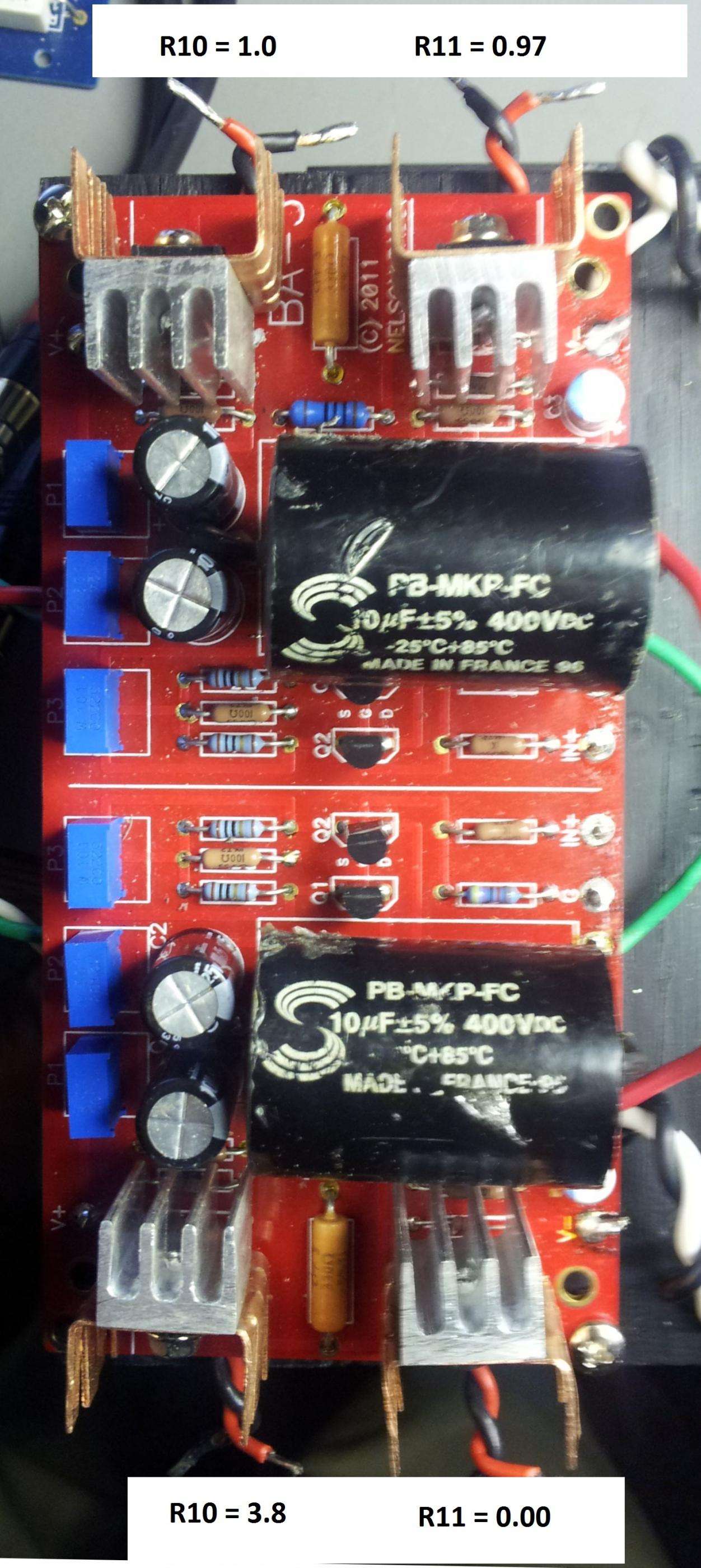

I don't have a BA-3 FE, but according to the article Nelson says... "voltage appearing at the Gate of Q3 is amplified by something less than the ratio of R10 divided by R8..."
So maybe those values (R8,R10...R9,R11) could be altered slightly to get the channels to match. Maybe someone with some experience with it will offer up some good advice on how to proceed.
I believe he is just commenting on the channel imbalance. We did so much work on the bias/output - I think I need to return to the front end and insure it is dialed in. Is there anything I need to pay attention to other than those 1 volt readings at R10 and R11?
Gain of Q3/Q4 of left channel is slightly different than gain of Q3/Q4 of right channel, due to unmatched devices I assume. JFET input stage is unity gain.
So, put in matched output devices for Q3 and Q4 (L-L,R-R) or tweak resistor values. On my BA-1 FE, I was lucky to have a matched pair of J109V's, and matched K2013's I purchased from you buzz (thanks!), image is locked dead center.
Check voltage from D to S on the fet showing 0V. If looking at the face of the fet, it is right two pins. Then check Vgs, by probing first and last pin. Be careful. Dont short the legs. Right now, you have one fet bearing all the current in the output stage. Makes me think that you have a shorted fet. Unplug just to see if anything changes, but I dont expect it to unless you have some mis-wired connection.

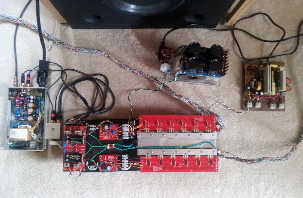

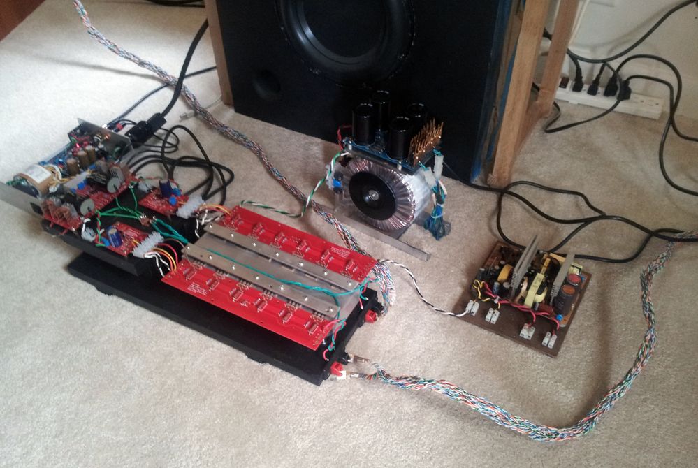

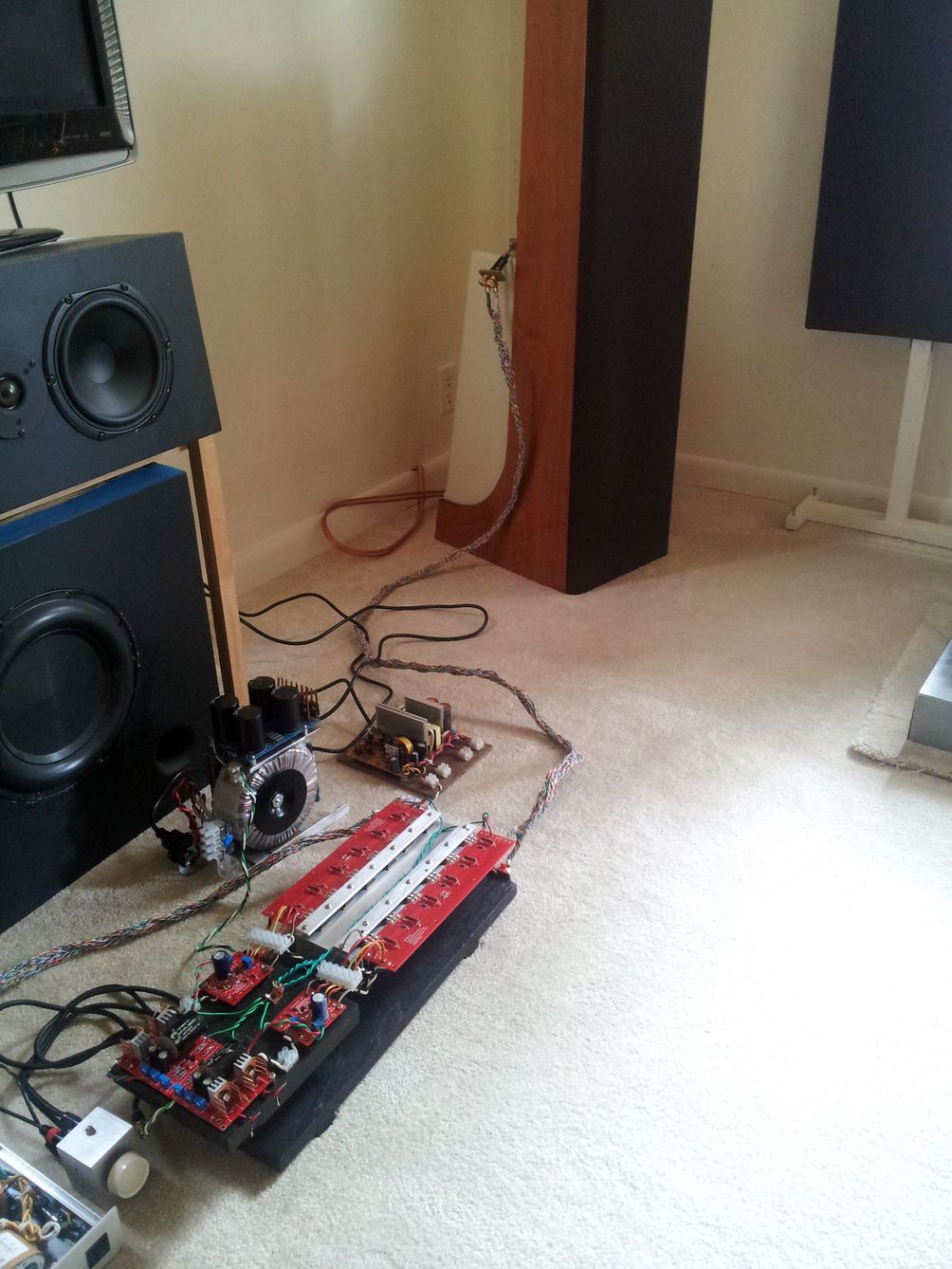

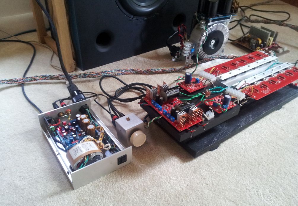

The amp has been playing on the Sunflower speakers for several hours and it sounds great. It'a a PC with JRiver Media Studio 17 feeding a Mini2496 DAC (with D. Inserra's upgrade) - through a DIY Alps Blue pot. The speaker cables are DIY Cat 6 braids.
I honestly expected a lot more volume, but it is close to both the MyRef FE and the Honey Badger. I'm suspecting when a pre with gain is added I'll hear the same super clean sound at higher SPL. I'll probably gain some body - not that there's much lacking now - with the second 500/18 trani, but the transformer sag will probably return when the extra output boards are added.

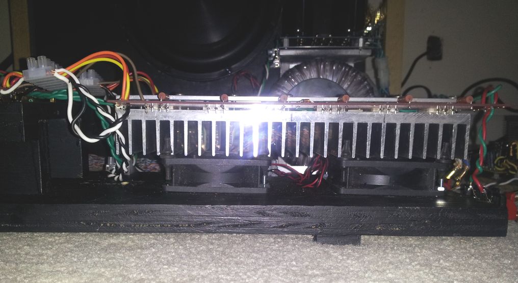

The heat is also going to be much more manageable than I had expected. You guys had me thinking there should be a fire extinguisher nearby just in case.🙂 I put regular (quiet) 80 mm fans under the heatsink and have 60 -62 C on both the aluminum bars and the heatsink. I'll still start with the automotive style radiator for the liquid cooled build, but I think a smaller unit might be enough.
