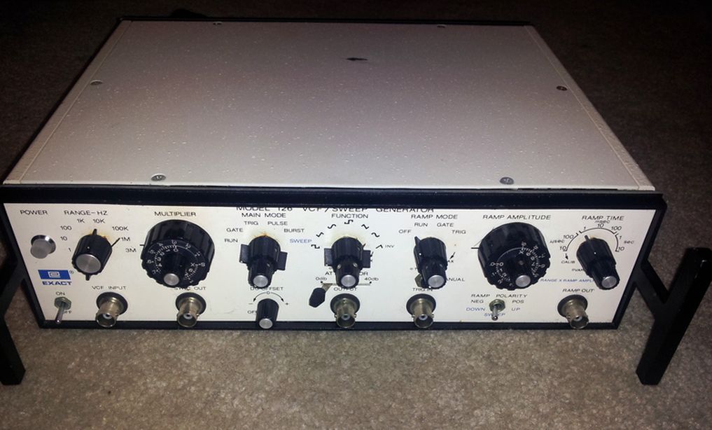

I have a hardware signal generator plus several computer and smartphone sources. I'm not understanding the AC element in your instructions. All prior measurements have been DC. Without going deep into amp theory, can you explain? :deer:

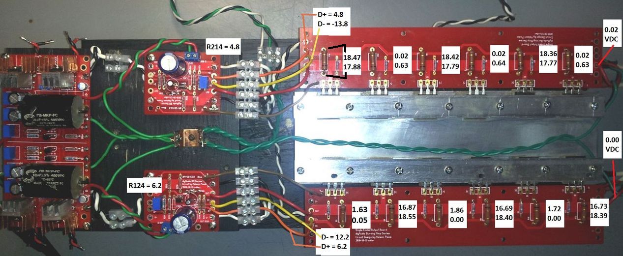

This morning I swapped the front end leads to confirm the channel volume imbalance is coming from it and not the bias or output boards. What adjustments/readings are needed to get that resolved?

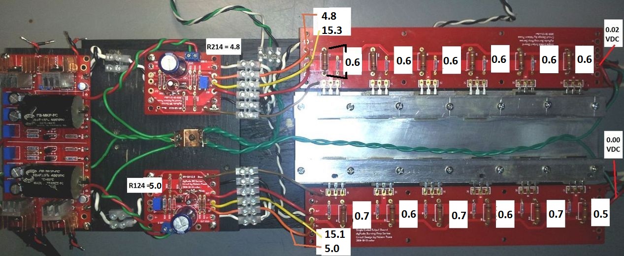

I cleaned up the wiring a bit - but it isn't a very pretty picture. Looks like +6 and - 6 to me.
I am not sure about your numbers. Are these the numbers you measured across the 1R power resistors? Something is not right. Just measure across the resistor. One probe on each leg. I think I get it, but that is the hard way. Your lower board is defintely biased higher.

Those readings were from Gnd to each lead of each resistor. These are across the same large 1R brown resistors. Doesn't the first set show I may have burned some of the FETs with the bad mica installations?
Yes, the 3.0 volt bias readings moved when I adjusted for 0.0 VDC at the "OUT" of the output boards.

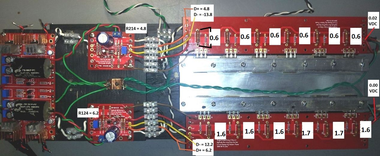

Re-measure the 1 ohm resistors on that bottom output board as buzz suggested. Forget about ground, put red probe on one side of the resistor, black on the other. Should be .6 volts or so, but let's see how much variation there is. You determine current through each by simple ohm's law, I=E/R
... starting bias voltage of 3.0 volts, or 4.5 volts, or any other suggested number means nothing. Correct voltage is whatever it takes to get 0V DC offset. The operating current of the output stage is determined by that bias circuit for the bottom set of FET's, which as I said is basically fixed. When you adjust the trimmer, you are turning the top set of FET's on more, or less, so that the current is equal, result is 0 volts DC offset.
Something is wrong. If those readings are correct you've got nearly 5 amps of current flow. My feeling is something must not be right with that guys bias circuit (for the bottom set of FET's). Are you sure the BJT is healthy and all values are correct, board has no partial shorts, etc...
You guys certainly know your burning amps. :nod:
Readings now much better with new part. Still a little more sound coming from the top channel - but the stereo image is just shifted to the left as opposed to the right channel being almost non existent.
Should I do more readings on the front end, or just try to center the image with P1 - P3?
Just listen and enjoy for a while. THe current sharing on the bottom fets is not the best. You could try switching them around. Just check them every once in a while to see if it improves. If it were me, and all sounds good, I would just listen for a week. Pick it up again next weekend.
