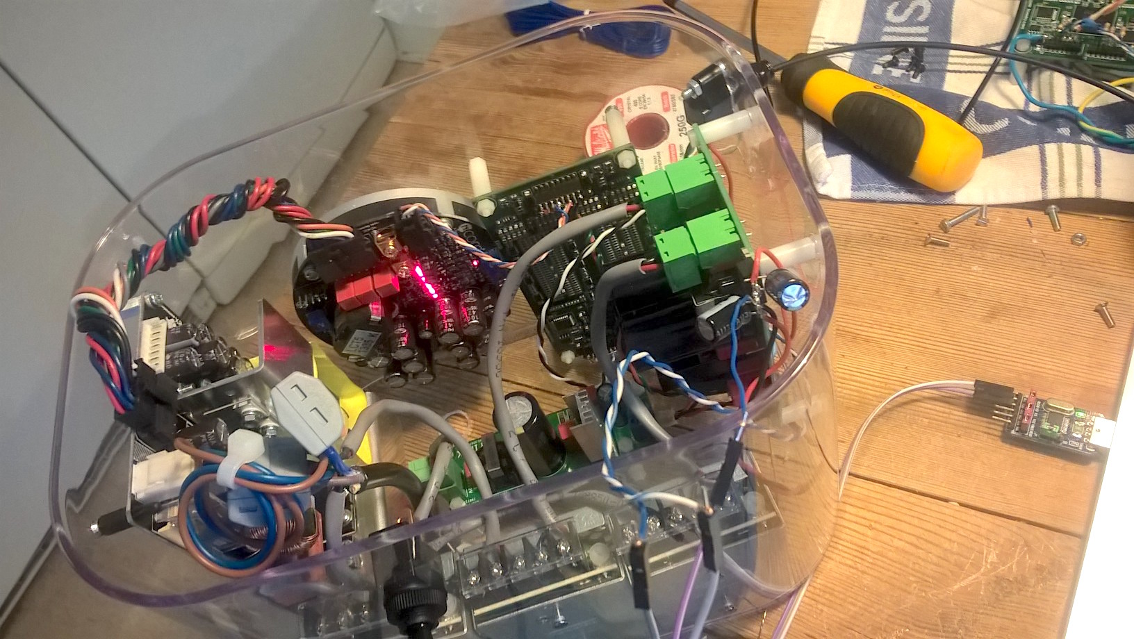

dam1121 uManager Rev 1.08 20160523 FPGA Rev 1.08 Press ? for help.
# set
Conspeed = 9600
Volume = -25
Filter = Linear
Mode = Bal-Left
Needed to set the conspeed to 9,6 in oreder for the yet not connected BT->COM receiver to work.
Close now for first channel.
