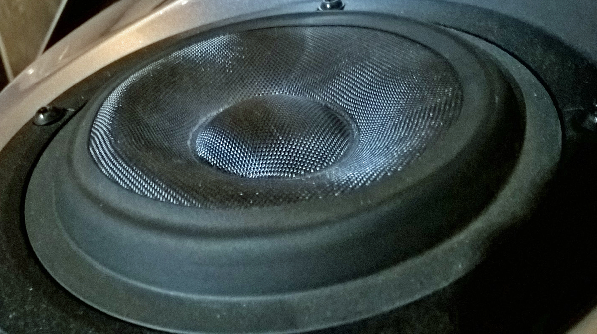

Second model DAM, second set of speakers gone. Started left up - played OK. Started right, got uM connection. R goes bananas at full pelt - no command given. But then, without touching L, L also goes full pelt. Smoke. I will now go sailing 🙂
MacBook -> CoolTerm -> Bluetooth -> BT type1 -> DAM -> NC400 / SMPS600 -> speaker.
The other channel uses BT Type2.
The terminal on Left was empty - no readings/changed state - still it went full volume with result as per picture.
R was in uManager looking like this at the time of the incident:
# set
Conspeed = 9600
Volume = -25
Filter = Linear
Mode = Bal-Right
