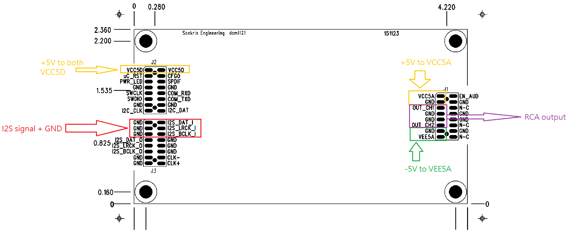

I bought dam1121 few months ago but I could not make it sound. May I know how to make it sound?
What I did is that I provided +5V to VCC5A and VCC5D, and -5V to VEE5A. Then I pass I2S signal to I2S_DAT_I, I2S_LRCK_I I2S_BCLK_I and GND. I connected RCA sockets to OUT_CH1, OUT_CH2 and GND. (see the attachment)
Is this correct?
Do I need to give separate +5v to both VCC5D and VCC5A (now they share the same power rail)
