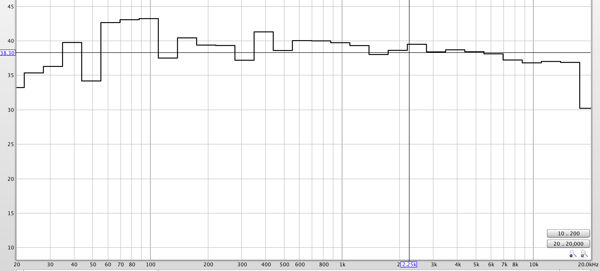

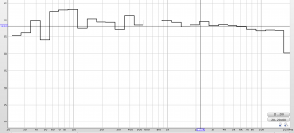

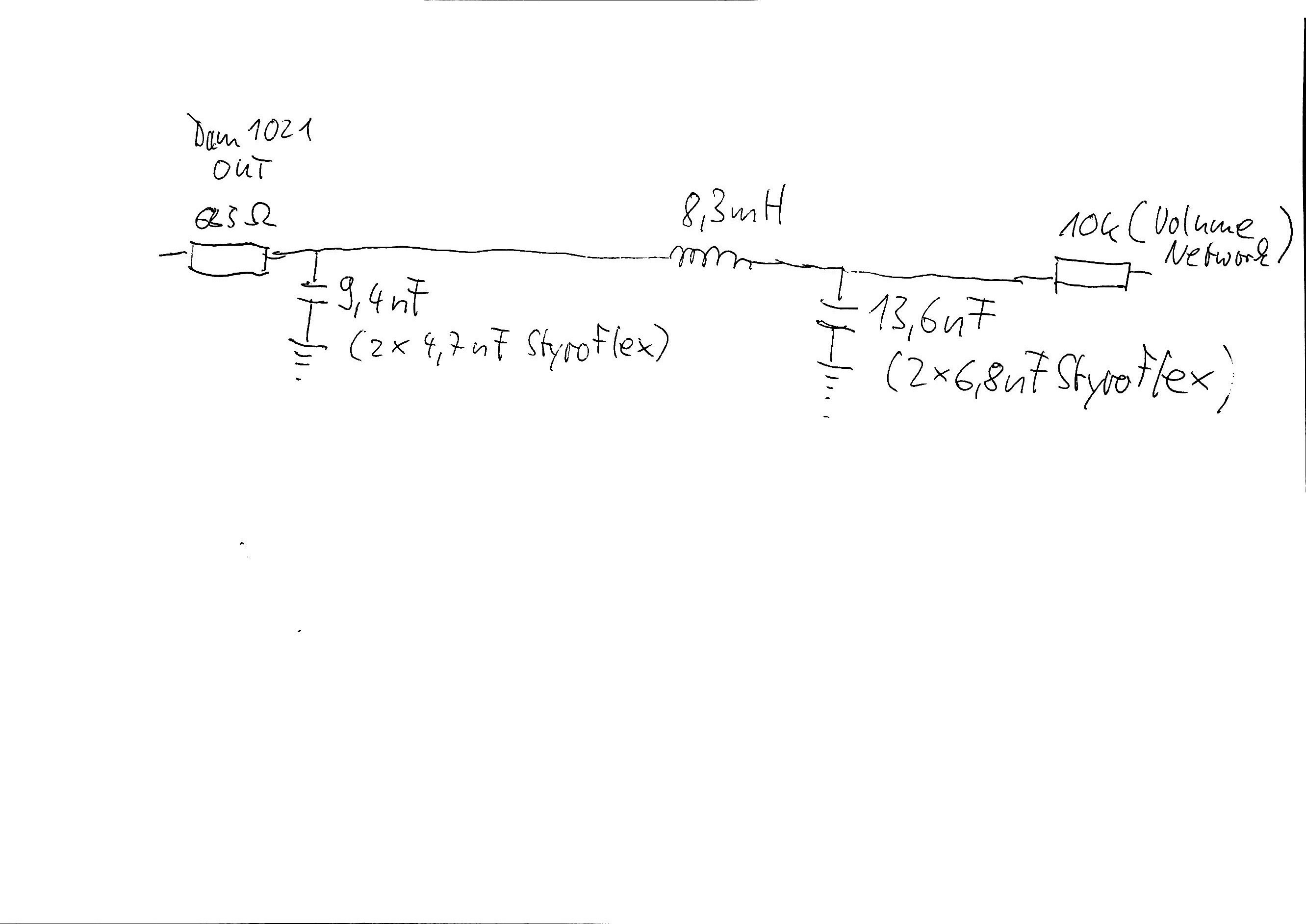

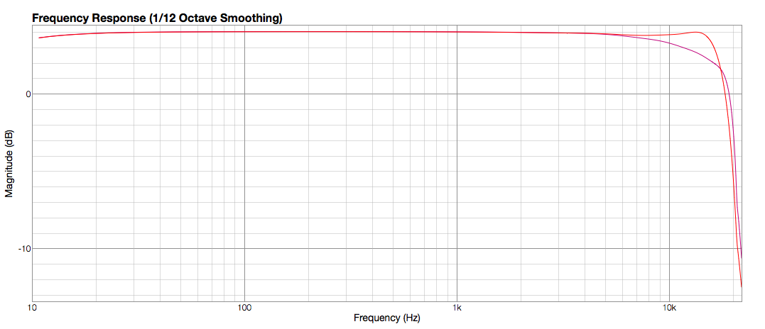

Hi
I was trying out trueNOS on my DAM a few weeks ago, since I never heard a NOS Dac before I was curious about it. I immediately liked it a lot, relaxed and a bit euphonic for my ears. But after a while I found that something is not quite right, just a tiny little bit and hard to pinpoint, maybe the frequency response or the supersonic mirrors.
So I thought, a proper NOS Dac needs an analogue filter, best with a little peak to flatten the HF response.
So I simulated a simple 3 Pole chebychev like lowpass, that would accomplish the task and built it.
Simulation translated pretty well, my implementation rolls of a little earlier, but that does not bother me.
My NOS DAM1021 is now pretty flat up to 15k and -3dB is 18k. My old ears go up to 14k with a sine wave, so that is OK with me.
Simulation says, response is down around 20dB at 40k, but I guess it is more in reality. Does not sound much, but the resulting voltage is only a tenth of the unfiltered voltage, that should take a lot of burden of the following equipment.
Since I use a 10k volume switching network with relays I have a defined impedance that the filter works into.
The capacitors are old Siemens Styroflex, very, very nice caps they are and the inductor is a TDK from a surplus store, I had to test a few to have a more or less matched pair, they where all over the map.
I am listening for a few days now and the sound is great, the compromise seems gone, pure joy. I can listen forever and without a hint of fatigue, which is something I am very sensitive for.
Of course highres files have a compromised frequency response, but 99,9 precent of my material is 44,1 k anyway and if I keep the filter I might make it switchable.
It is cheap and easy to built, I can just recommend to try that out and maybe modify it to your liking if you are a fan of no oversampling in DACs.
First Picture is NOS vs. NOS with the filter
Second one the schematics
Third is the response of both channels in higher resolution
Everything recorded into the analogue input of an old macbook and measured with fuzz measure.
