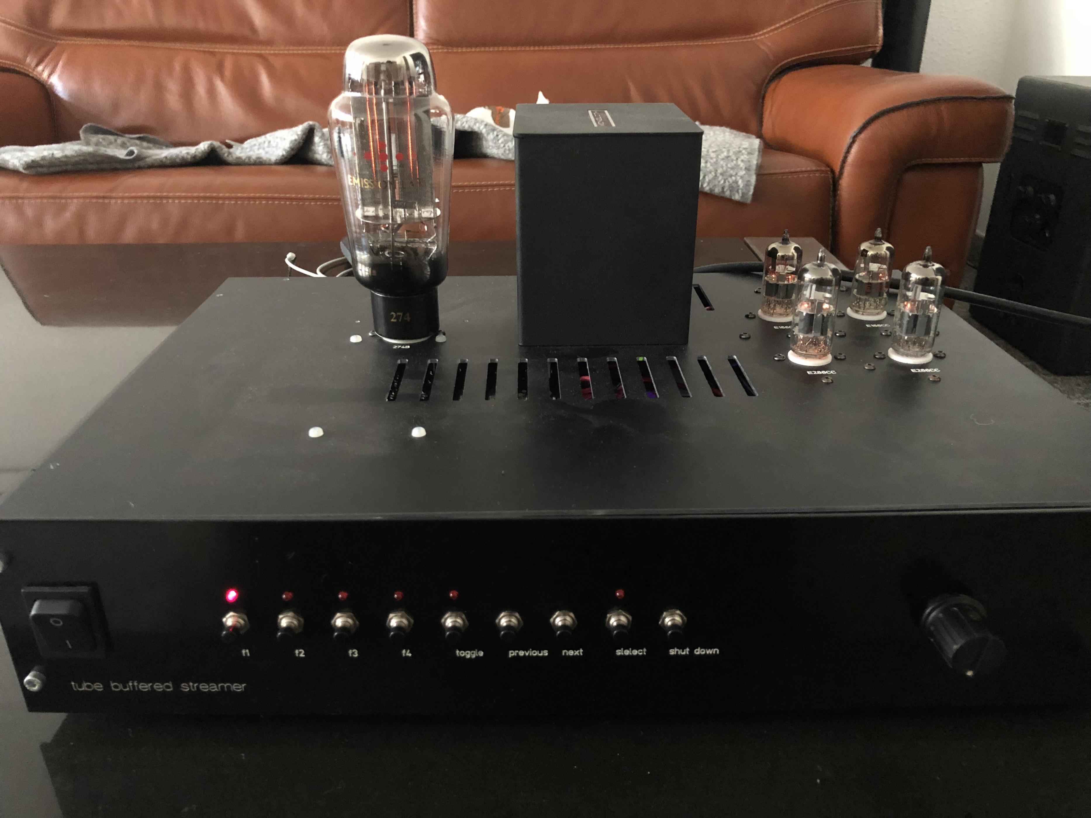

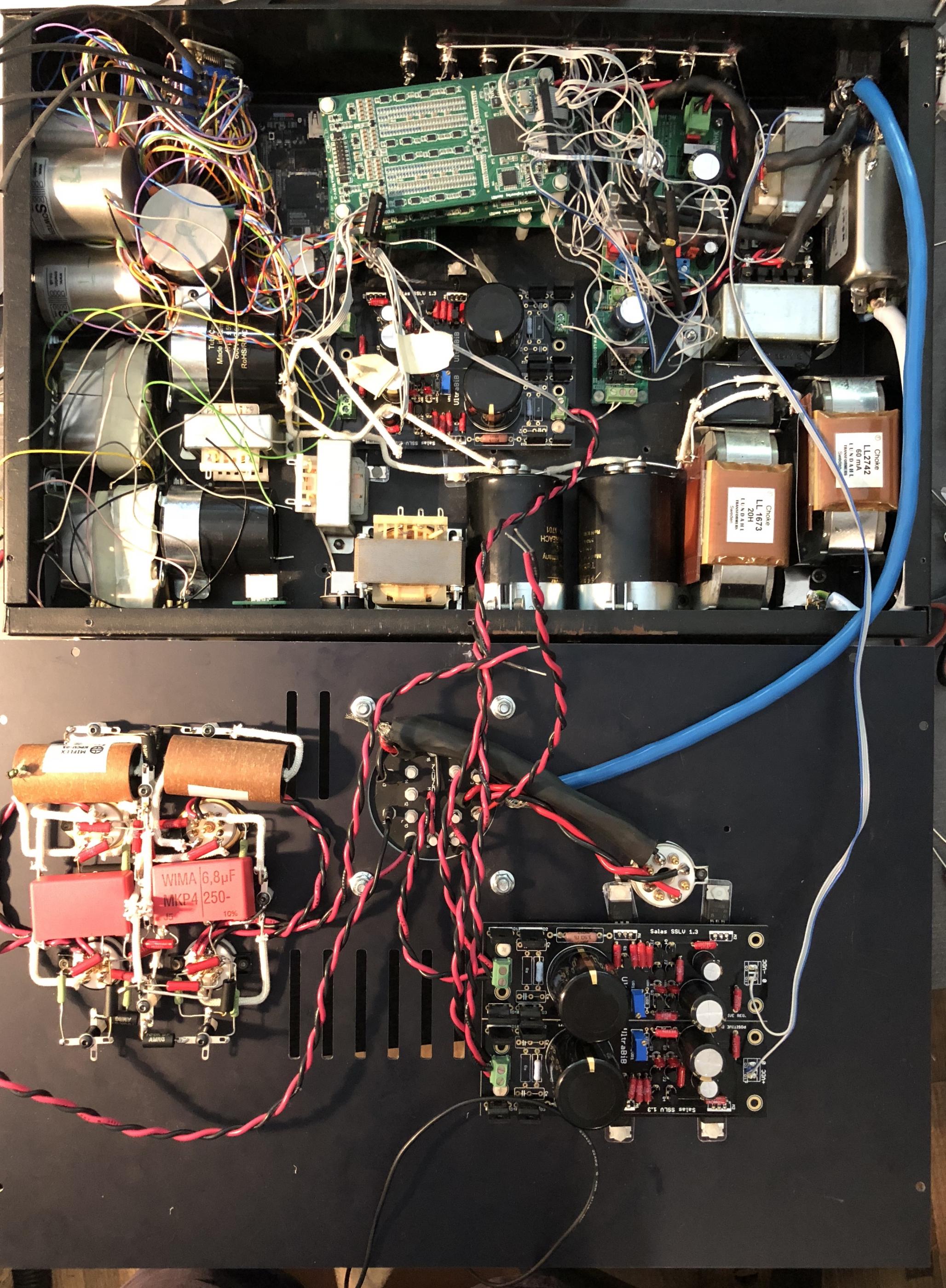

Almost finished,
Beagle one Black -> twisted pear audio hermes and Cronus -> dual mono dam1121 -> geometrical balanced transformer voltage control -> tube buffer (push pull and aikido cathode follower) -> output transformer
Awesome!
Thanks Dimitris. I did have an experience with power banks over AC PS and it still better than the latter.5V power banks utilize switching mode DC-DC converters, so it's not a good idea.
Almost finished,
The cabling from the second UltraBiB to its load is long and thin. (The one placed low in the picture next to a tube socket). Use thicker wire it may prove subjectively audible to the better.

janho,
Are you operating the Dam1121's Synchronously or Asynchronously?
One Board is Master the other one is slave. So I wired it as shown in the dam1121 manual with a buffer between master and slave board.
Thanks Salas!
Being finished with my build, I can say using a Beaglehone Black with the Hermes Cronus combination from Twisted Pear audio was the right choice. Way better than a raspberry pi with reclocker. But there is no good documentation, so it took me really long to finish all this.
And I did have problems connecting the BBB serial with the Dam1121 for changing filter so instead there is a Arduino nano inside that sends signal to the dam1121 and lights a LED for showing which filter is active.
