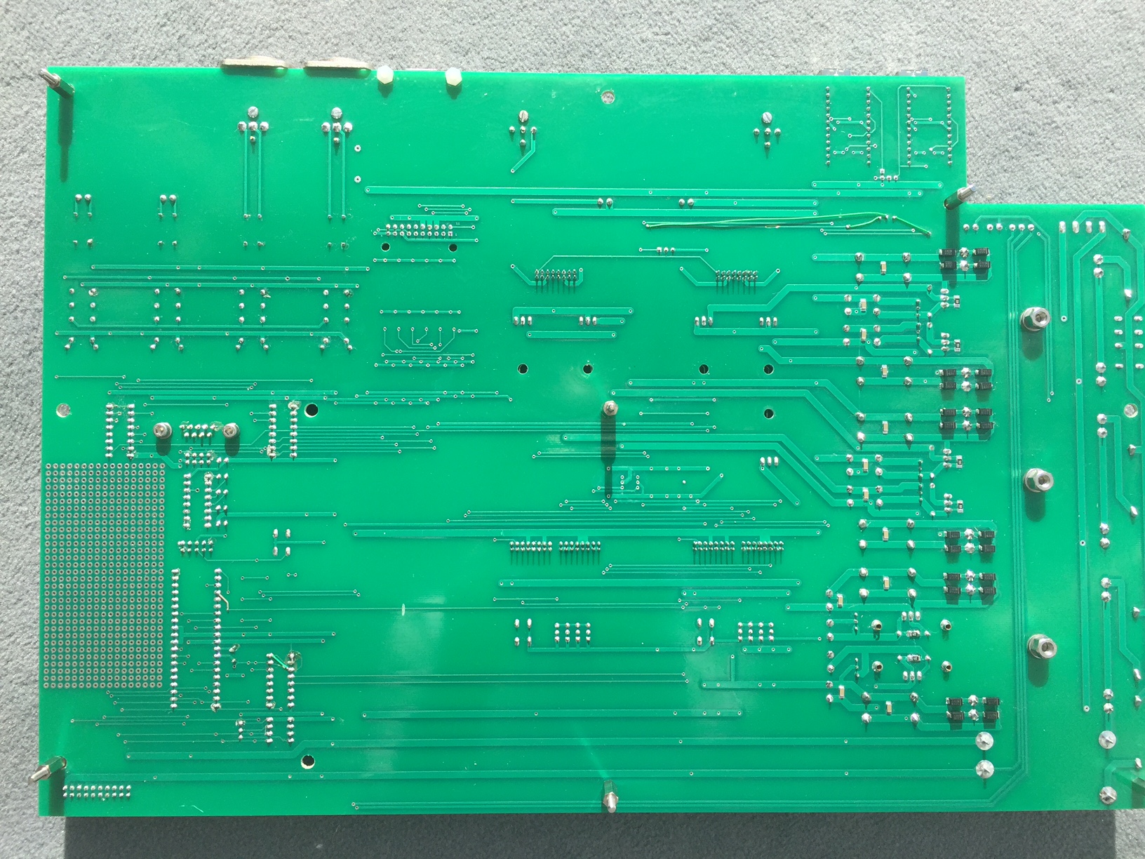

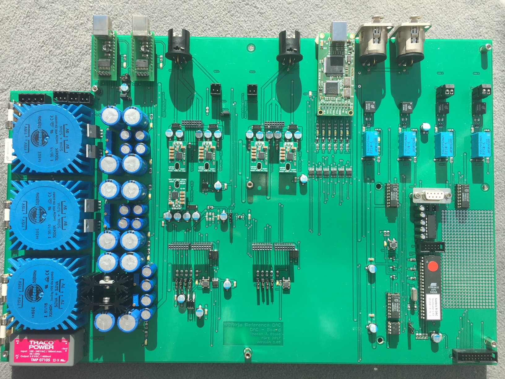

Attached the motherboard pictures for 2 x DAM1121 from soekris, designed as a reference DAC.

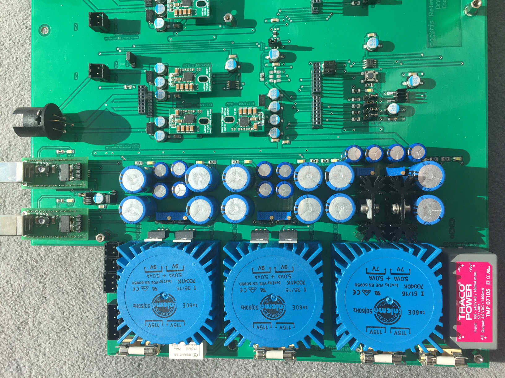

- Analog Power Supplies with low noise shunts
- Digital Power Supply (TRACO) only for the ATMEGA32 controller and Display
- Galvanic Isolation
- RS232 Interface with self designed interface boards
- Amanero Interface for USB
In total 10 add on boards
- 2 soekis dam1121
- 2 USB serial concverter
- 1 Amanero Board
- 4 Shunt's for the Analog dam1121 power supply
- 1 Shunt for the Master Clock Osc
In total 7 Power supply, 6 are designed Analog, keep the right and left channel separated
This is a SMD Board, not easy for DIY, Schottky Rectifier on the back of the board.

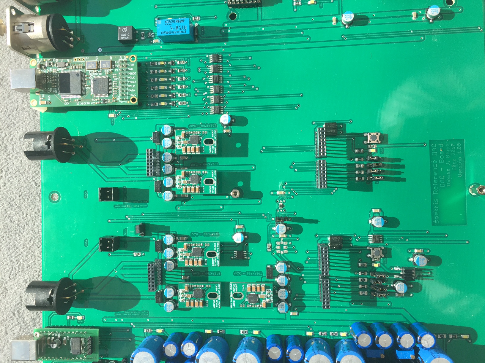

Soekris dam1121 not shown, but you see the Samtec connectors
Board is 99% working, known bugs:
- Master Slave RS232 communication /wired on the bottom
- Silab570 Master Clock missing, will be added if slab is delivered
- ISO 7220 Isolator are to slow for the Amanero serial stream, will be upgraded as soon as delivered new faster ISO's, pin compatible)
- Low noise board are from a friend in Saudi Arabia
Board will be updated to version 1.1 in about 4 weeks after final testing
Attached the big resolution pictures

Looks nice... but board seems unnecessary large for whats on it?
should be easy to make the board quite a bit smaller i would think?.. that would primary save alot in production cost.... otherwise the idea is great i have to say.
By the way what is the size right now?
Thanks for the feedback, size is really large 402 mm x 271 mm, was never planned for "mass production", for a single unique piece size is OK, but fits to the hifi 2000 alloy encloures with only 40mm height, will give a nice reference dac

The dam1121 check if external Si570 oscillator is present, if so it will use it and disable the internal oscillators.
The dam1121 is picky on the Si570, it need to be 3.3V LVDS, I2C address 0x55, startup clock 10 Mhz, OE Polarity active high, and it can't be the 20 ppm stability version....
You can look up p/n at Clock and Oscillator Design Services | Select Base Part
570BAA000112DG is fine.
Update: Finally the Master Clock arrived, installed over the weekend and the 570BAA000112DG just worked fine. The balanced DAM1121 in Master / Slave Mode is a incrediable audiophile DAC, just a few minutes of listing gave really a new level in experience. Do hope that some of you got the chance to visit soekris engineering at the Munich High End 2017 and listen to the DAC 1541 all in one DAC, very very nice audiophile DAC for a excellent price tag.
