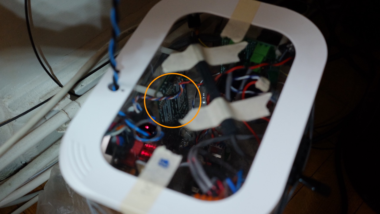

Second model DAM, second set of speakers gone. Started left up - played OK. Started right, got uM connection. R goes bananas at full pelt - no command given. But then, without touching L, L also goes full pelt. Smoke. I will now go sailing :)
MacBook -> CoolTerm -> Bluetooth -> BT type1 -> DAM -> NC400 / SMPS600 -> speaker.
The other channel uses BT Type2.
The terminal on Left was empty - no readings/changed state - still it went full volume with result as per picture.
R was in uManager looking like this at the time of the incident:
# set
Conspeed = 9600
Volume = -25
Filter = Linear
Mode = Bal-Right
Well, I think I should update on this. It is now obvious that I had not strapped the DAM in a correct way. So for the record - this was most probably my fault.

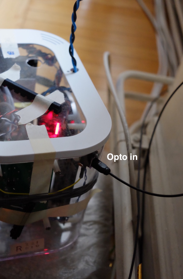

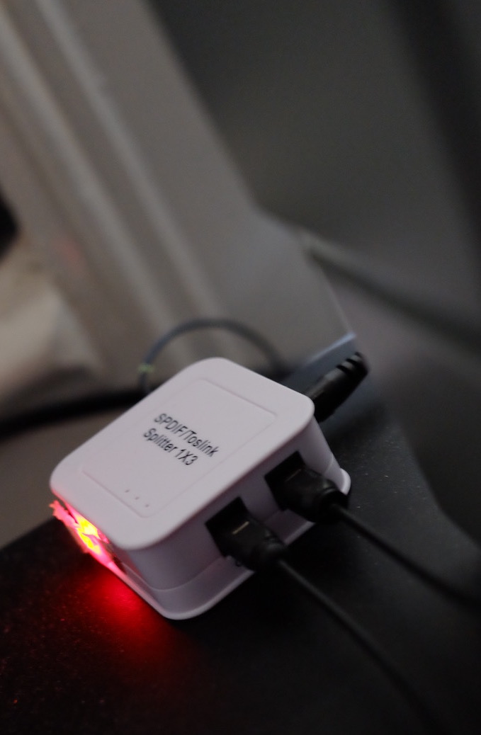

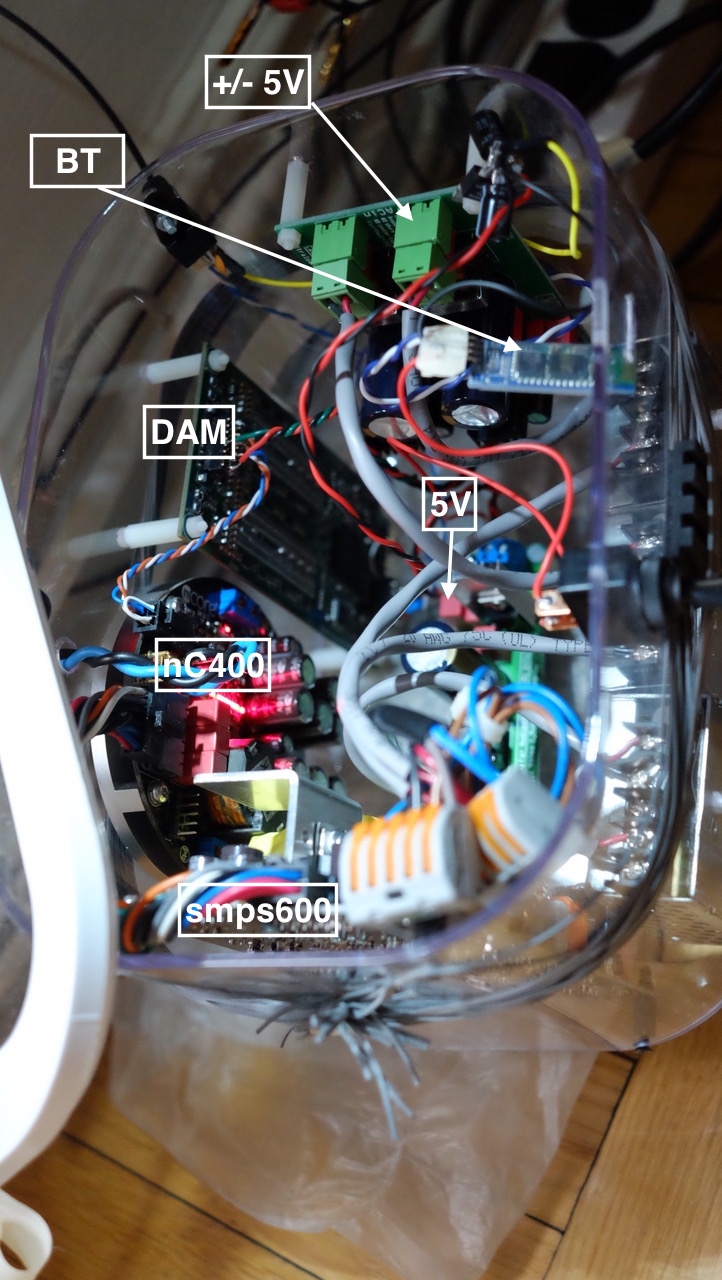

Presenting my use of the DAM 1121. I choose it because for two major reasons. Size and the re-clocking after the FPGA.
Each box (2) is composed by:
# 1 DAM-1121
# 3x Meanwell RS-15-15
# 1,5 (one bord split in half) Diyinhk LT3042 based 0.8uV Ultralow noise DAC power supply regulator 3.3/5/7V 1.5A*x2 (DAM needs 3x 5volt supplies). I cut/saw one in half.
# 1 TPS7A47 based 3,3 volt regulator board for Toslink receiver.
# 1 Wireless Serial 4 Pin Bluetooth RF Transceiver Module RS23 HC-06 with backplane (ebay)
# 1 Toslink receiver - Toshiba TORX147L TORX147 15Mbps Fiber Optical Receiver 3 pin x 1PC (ebay)
# 5 meter Toslink cable
# Active Toslink splitter - White SPDIF TOSLINK Digital Optical Audio 1 x 3 Splitter (1 Input 3 Outputs) New (ebay)
# 1 Hypex nC400
# 1 Hypex SMPS600
I feed these from a Squeezbox Touch via the toslink splitter using the SB volume control. DAM gain is set to -14 this s till gives enough level.
Plastic box, nylon standoffs and div cables etc.
Design requirements:
- Absolutely shortest analog path length
- No life sucking metal housing
Result: SQ is superior to all other combination I have had previously (don't they all :) ) Particularly dynamics is excellent. It scare you sometimes which is a good sign. Very good hight and space but still focused. Musical :)
Recommended.
