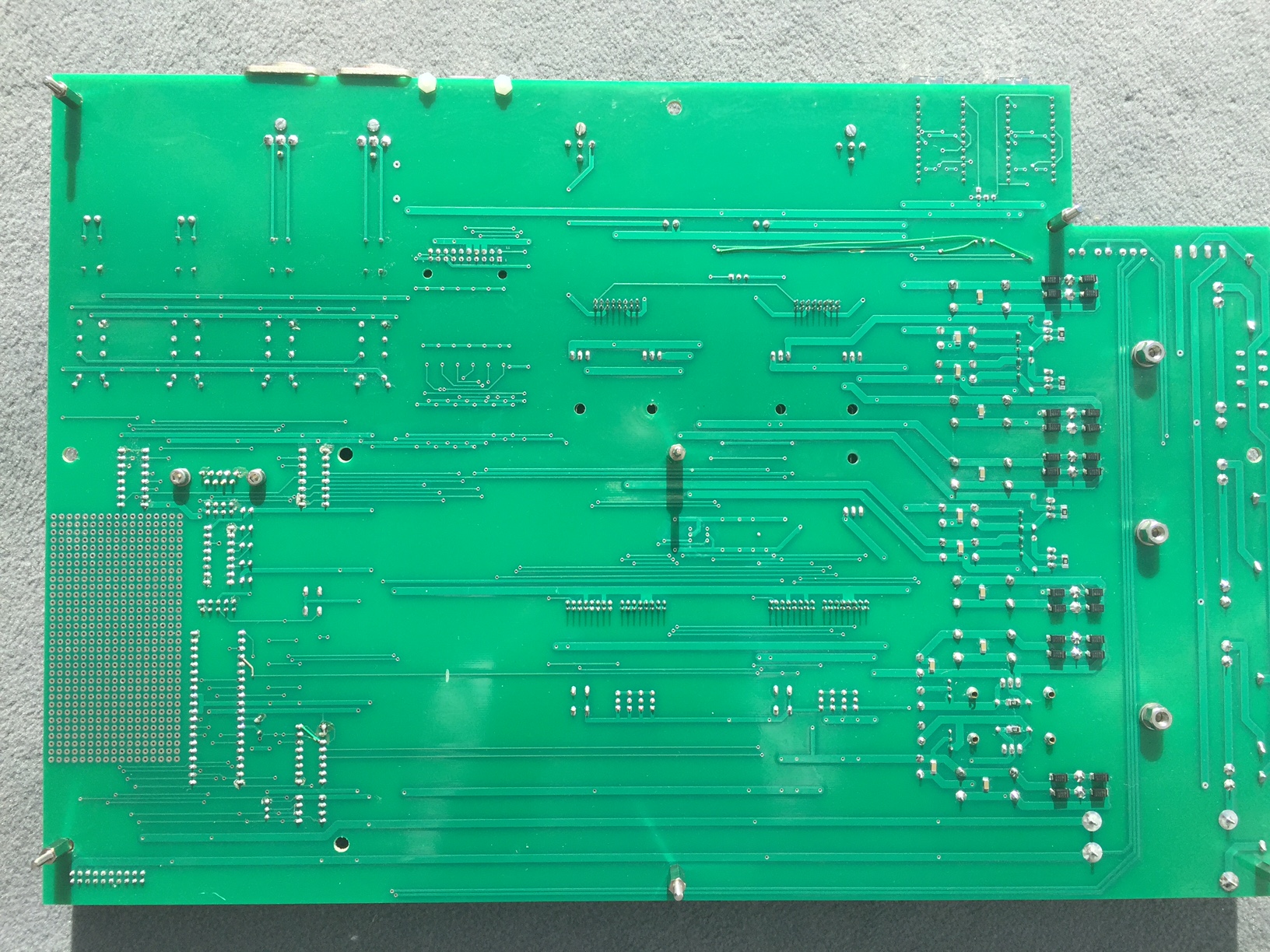

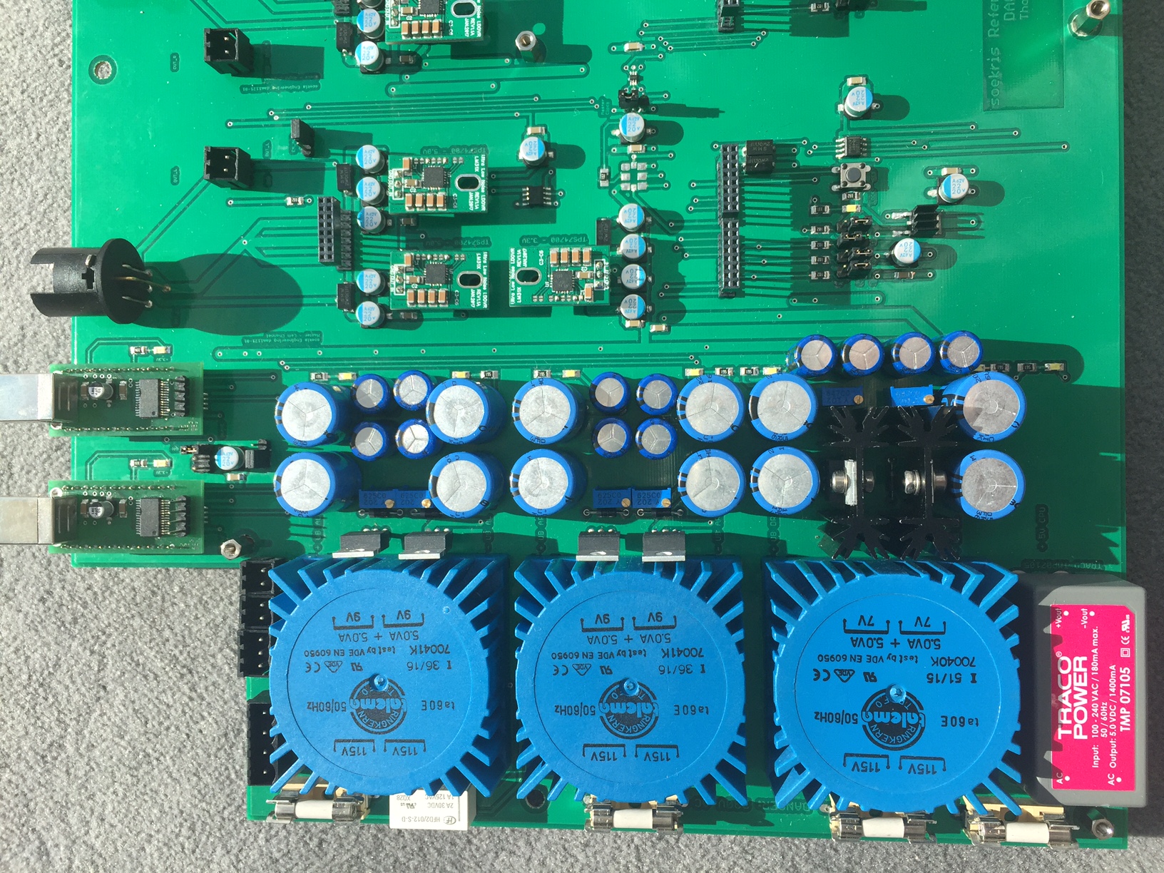

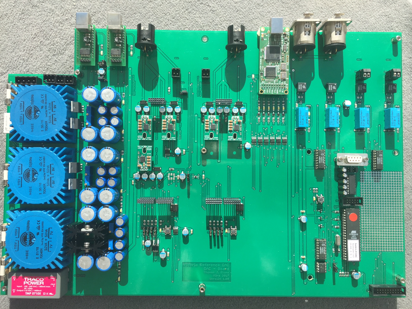

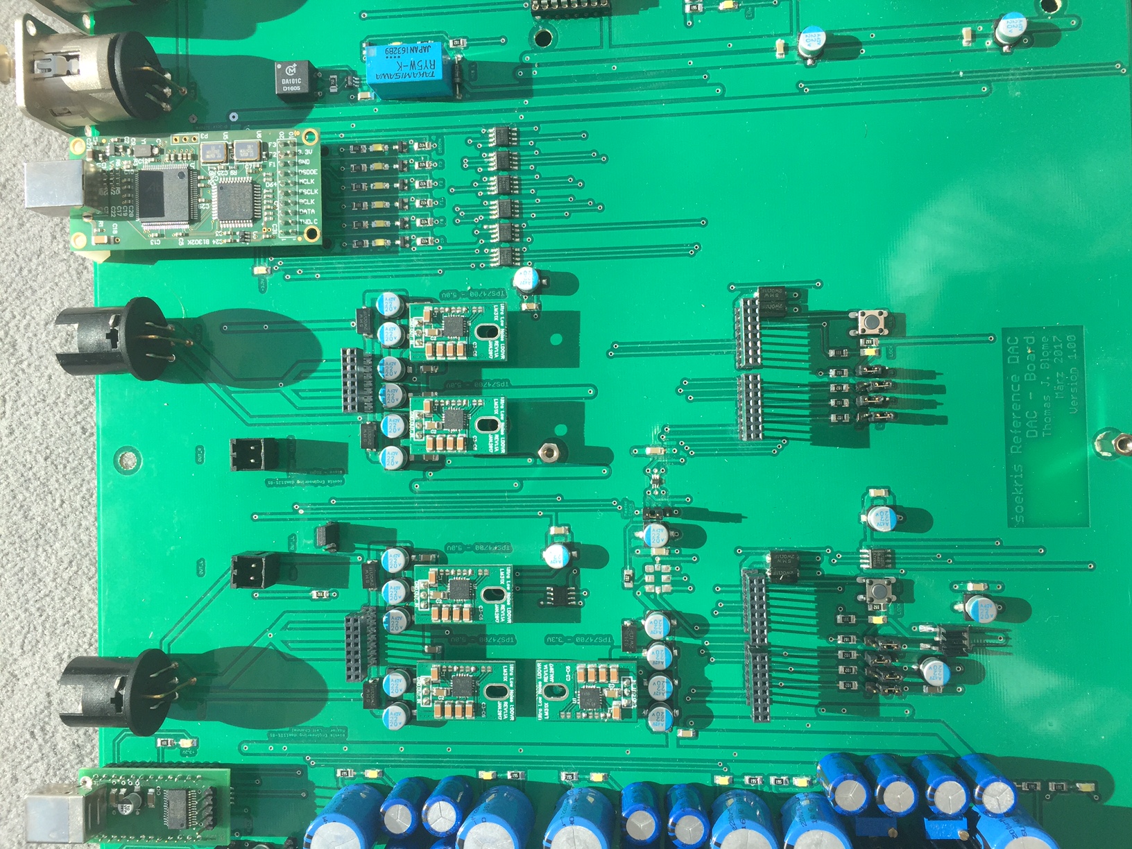

Soeren, made a semiprofessional motherboard for the dam1131 in balanced mode, just testing, works for 99%, a few bugs still needs to be adressed,
not critical, designed in Eagle PCB, if interest could share some pictures and the files. Best regards
Attached the motherboard pictures for 2 x DAM1121 from soekris, designed as a reference DAC.
10 add on board as options:
- Analog Power Supplies with low noise shunts (5 add on boards)
- RS232 Interface with self designed interface boards (2 add on boards)
- Amanero Interface for USB (1 add on board)
. 2 soekris dam1121 (known shown, but you see the Samtec conntectrs
Basic design
- 6 Analog powers for the soekris dam1121, left and right side completely separated
- Digital Power Supply (TRACO) only for the ATMEGA32 controller and Display
- Galvanic Isolation
Display board not down, will publish picture later if needed
This is a SMD Board, not easy for DIY, Schottky Rectifier on the back of the board, designed in EAGLE PVB and manufactured by multi PCB, two sides only.
Board is 99% working but still in development, known bugs:
- Master Slave RS232 communication - see wires on the bottom
- Silab570 Master clock still missing, will be added if slab is delivered
- 2 ISO 7220 Isolator are to slow for the Amanero serial stream, will be upgraded as soon as delivered new faster ISO's, pin compatible)
- Low noise board are from a friend in Saudi Arabia
Board will be updated to version 1.1 in about 4 weeks after final testing
Attached the big resolution pictures
