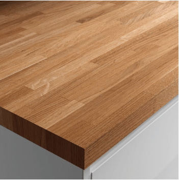

It doesn't really matter if its laminated (like this) of one big board - it moves with moisture. Moisture as in humidity and its changes throughout the year. As long as you understand that, and build accordingly you can selectively use it. Would I use it for a front or rear baffle? Not typically. You could use it for sides, top and bottom with the grain all running in the same direction - as in around the cabinet - so that any movement is consistent (it'll be front to back). That also means no cross bracing to restrict the movement. If in doubt, use your library (or Google) regarding proper ways to make solid wood furniture (a chest of drawers is a good example) to understand the pitfalls.I've read the whole thread and though it's informative I don't get a clear consensus about the various forms of solid wood. I have some left over kitchen worktop 26mm thick, which I believe is oak. It's been doing nothing for several years and kept indoors so it's perfectly dry. I'd like to use it for a pair of 2 way speakers.

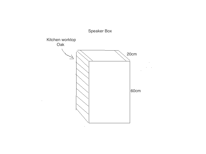

Can anyone assess how suitable it would be for a speaker cabinet? Pic attached - I'm sure this is a familiar product.
Ah - I see you are calling the wood I pictured "butcher block" which I suppose is another term for it. I bought it as "kitchen worktop". Looks like the same thing. As far as I can see the joints have remained solid. It's 26mm thick. I have enough for the sides and back. Not sure about the top and bottom which might have to be something else. I would make a window frame brace around 2/3 down.Andy, butcher block which is what you want, as long as the glue joints are solid. How thick is it?
dave
My intention is to put the tweeter on top, like B&W designs. Then make a removable front which could be changed for different bass units I might want to try. The tweeter could go on that as an alternative. My plan is to attach the front with 19" rack parts - some compact 90* angle frame and the M6 inserts which means I can use M6 screws to fit and remove the front easily. I was thinking about 16 litres which would work for 165mm or 150mm mid-bass units.
I haven't seen any comments about using 90* steel angle to attach top and bottom. All the interior joinery traditionally seems to be wood. Any reason why L shape steel would not work for attaching parts at right angles like top and bottom?
The wood pictured has been indoors in my flat for several years and would remain so, so I imagine it's pretty settled in a fairly uniform environment. How careful do I need to be about putting a window brace in it? Are cross braces a better alternative? Or no braces, which would be a shame?

Those worktops are made of laminated hardwood staves, and the staves themselves will probably be finger-jointed. It's often referred to as butcher's block, but that's using the term loosely. (Strictly speaking butcher's chopping blocks have normally been made with vertical grain staves, so the end grain is exposed on the top.)
I wouldn't think angle steel would work too well. As is mentioned earlier in the thread, there's an issue with ferrous metals causing staining. Also it's not going to move along with the movement of the wood - laminated hardwood will still contract and expand a bit, just like any other hardwood.
For a similar reason, I'd suggest using the worktop for sides, top and bottom, if there's enough, because then the grain can run the same way on all the pieces, and any shrinkage or expansion will be in the same plane, and is less likely to cause failure. I'd also be wary of a horizontal window-frame type brace - at least, you'd want to use the same material, with the grain running in the same orientation, or it would be in conflict with the movement of the hardwood. Maybe a vertical frame-type brace would be safer? And I've never been a fan of tensioning rods, I'm afraid. Normally my instinct would be to use bituminous damping pads, but to be honest the worktop is so think that they probably won't do much.

Using the photo of his laminated board as an example there will be no movement along the board's length, which is why it could be used for sides, top & bottom with the grain running 'up' the sides and 'across' the top and bottom. There will be marginal movement in the thickness dimension of the board. The greatest movement will be across the board's width which is why it shouldn't be used for a front or rear baffle. That's also why you shouldn't use a window frame style brace fixed in place across solid (which his board effectively is) sides.The crux seems to be that the shrinkage is different in each dimension, and with a glued box it's very hard to avoid any joints with unequal shrinkage rates.

You may discount the movement, thinking a finish will prevent it, but you'd be wrong - it just slows the moisture absorption and release down.

I have enough kitchen worktop for the cabinet shown, just the 4 sides with grain front to back. I have a bit left over but it would only do a top or a bottom, not both. So seems to me I should use something like 25mm MDF for the top, bottom and back. Does that look OK? I doubt if I can get any similar offcuts but anyway they'd be fresher and mine are years old.
This breaks my first rule of bracing: the aspect ratio of the subpanels created by the brace should have a higher aspect ratio than the panel being braced.

I'd be a little anxious about orienting the board that way. If it moves, it's the height that will be most likely to change, and that would surely stress the joins to the other boards. Maybe, though, you could build complete boxes of mdf/ply and then attach the worktop as cheeks, using a compliant fixing of some sort? It could be almost Sonus Faberish, if you wanted. If you used viscoelastic adhesive, such as some of the 3M tapes, you'd even get a CLD effect, maybe.I have enough kitchen worktop for the cabinet shown, just the 4 sides with grain front to back. I have a bit left over but it would only do a top or a bottom, not both. So seems to me I should use something like 25mm MDF for the top, bottom and back. Does that look OK? I doubt if I can get any similar offcuts but anyway they'd be fresher and mine are years old.

Good to get the thumbs up from Dave. I did think of attaching the worktop as side cheeks and could still do that.
I didn't quite get the pictures of bracing options. Which were better and why? I just pulled 2/3 out of the air to avoid putting it half way but maybe that's wrong.

bracing options
In the case of a box taller than wide and deep the brace(s) should run vertically.
