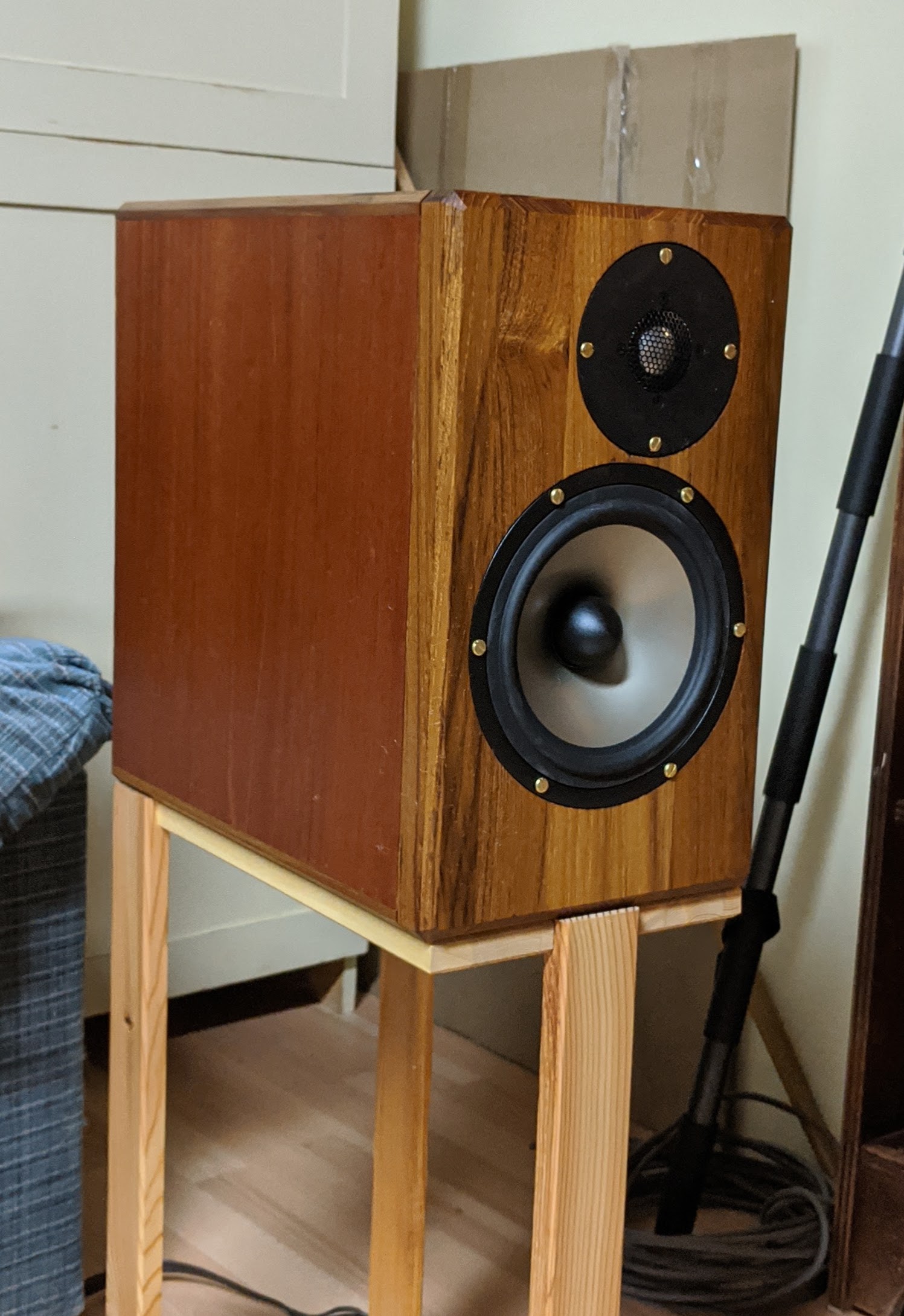

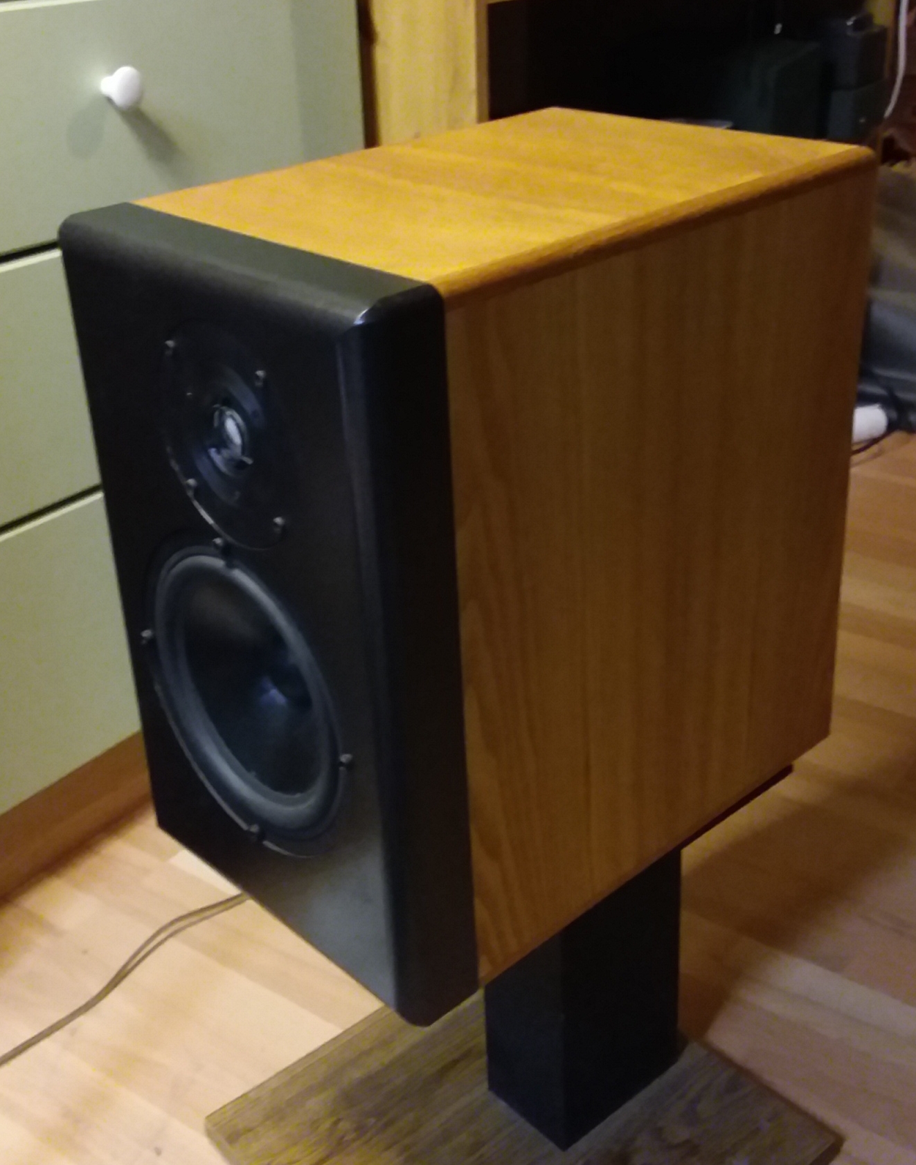

FYI, the speakers pictured with 'real' wood baffles aren't solid - they're 'thick' (1/4") veneer on MDF. The teak baffle was MDF trimmed all around with solid teak, and then overlaid with the think veneer.

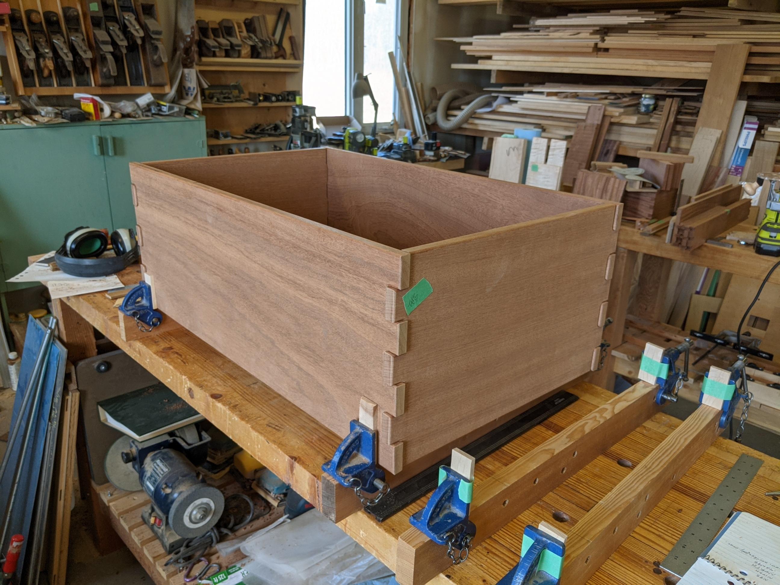

I included a picture of a chest with massive finger joints to show a joint you don't want. It's a commission I'm currently working on.

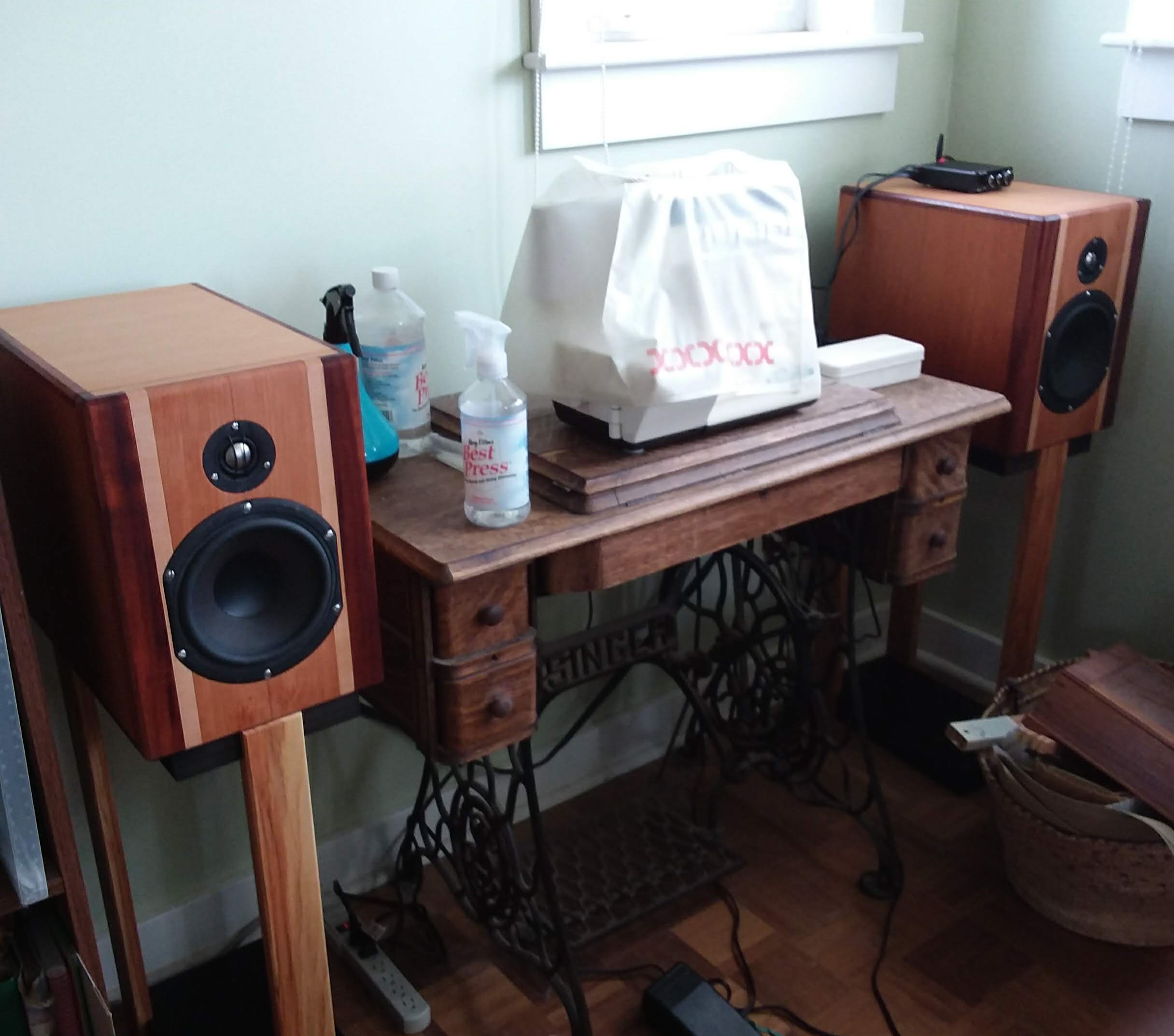

Real wood can outperform MDF if you use the right techniques and wood. This is because (IMO) MDF is not well suited for loudspeakers.
These handily outpeformed the same in MDF (not a high mark to jump over) — now if we could just figre out how to dramaticallt harden the outer layer, they bruise easily (Western Red Cedar — vert stuff, very light, actally a softwood, has also been found to make very good tonearm wands).
