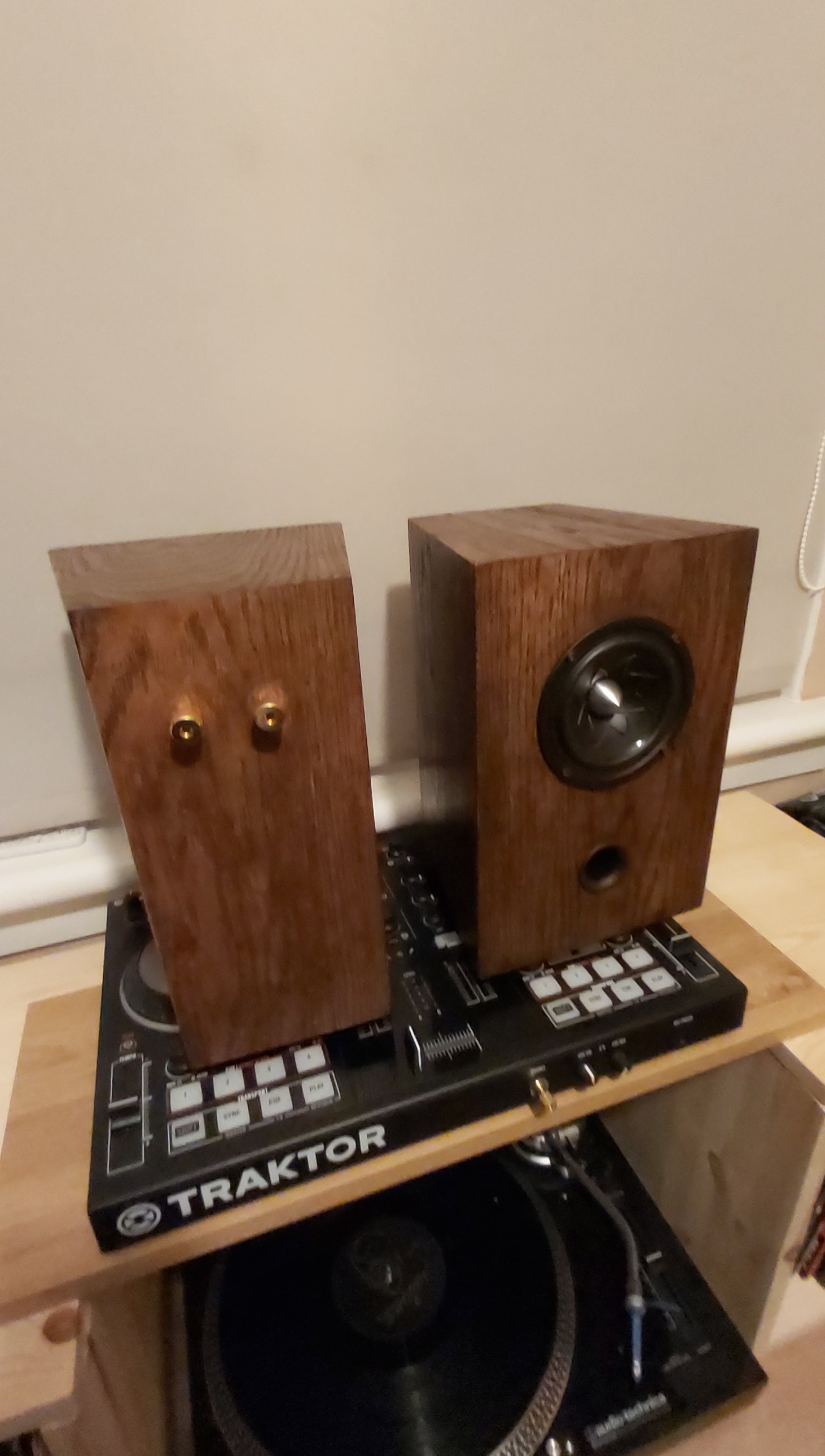

So thanks to all for the advice. Plywood was prohibitively expensive.
After VAT and delivery a single sheet of oak ply was going to run me £130.
In the end I used 18mm MDF (as I had lots) and finished them with an oak veneer. I know I said I wanted to avoid veneer but I sued the iron on method this time rather than the contact adhesive method and feel I got a better result.
This is what I ended up making for him (also never used the Mark Audio drivers as I went for a darker finish).

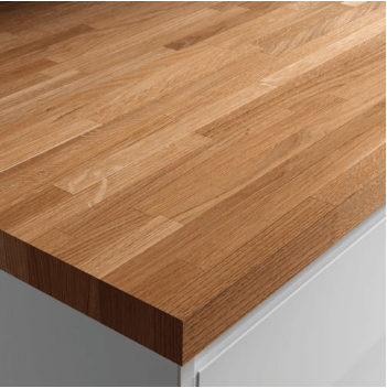

I've read the whole thread and though it's informative I don't get a clear consensus about the various forms of solid wood. I have some left over kitchen worktop 26mm thick, which I believe is oak. It's been doing nothing for several years and kept indoors so it's perfectly dry. I'd like to use it for a pair of 2 way speakers.
Can anyone assess how suitable it would be for a speaker cabinet? Pic attached - I'm sure this is a familiar product.

Andy, butcher block which is what you want, as long as the glue joints are solid. How thick is it?

Yep, seems very stable, this stuff I used has small sections with "teeth" attaching one piece to the next.I've read the whole thread and though it's informative I don't get a clear consensus about the various forms of solid wood. I have some left over kitchen worktop 26mm thick, which I believe is oak. It's been doing nothing for several years and kept indoors so it's perfectly dry. I'd like to use it for a pair of 2 way speakers.
