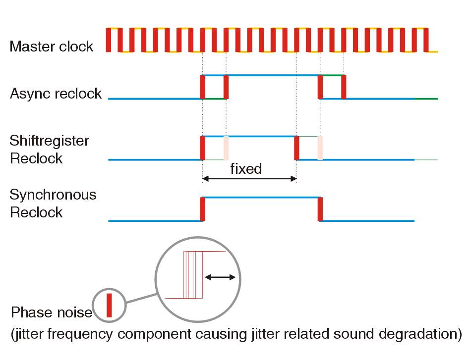

Are you sure about this? somehow I get doubts about this statement. What about digital audio source (CD transport) timing jitter? the relatively long SPDIF interlink and the resulting interference between data and sync components in the SPDIF signal? CS8412 on-chip crosstalk between DATA and WS / BCK?
You are absolutely correct about the phase deviations introduced by asynchronous reclocking. Sure I noticed these phase deviations during measurements, they are clearly visible (illustrated by oscillograms I posted earlier on this thread)
But tests I conducted showed that the low amplitude phase noise causes most problems. This was verified by both measurements and listening tests. It turns out that these very small phase deviations disrupt feedback loops in analog stages (DAC, pre-amplifier, power amplifier). Simple comparison tests between two power amps of the same type, one with high negative feedback, the other with significant lower feedback showed that the one with highest feedback produced sound degradation very similar to increased phase noise.
So I think that the jitter related sound degradation is primarily caused by disruption of analog circuits / feedback loops , rather than changing absolute sample timing.
I added a drawing for explanation:
The master clock is on top, the red colour indicates phase noise, random jitter in the (almost zero) to say 1000ps range, depending on master clock oscillator jitter.
First is the signal produced by an asynchronous reclocker, causing the phase deviations you correctly described. Note that clock signal phase only "jumps" between fixed points rather than fluctuating randomly.
Superimposed on these fixed phase deviations (determined by master clock positive clock transition), is the actual phase noise, also present on the master clock (marked red). It's very likely this phase noise is further amplified by imperfections in the reclock circuit.
Next is the shiftregister reclocker (basically a digital one-shot circuit), due to the forced reset, the majority of master clock transients are detected without causing a phase deviation. This results in sporadic phase fluctuations (thin green coloured pulse). This comes very close to the ideal, a synchronously reclocked signal, indicated at the bottom.
But all clock signals, no matter how they are generated, still contain the master clock phase noise and therefore will degrade sound quality. I magnified this part to illustrate this is random phase noise.
So in my opinion, the most important is very low master clock jitter. Digital audio interface receivers based on PLL circuits do produce quite a lot of phase noise, on all signals (including framesync), values between approx. 250 and 1000 ps are quite common in practical circuits with practical interface cable lengths. Reclockers can significantly reduce this phase noise.
Then there is the very tricky (on-chip) crosstalk between DATA and timing signals, making it quite problematic to obtain both DATA and low jitter timing signals from one chip.
The synchronous reclocker is theoretically best, but often difficult to realize. The shiftregister reclocker will lock on high jitter signals, synchronize the output clock transients with the master clock, adding mainly the master clock phase noise, independent of the digital sound source phase noise. It's a simple circuit, not expensive, why not use it.
I will rephrase the remark I made for clarity:
The USB interface has a unique shiftregister reclocker that provides extreme low phase noise (frequency components that result in sound quality degradation), regardless of digital audio source jitter.

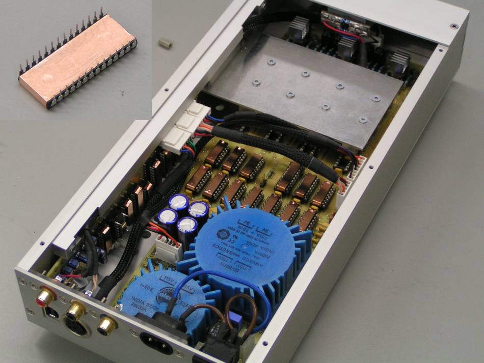

The copper foil mod

There is a new mod, It was a result of trying to reduce electromagnetic interference. I used self-adhesive copper foil for screening the ICs. I wrapped it around all ICs, and put small pieces on top of SMD ICs. The sheets are not grounded. The idea is to turn HF energy into Eddy currents (copper foil), converting part of it into heat.
Well it seems to work quite well, the DI DACs are now less sensitive to external EMC sources like HF tube-lighting, WLAN, DECT and GSM for example (these could cause increase of jitter). Also chip to chip crosstalk has been reduced. Power supply decoupling seems to reach its limits at some point, as the electromagnetic interference from the ICs directly affects the components located close to it.
The timing signal transients look slightly cleaner on the oscilloscope now. The sound is slightly more "analogue", clearer, and very relaxing.
The self-adhesive copper tape isn't expensive, so it's worth a try. The only "problem" is that it will take some time and patience to perform this mod.
I added a photograph to illustrate this mod. The foil is wrapped around the chip (bottom, one side and top of the chip). The copper foil tape must be firmly pressed against the chip surface in order to guarantee good fixation. I used copper foil strips of approx. 5.5mm (0.2") wide, care should be taken to avoid short circuit with the IC pins.
I used some car wax to prevent oxidation of the copper foil, another option is to use tinned copper foil.

Hi John,
I am interested by your copper foil mod.
Are the thickness and dimensions of the copper important do you think? Would a ferrite tape be more effective ? Something like this perhaps http://kerafol.de/jml/pdfdocs/ferrit/f96_e.pdf. What about wrapping the IC in copper tape (connected to the ground plane) and then ferrite tape over the top ? I wonder if you have compared your mod with and without grounding the foil ?

Shielding of chips with copper foil helps and is easy to do.

I use 3M addresive copper foil - EMI shielding tape.
http://products3.3m.com/catalog/us/...trical_3_0/command_AbcPageHandler/output_html
It works very well. Sound became even better, more natural.
I tried only on all ICs on USB module of DI16 DAC.
I didnt grounding foil, because it seems makes more problems.
