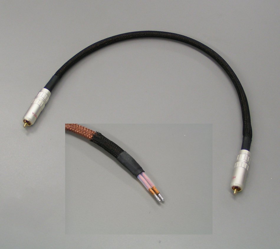

I now use rather extreme semi-balanced RCA interlinks (approx. 2.5mm wire diameter). They have 72 thin magnetically coupled lacquered copper wires for each conductor. Primary insulation is 3mm diameter PTFE (Teflon) tube. It has a copper braided screen. I use exactly the same wire construction for both signal and ground. The screen is connected to GND on one side only (the side with lowest impedance). I added a picture of these home-made interlinks.
They provide very high resolution / clarity, best tonal balance, and lowest noise levels so far.
I will try this semi-balanced technique. Thanks.

RCA interlinks
Hi anatech,
Okay. You do know what you just said, right? Remember, these are copper wires.
With magnetically coupled I mean that the stranded wires are twisted together (illustrated by photograph), similar to twisted pair network cable, perhaps I should have written electromagnetically coupled. My mistake.
The objective of this interlink construction is to achieve high resolution by reducing noise / losses.
I use a passive resistive volume control, so in this particular case, the (RCA) interlink quality becomes quite important. The gained advantage is eliminating pre-amplifier distortion.

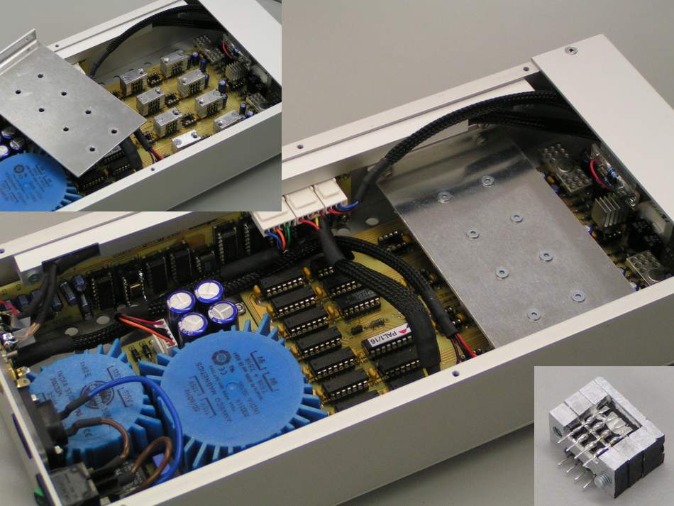

DI 8*3 / 8*4 heatsink construction

I added a photograph of my 8 * 3 heatsink construction, I use smaller aluminum blocks and a thin 2mm thick top plate in order to reduce heat accumulation. The top plate dissipates heat to the aluminum housing.
Will try to test things tomorrow...
I hope you don't plan to solder the TDA1543 assemblies directly into the PCB. You need some play for compensating mechanical tolerances, and perhaps you need to remove some of the TDA1543 modules during testing.

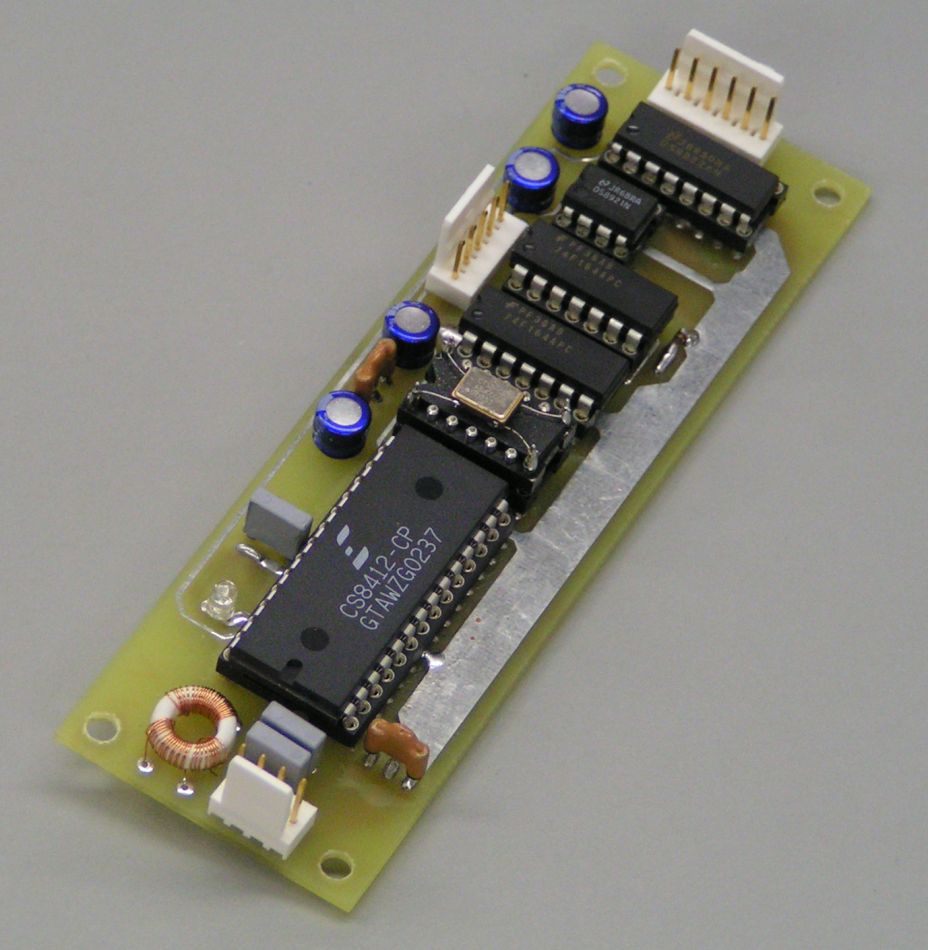

Hi all,
Finally the SPDIF to (D)I2S interface with shiftregister reclocker is operational.
I added a photograph of the prototype.
This module connects SPDIF sources (CD / DVD player, satellite receiver) to DI 8M or DI 16. This way, a CDPROII can also be connected through the on-board SPDIF output.
The Crystal audio receiver converts the input signal to Philips format 64 BCK/WS. I used the CS8412 for now, The CS8414 can also be used (adapter socket).
It has the same shiftregister reclocker as the USBDI2S module. Provided the SPDIF source outputs the data correctly, sound quality should be identical to the USBDI2S module. SPDIF jitter is irrelevant, as long as the CS8412 / CS8414 PLL can get a good lock.
The master clock oscillator is the 48 MHz <1ps jitter clock. The crystal oscillator module has a SMD decoupling cap soldered directly to the power supply pads, and it's suspended over a small rubber sheet by means of 4 thin wires (to reduce the effect of external mechanical resonances).

Hi tubee,
how is the sound of the spdif connection compared to the usb to I2S?
As far as I have been able to test it, they sound exactly the same by direct comparison (toggling between USB and SPDIF). I used a fully modded DI 8M for testing. If there was even the slightest difference in sound quality, the DI 8M would reveal it.
This is good news as it shows that it's possible to achieve identical sound quality from two completely different digital sound sources (I used an old 500 MHz iMac for USB, and a very old Sony CD player with SPDIF coax output). The test CD was ripped and imported in iTunes, then placed in the Sony transport.
The tracks were started almost simultaneous, the sources were toggled by pulling the USB plug (this causes automatically switching to the SPDIF source). If there was a difference, this direct comparison of exactly the same tracks would show it.
Verification of BCK jitter showed the same clean very low jitter signal for both digital input sources. The BCK signal from the CS8412 (before reclocking) clearly showed jitter (approx. 250ps rms).
Hi -ecdesigns-
Thanks for your tips (Post #1689)
As usual, very nice solution for your 8*3DAC.
My original plan was to place the main DI16PCB on the vertical axis to benefit from convective air cooling. I will try that if the horizontal position causes excessive heating. I think my construction is tight but will always fear accidental displacement of the towers and catastrophic short 🙁 if horizontally placed.
I did not have cement/heat compound which would have helped to this problem and also to eventually put a folded heatsink on top of the present one. I will figure out a way to improve it if it is required.

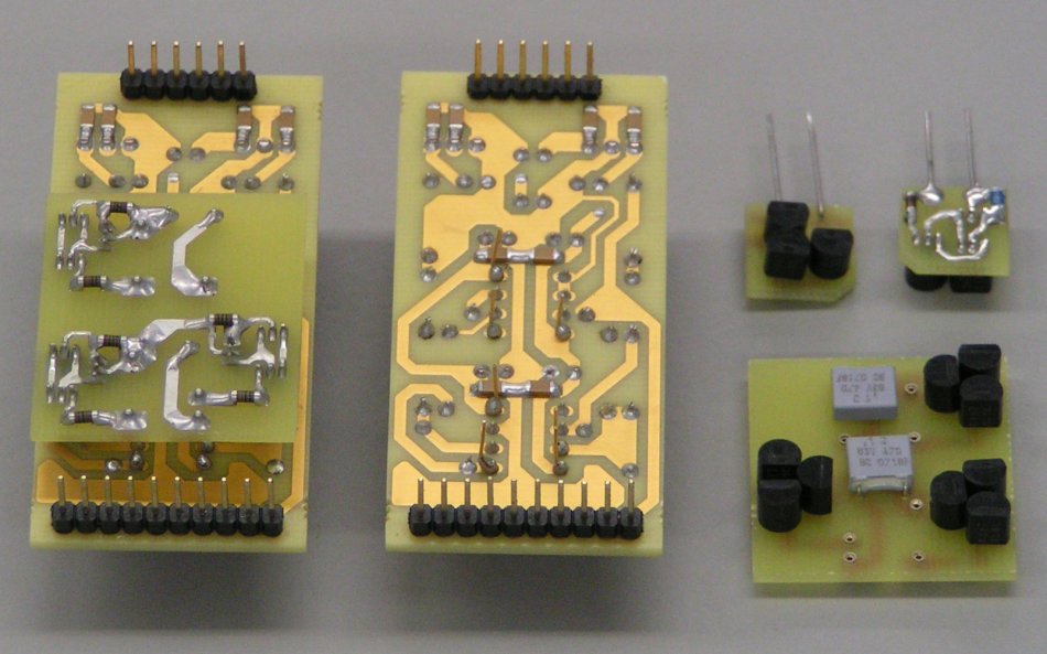

I added a photograph of these new current source modules,
The IVDIF module on the left has the constant current source piggyback module installed. The module contains 3 precision current sources plus series resistor, and two decoupling capacitors (placed between +15V and -15V). I used low profile IC sockets to enable easy module removal.
The IVDIF module in the centre shows the gold-plated pins I soldered directly to the OP-amp sockets.
The piggyback module component side (bottom right), the current sources consist of 3 JFETs and two resistors. They provide approx. 3mA each.
The smaller single current source modules (top right) can be used for the DI 16, and tubediff input stage. I already experimented with a high voltage version for the cathode follower in the tubediff module, 4 JFETs, 2 resistors and a high-voltage power MOSFET. The result was even lower distortion in the tubedif amp.
You could use TO-220 silicone insulators and use them for both, heat transfer and insulation between heatsink and IC pins.

Hi -ecdesigns-
These heatsinks parts were CNC milled, but it was still quite difficult to assemble them.
You tell me!
(I sadly know how dificult is to put that together)
About testing, one vital part is still missing.
I asume you were talking about the current sources...I thought you were talking about my project...
Very nice little circuit for the lazy and ignorant amongst us 😀
How about using silicone glue between IC pins and heatsinks? Will this degrade sound?

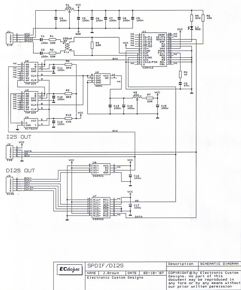

Hi anbello,
Hi -ecdesigns-
i would like to see the schematics of the spdif receiver in Post #1690,
or at least to know in which mode is set the cs8412/14 (m0, m1, m2).
I added the schematic of the SPDIF to (D)I2S converter prototype.
CS8412 / CS8414 is put in the following mode:
Normal audio port mode (M3, pin17 = GND)
OUT, L/R, I2S Compatible. M0, pin23 = GND, M1, pin24 = VCC, M2, pin18 = GND)
Short explanation of schematic diagram:
SPDIF enters at J1 pin 3,4, and is fed to the CS8412 through a pulse transformer. A small ring core can be used for this, each winding should have approx. 225uH. L1 indicates PLL lock. CS8412/14 PLL jitter isn't critical.
Both SDATA, pin26 and FSYNC (WS) pin11 are available on J2 (I2S out), and converted to differential signals by U7 for the DI2S interface J3.
SCK (BCK) pin12 enters the shiftregister reclocker first (U2, U3, U4). The shiftregister reclocker is clocked by a very low jitter (<1ps) 48 MHz master clock (U5).
The reclocked BCK signal is available at U2, QB, pin4. It's then fed to the I2S interface, and converted to DI2S by U6.
I used a separate chip (U6) for BCK in order to reduce crosstalk. additional jitter problems can be caused by the DATA signal interfering (crosstalk) with BCK. I used miniature coax wire from Nexans for the I2S connections between modules.
