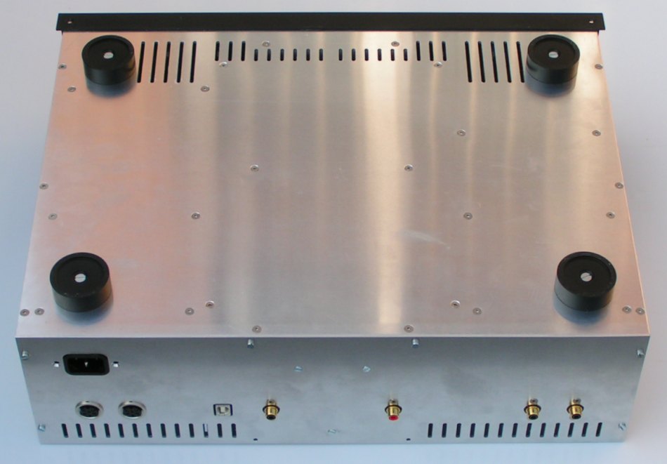

Looks like it's time to get the PCB's manufactured. I will post some more photographs of the octal D-I DAC, since I have made some more modifications to the housing.
The first photograph shows the location of various ventilation slots. I have to add some more in the top cover.

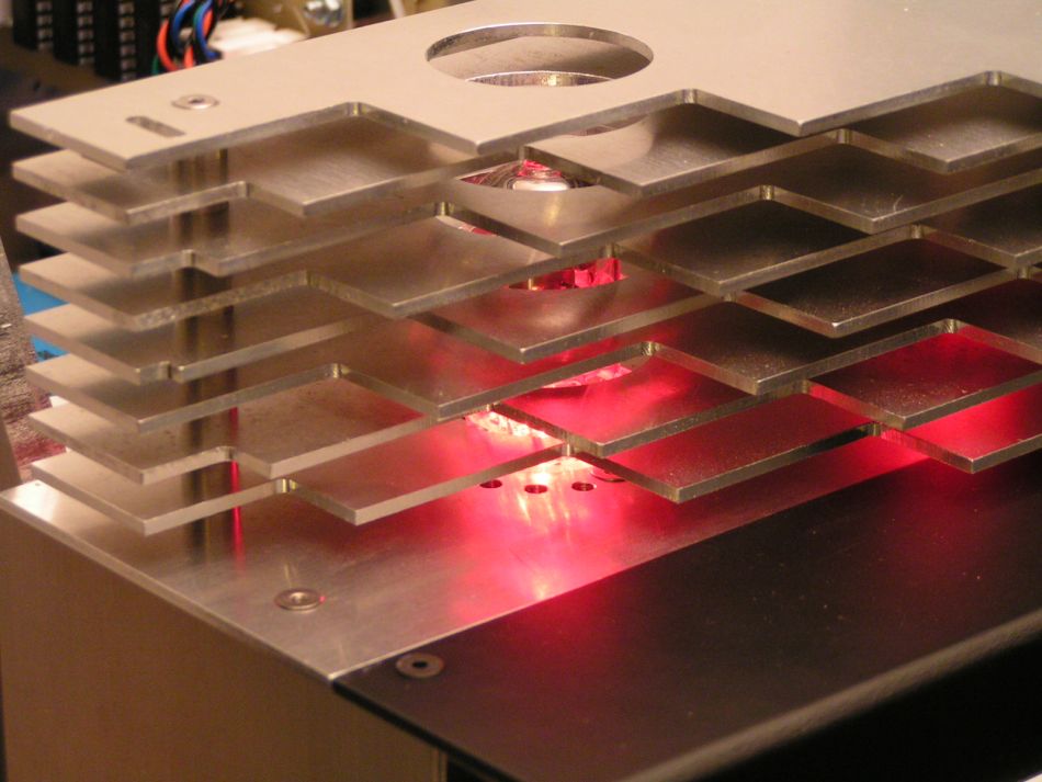

Hi all,
Another photograph, it shows the modified tube grille, the hexagonal spacers have been replaced by round precision turned aluminum spacers. More ventilation slots are added around the tube sockets and above the OPA627 OP-amps (these are located below the center of the tube cover plate). The slot on the top left is added to enable easy access to the cover's front screws. I also used countersunk screws on the top grille plate.

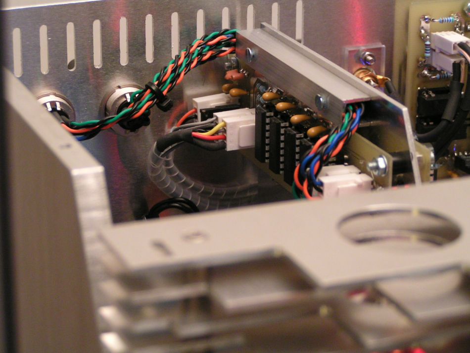

hi all,
Another picture showing the completed wiring of both I2S inputs. I used colour coded twisted pairs for this. Blue/black = BCK, orange/black = WS, green/black = DATA. The cables are routed trough a small aluminum cover. The connectors used are 6-way DIN connectors with a screw locking mechanism. Both connector and socket are made of aluminum with a mat-chrome finish, the terminals are gold plated of course.

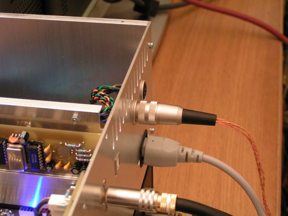

Hi all,
Next photograph shows the I2S DIN connector and the twisted pair stranded wire I2S interlink. The RCA connectors have a clamping mechanism, the RCA interlink cables are approx. 40cm long. The DAC RCA sockets are mounted on transparent 3mm polycarbonate plates to isolate them from frame ground.

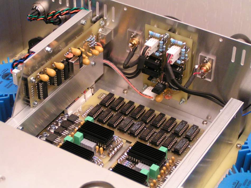

- The TDA1541A DAC module PCB design is modified in order to use 1...3.3uF capacitors for MSB decoupling. There is enough room to mount a standard 24pin size heatsink on the TDA1541A.
- The analog mainboard PCB design is modified so now it includes the 3 BCK (UHS) buffers.
- The main power supply PCB design is modified, it now directly feeds the system controller (5V) and a modification is made to switch-off the tube status LED's if desired.
I also spend a lot of time checking the layouts, especially drill diameters and silkscreen. If all this is completed, the PCB's can be manufactured.

I added a photograph showing the green 3.3uF capacitors for decoupling MSB, the 24 pin size heatsinks and the high-capacity tantalium power supply decoupling cap's used in the USB interface.

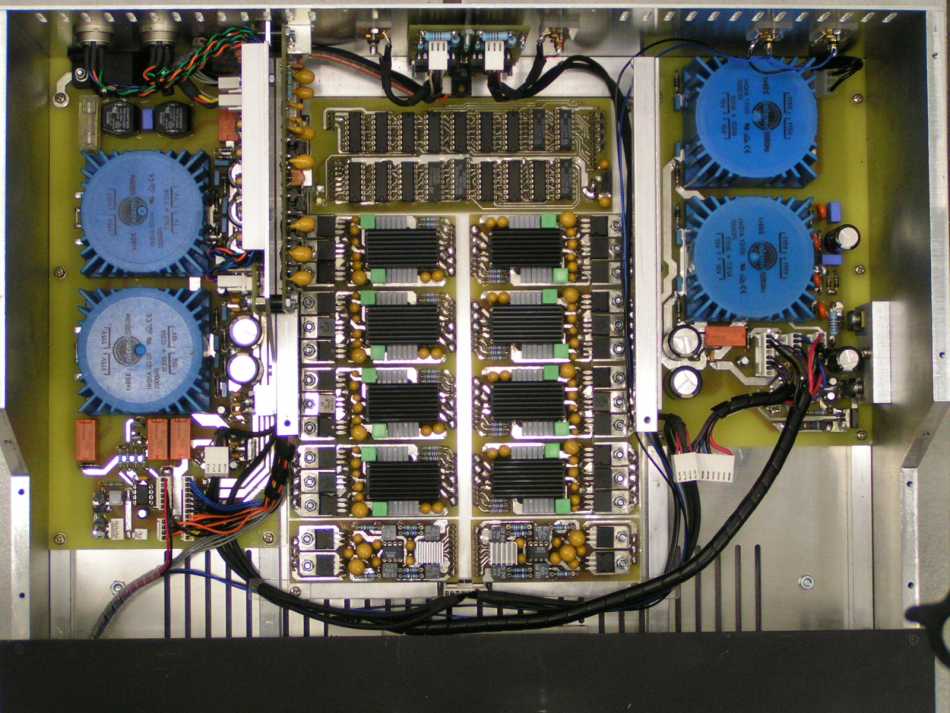

octal D-I DAC with passive I/V
Hi MGH,
Thanks for your reply [post#995-996]
First of all the decoupling cap's were all increased in value on the majority of modules. I added a picture of this modification. The sound is very smooth now, the transparancy and low level detail have improved, noise levels have gone down too. This could be tested with a track containing a low level sinewave, slowly dissapearing in the noise floor.
But there is much more to come,
The op-amp I/V converters use 4 expensive OPA627's, so I decided to try passive I/V setups using non-inductive 15 Ohm copper wire resistors. Dual resistors were "merged" in a single winding because I use a differential setup. Then I increased the gain of the existing differential amplifiers. The enhancement in perceived sound quality was much more than I had expected.
I also tested both metal film and carbon resistors but they didn't even come close to the copper wire resistor. The copper wire resistor has zero inductance due to a twisted-pair mobius loop construction, the copper wire is much thicker than the metal or carbon film, this ensures very low noise.
I will post differential passive I/V schematic diagrams and copper wire resistor construction method's later.
