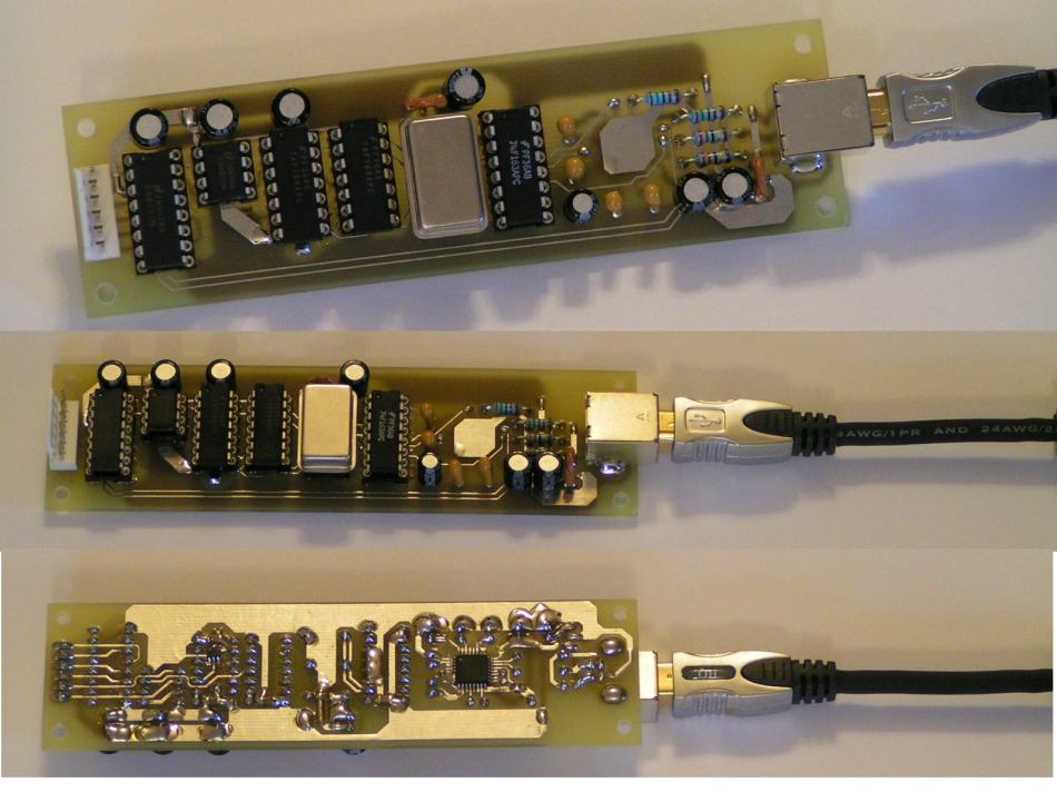

USB to I2S module completed
Hi all,
Project update,
Finally, the USB to I2S module is ready. It's a compact module only measuring 128 X 34 X 15 mm. It uses the PCM2706, is bus powered and has extensive power supply filtering`. On the right is the USB-B connector. The PCM2706 is on the solder side, there is a ground plane on each side. The 5V bus power supply is connected to the PCM2706, then it is pre-filtered with a ferrite bead filter and some electrolytic capacitors, this is the VCC supply for both reclocker and differential output buffers (DS8922 and DS8921). The crystal oscillator module has a addittional ferrite bead filter and capacitors. It's output is synchronously divided by 4 to obtain the PCM2706 12 MHz clock signal. It also directly drives a fully synchronous shiftregister reclocker that removes continuous jitter. Double traces were used to distribute the various clock signals, this was done to lower trace inductance. Large ground planes were used to reduce interference. The differential I2S outputs (white connector) are on the left. BCK has a dedicated differential buffer, both WS and DATA share one dual differential buffer.
Solder side, on the right is the PCM2706 SMD chip, it has 32 pin's. In the center, the double traces can be seen. On the left there is a UHS inverter in a 5 pin SOT23 housing, it is used for the digital one-shot circuitry. Ceramic SMD capacitors are soldered on this side for power supply decoupling too.
This module can also be used separately, it just needs a differental receiver on the DAC side. By using different drivers, isolation transformers can be left out.
To get optimal performance, a low jitter clock module can be selected as there is quite some difference in clock jitter between various modules. These differences can be clearly heared with this interface.
Now there are only two more printed circuit boards left to be designed, the I2S input selector and the analog mode switch.
