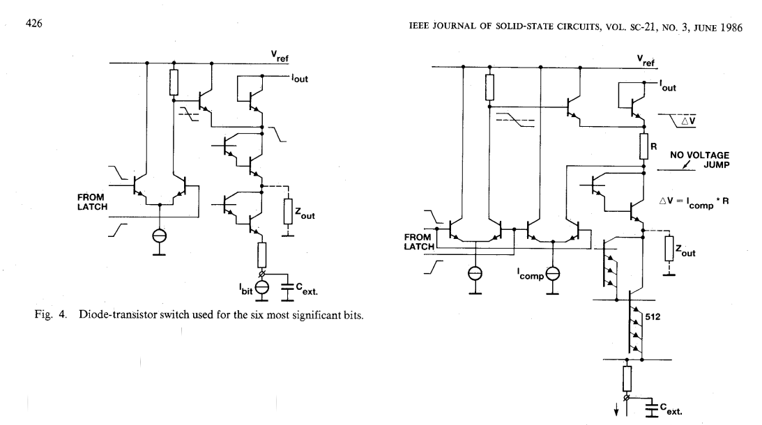

To illustrate my point:
In order to turn off the Bitswitch the base must be pulled down to at least appx. DGND/AGND DC level. I suspect AGND.
This means the emitters of the differential driver circuit of the switch must be at a negative potential.
Level translation from the latches in PECL is easy, so we just need a bias source for the tail currents of all the CMLogic.
It's not -15V, that would be insanity, so it must be -5V. Seeing -5V is not referenced ANYWHERE ELSE in the circuitry, logic dictates that it feeds the tail current sources of the 32 total bitswitch driver circuits.
I may be totally wrong, mind you, it's just my best logic.

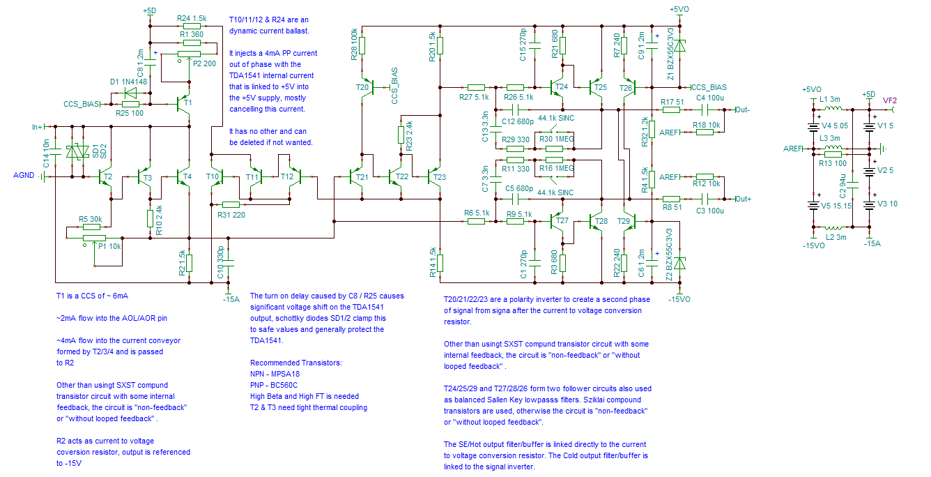

So, that's the current drawing board:
Clever. Hopefully it will be stable with only 10n at T3 emitter, microcap was showing that 10R + 10n works well. BTW it's important to check transients with a small time step on the spice settings, such as 10ps and fast risetime square wave (1ns).
(Am I being overly cautious? What is the worst case TDA1541A slew rate?)

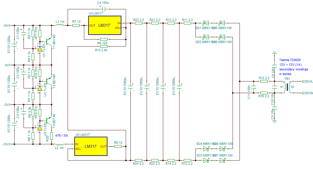

When I started - being naiv as I was then - I used the most elaborate implements I could find: multi stage Jung's Super Regulators e.t.c.
After many years of building and testing, I settled for a triplet of simple LM317's (+5, -5, -15) and passive filtering prior & post regulator - with excelllent & sonically consistent results.

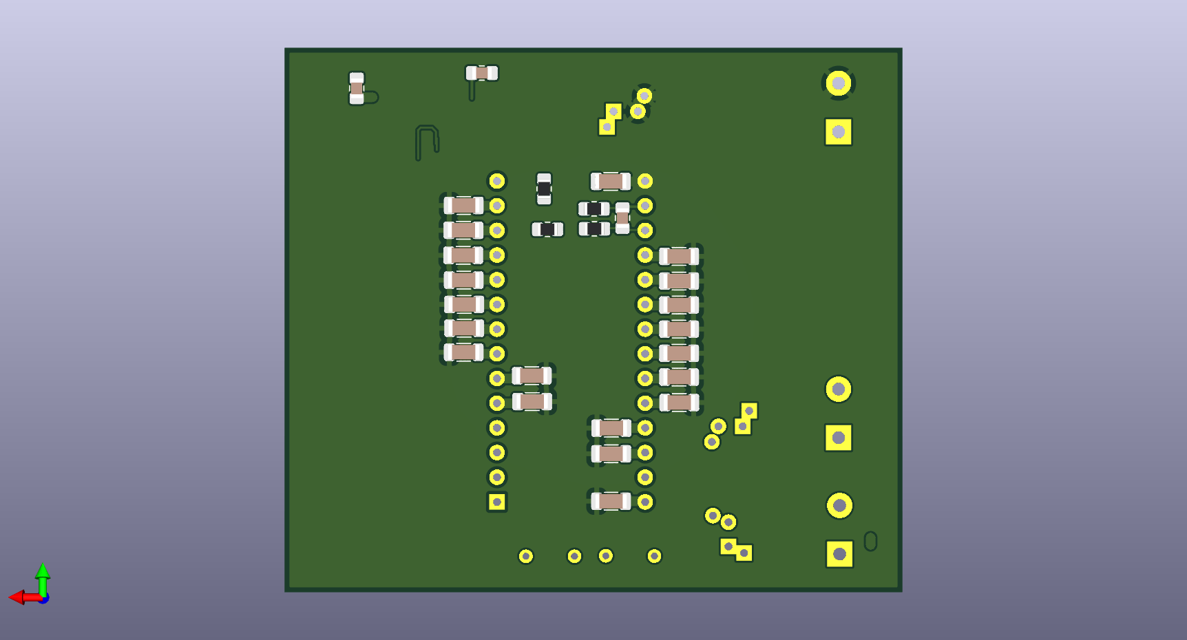

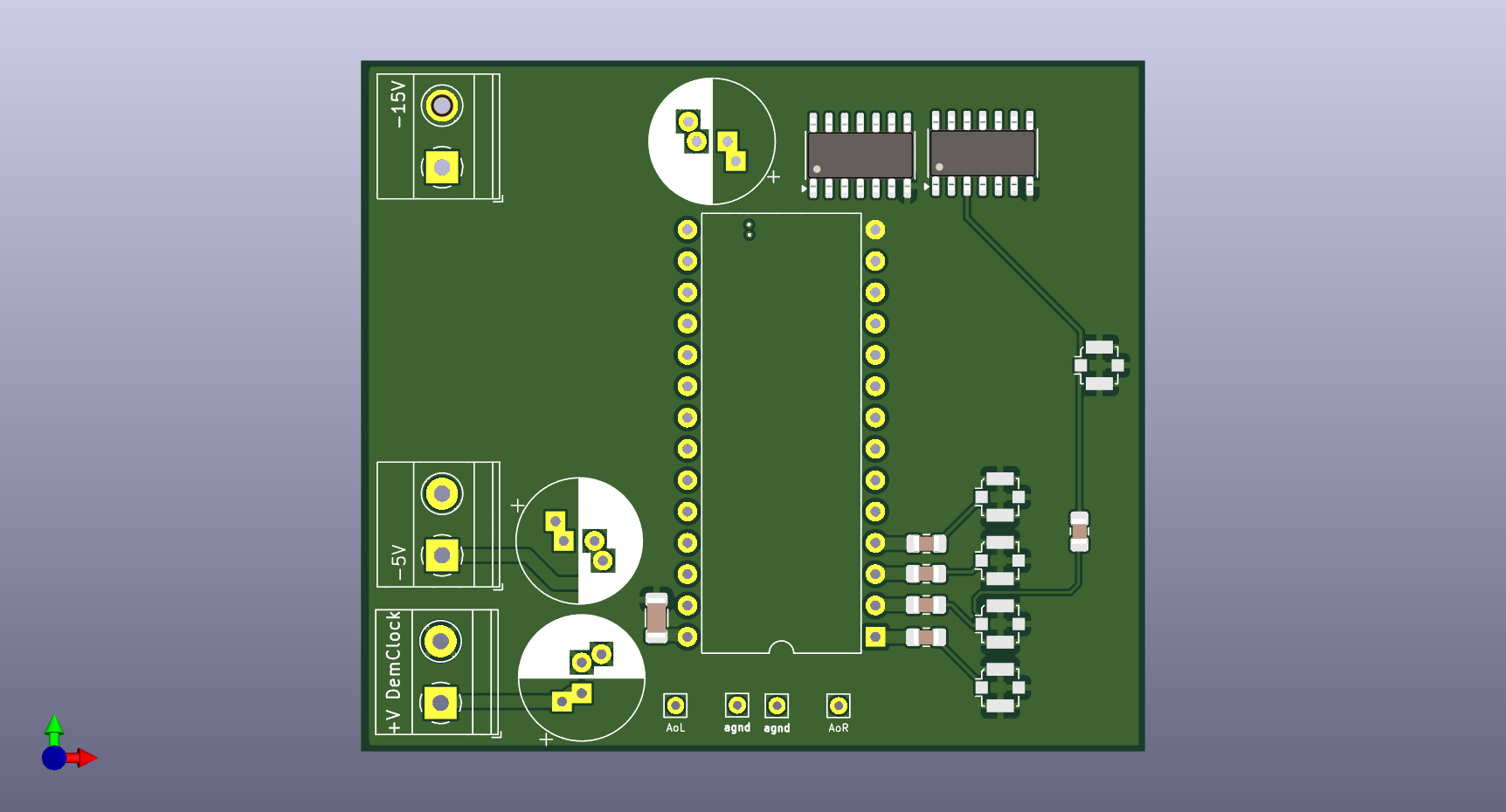

Well, core pcb corrected by all the inputs of Thor, but DEM sync layouting to be finished newt nigth, certainly external power supply for it for space area reason! Goal : everyone free to use what he has at hand already for the front end and I/V. It is 6 layers with Thorsten's layout from digital DGND to the top, so very clean about crosstalks return current paths.
layer 1 : DGND (pin14), layer 2 : +5V (pin 28: lythic decoupled to DGND layer, two C0Gs for dgnd decoupling and -15V decoupling), layer 3 : -15V (PS-pin15); layer 4 : AGND (pin5) ; layer 5 : -5V (pin26) ; layer 6 :-15V (14 DEM decoupling + decouplings of most pins towards -15V- pin 15).
It is easy to input any power supply mode : the standalone voltage source, the classic way with different secondaries
No power supply yet for the DEM sync,, I like the idea it comes from a secondary not took on the main 3 rails standalone traffo, as we do need also some +5V, +3V, etc for the digital front end !
Of course a much bigger pcb can be made, copping with all the PS and analog end and digital front end from T. ; but I think it is more prudent to begin here verroboard or wait for the GO after the proof of concept.
I am working on a less expensive to print 4 layers, certainly with 3D wires outputs like a tube amp for the current return paths not to be too much crosstalked (can be matched impedance plugs like MV Audio made on his site, etc )
On the 2 layers way, it will be hard to beat the Pedja Rogic excellent ground star layout that isolate cleverly high speed from analogs signals

After many years of building and testing, I settled for a triplet of simple LM317's (+5, -5, -15) and passive filtering prior & post regulator - with excelllent & sonically consistent results.Well my own experience is what we use on the passive filtering affects sound greatly & I prefer using as little a value as possible for post filtering, infact if the regs are stable & low noise enough no post filtering at all.
Is not useful IMNSHO. It is counter productive. Use a single 20V supply, shunt regulated. Best on board. I recommend this:
It is an amalgam of things that were done for late prototypes of an AMR CD-77 MK II and later work on TDA1541 DAC's based on the PCB's of Thomas's Kit's.
DEM Sync PSU depends on DEM sync IC's used. Signal conditioning, DEM reclock and IIS2SIM circuitry should ideally share one PSU (multiple regulators for different voltages required) and one solid ground plane linked to TDA1541 DGND with really low impedance (e.g. multiple RG-316 coax shields). All current from signal conditioning flows back to this supply anyway, so signal conditioning belongs away from TDA1541 and near the source, as does DEM reclock.
The signals for TDA1541 can run on Coax and are slew rate limited as well as limited level, so we can ignore the impedance mismatch for normal length, any connection length of < 64cm is not subject to transmission line behaviour for signals limited to 32nS slew rate.
Early versions of the CD-77 used 2 layers and star ground. Later went 4-Layer and planes, MUCH BETTER.
2 layers is simply obsolete.
