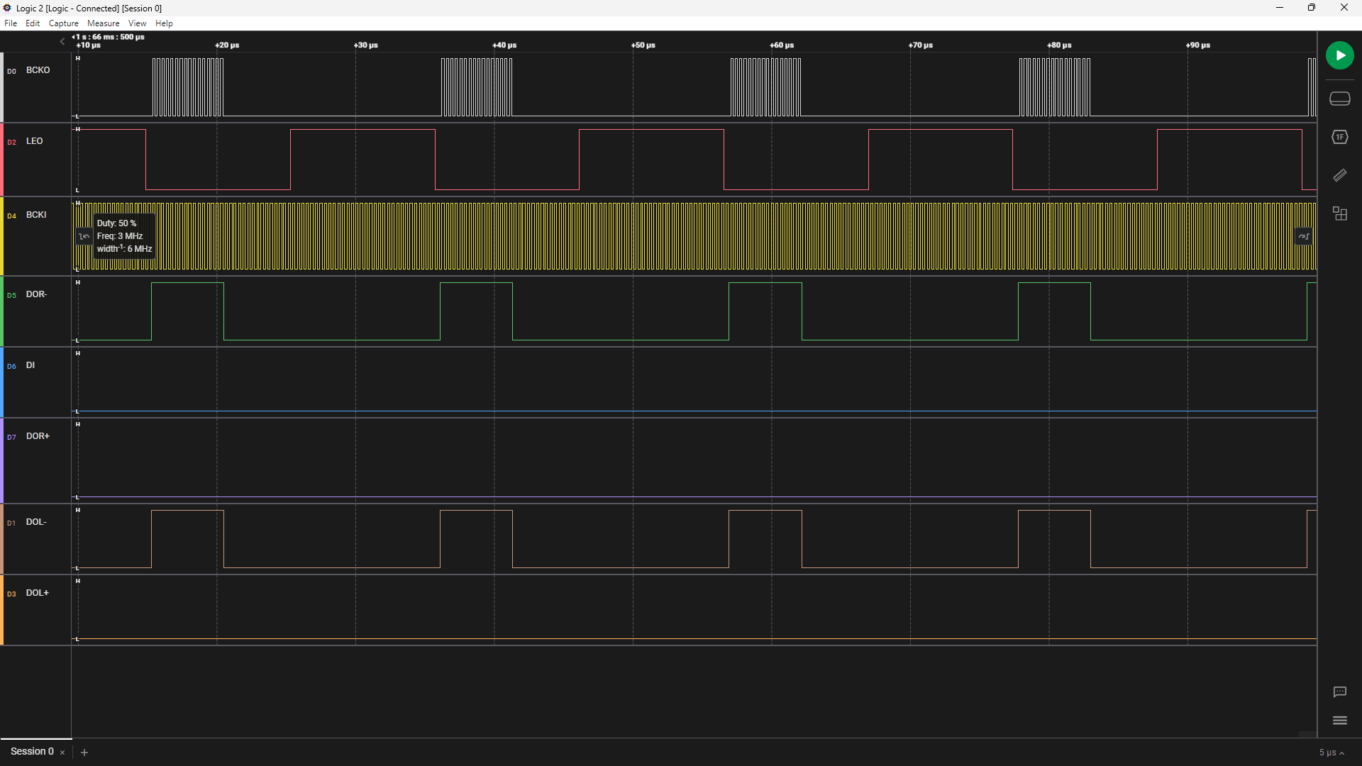

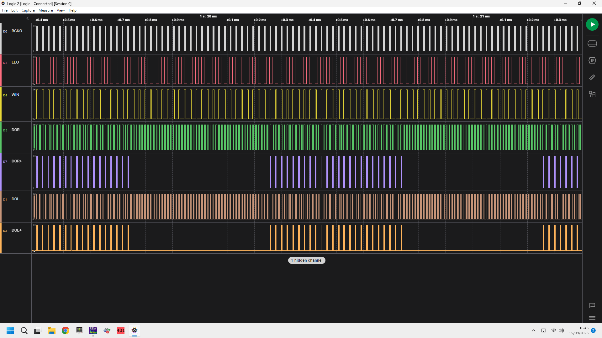

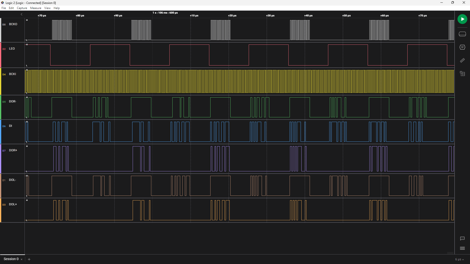

Here is an capture of an 1 khz signal at the input , signals taken at the logic board output
channel from top to bottom :
DOL+
DOR-
LEO
DOL+
WIN
DOL-
unuse
BCKO
Timing looks good, also minus is full and plus has a value (L+R being the same), LE looks good as well, maybe it would be even better if the unused bits get suppressed. Can you identify the content of the data lines? The analyzer should be able to display DEC values. Maybe compare with the data that comes out of the DIR9001 so that you can see if MSB is handled correctly?

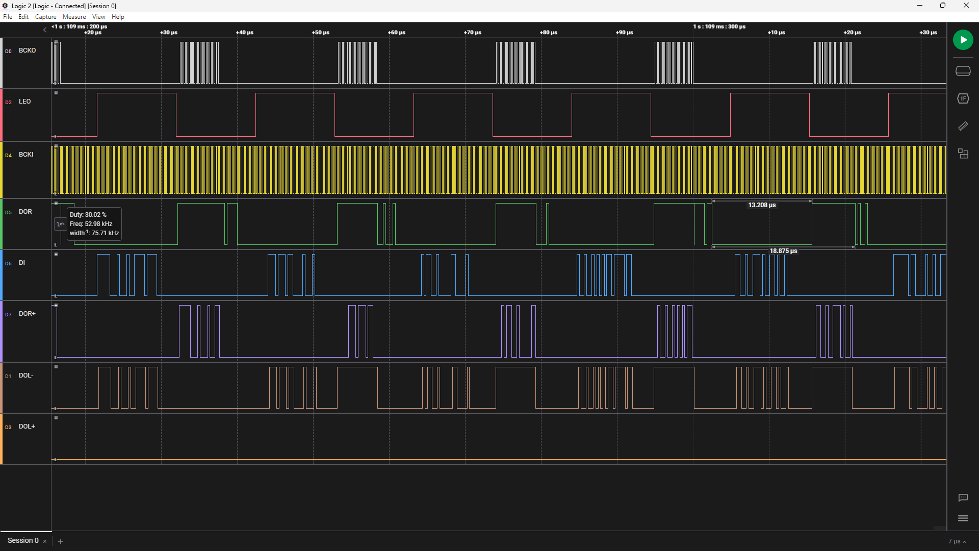

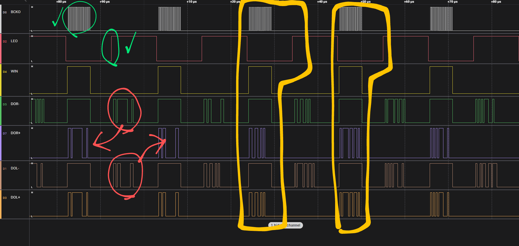

I marked red where data gets moved around. Green shows the timing: only the yellow chunks get converted. Does that correspondent with John's explanations?

I dont even knew there were unused bits !!!
I am not very pratical with this sofware , will try to find out for the decimal values
I will try to spot the data out of the dir9001 and bring them to the capture
the software has three analyser , Async Serial / I2C / SPI

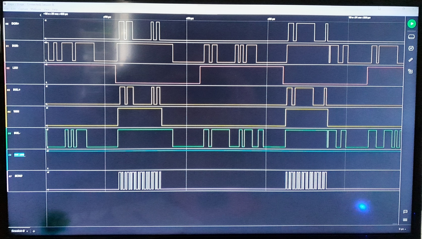

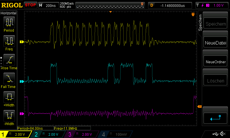

As I said: you have identical data in R and L, so it's impossible what get's copied to where - please play zero in one channel so that you can identify the content. Here is an example of input to my TDA1541A in simultaneous mode (one channel shown). You can see MSB is high. Purple is LE, yellow is BCK.

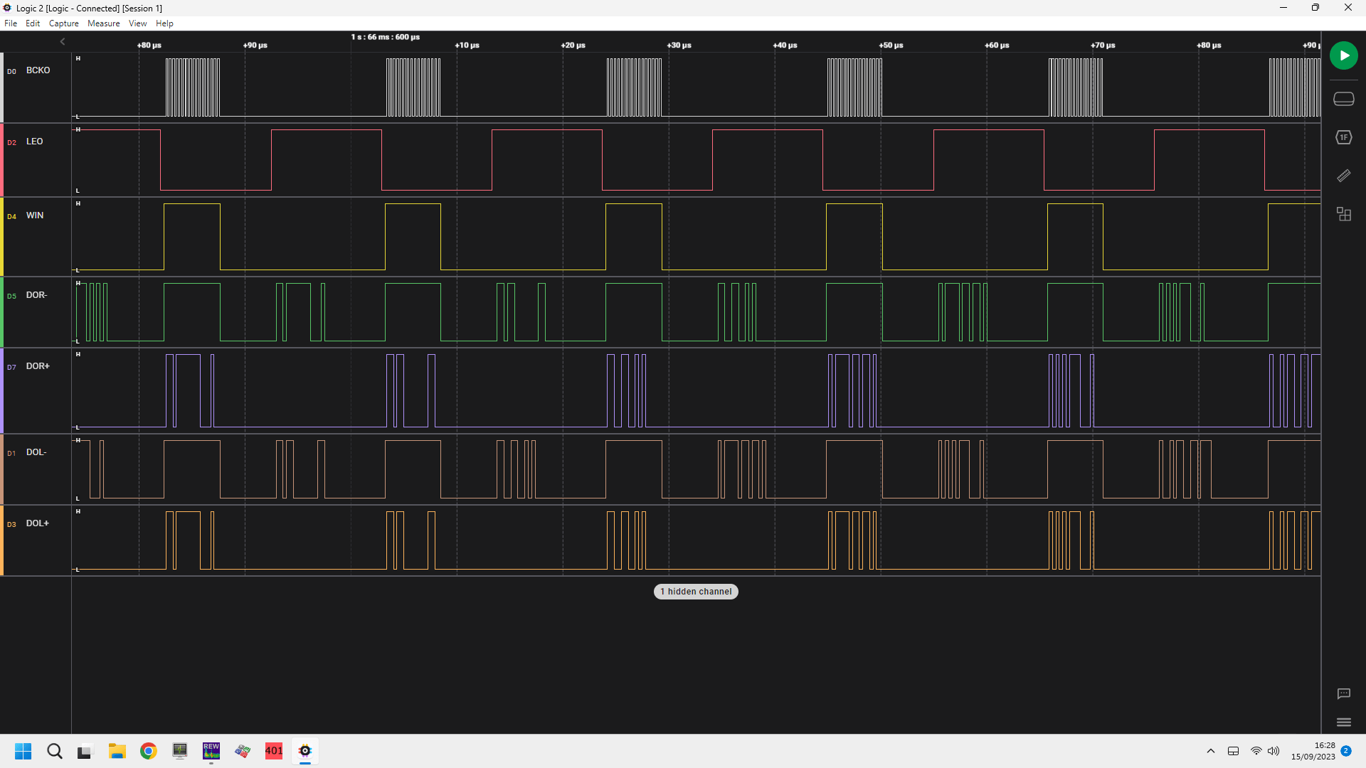

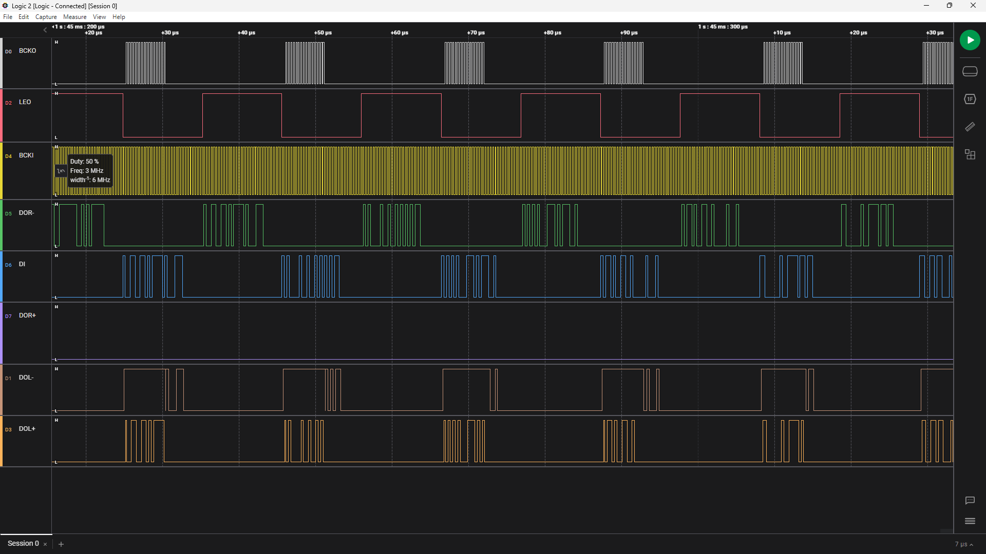

It seems MSB gets copied into DOL+, LSB into DOL- in the first picture, and the right channel is empty. In the second picture MSB moves into DOR+, LSB into DOR- and left channel is empty.
Is that how it's supposed to work...? Please compare with Johns explanation. I thought if MSB of channel X is high the data should be copied to DOX+, else to DOX-
But of course without MSB as John explained. And if you use a 16bit source the LSB should always be LOW after the 17bit glue logic, no?
Or is it so that if MSB is high DO- should be completely high, and if MSB is low DO+ should be completely empty...?
